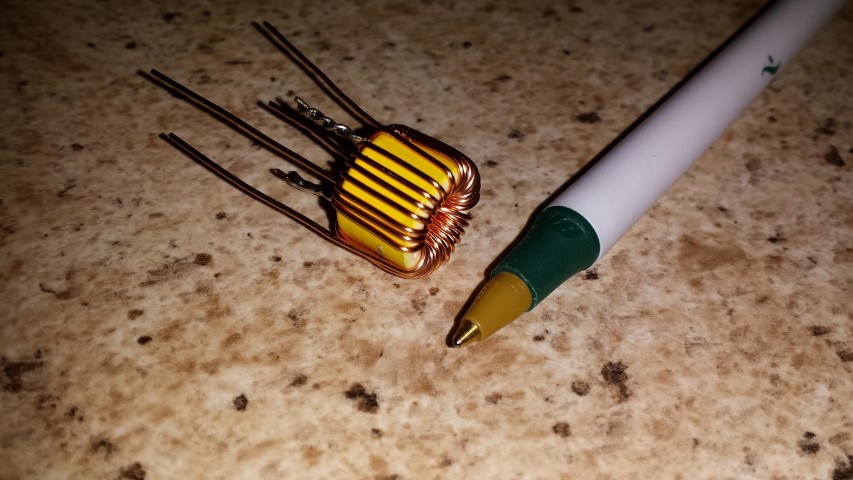

Use a FERRITE filter toroid salvaged from old CRT. Wind Primary with 12+12Turns, Secondary with 15+15T. Use 4 high speed diodes.
Just connect the feedback resistor to the positive rail output, the negative rail should follow. Use a 1K load resistor for each rail or 1K resistor + LED for dummy load.
Don't use an iron powder (yellow) toroid for the transformer, but you can use it for post-filtering after the output capacitors, followed by another pair of capacitors.
The yellow one in the photo has a 6+6 CT primary and 8+8 CT secondary. Haven't tried it yet. Load would be a pair of MC33078 here.

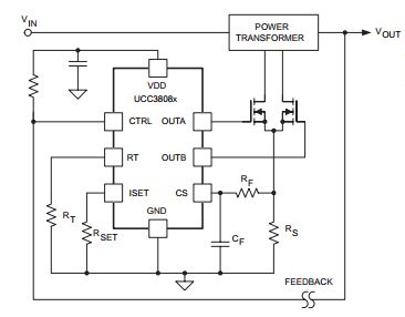

EWorkshop - Did you take a look at the UCC28085 data sheet in the first post? Seems like it would function much like one might use a TL494.
Here's the example schematic from it.

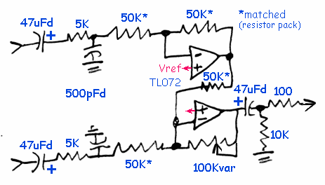

> balanced audio signal (from headunit) to unbalanced (to amplifiers).
These power-amps surely do not need more than 2Vrms of signal drive? So to slam them you only need 6V p-p, plus 2V each side for opamp loss, 10V total supply voltage.
Which could easily, and cleanly, be dropped from 12V with an R-C filter.
I'd fret more about the quality of your differential amp. Many of the classics are pretty marginal in a real world. And a car is very "real".
I'd try the inverter-inverter diff-amp. The input impedance is symmetrical (not so for the one-opamp "diff amp"). It isn't infinite, but can be much higher than all likely sources of un-balance. At car-amp level the hiss of 50K is well below the self-hiss of any head-amp. The opamp has no common-mode input, and light load, so fancy opamps are not demanded. And a particular feature: the overall gain can be trimmed above and below unity with one resistor.
Resistors may be nearest standard value, though the "*" Rs should be within a percent of each other (resistor-packs are good). 5K+500pFd makes 1dB down at 30KHz and 20dB down at the bottom of the AM band. "Vref" is a half-supply bias, typically two 10K and a 100uFd cap to ground. With the light load of one or two TL072s, the 12V filtering can be 470 Ohms and 470uFd. The chip can stand over 36V short-term, and your costly power amps probably can't, so I see little point in voltage limiting against alternator load-dumps and double-battery jump-starts.

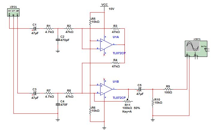

Tried your schematic in the emulator and it works, until I connect the input ground. Then the output drops in half it seems.
This is what I don't understand, why grounding a shield in an emulator "drops signal in half".
Shields have no influence on signal, except blocking external intereference, something simulators have no clue about.

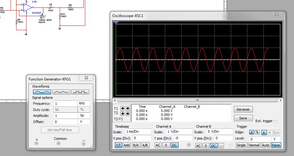

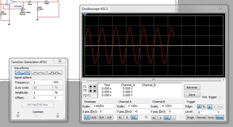

1) Sine
2) Center is common
3) Yes they are symmetrical. No offset.
The program has an AC volt meter.
With the center (common) terminal disconnected...
A) + to center .7v
B) - to center .7v
C) + to - 1.4v
With center (common) terminal grounded...
D) + to center .7v
E) - to center .7v
F) + to - 1.4v
The measurement tools shown in the schematic are minimized. The first pic is what they look like with the sig-gen common terminal grounded. The second pic is ungrounded.
