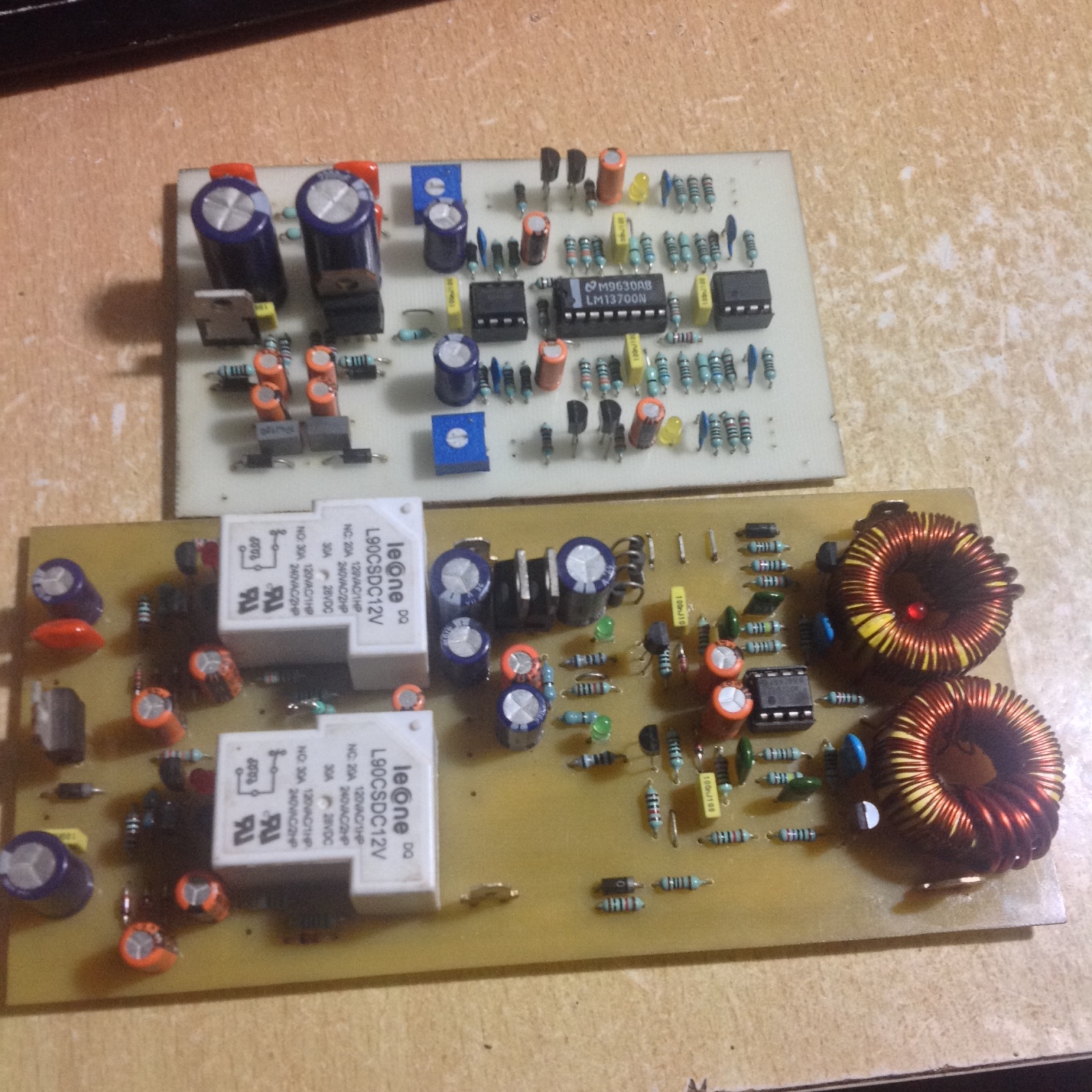

I worked alot to build this one (just 10 modules made), is all in one amplifier ClassAB+B, (initially it was one ClassH prototype but I quit on that and keep AB+B class).
Each module contains balanced to unbalanced stage, IOC limiter (input output comparator limiter), thermal protection, overload and shorted output protection, auto fan based on heatsink temperature DC out protection (triac crowbarr), missing supply rail protection.
This amp is stable 2 ohms, and output current capability is around 50Amps RMS, limited by overload at 39Amps RMS.
Is based on Leco SMPS, custom version for 5,5Kwatts.
I have measured on dummy load as seen in videos (all are in Romanian language but is easy to see and understand what I have done there).

Some components mounted
View image: DSCN2157
View image: DSCN2158
View image: DSCN2159

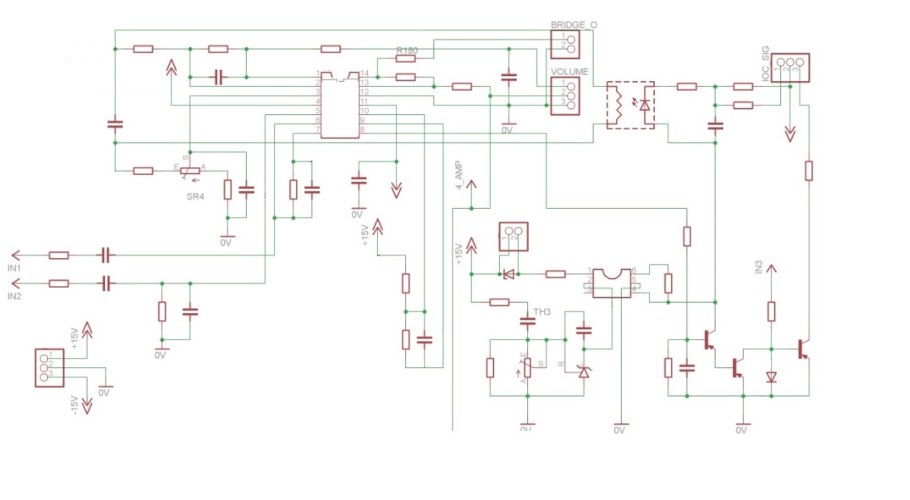

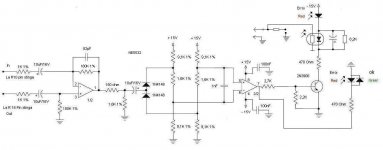

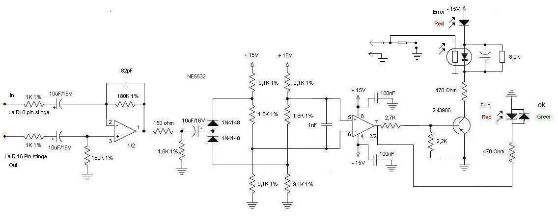

greetings input output comparator could you explain its working
is it from crown amps
warm regards
Andrew😕
The working principle is to take signal from input final stage and from output final stage too (divided corectly too), and when mismatching, it acts, on balanced input stage to cut the input signal.
Crown uses error amplifier stage for IOC
That's not the schematic that I use, the schematic above is a joke, longtime ago.
Sorry for that but it was made exclusive for this project, I cannot share.
Generally short protection, limits output current at maximum value limited, as you see, at mine amplifier, it cuts from 30-40A rms on output to 1,8Arms, wich minimise dissipation, also limiter cuts off signal toi minimum, if error persists.
Is a multislope protection.
Nice work, but I prefear to use LDR instead LM13700, I cut signal when limiting, directly in balanced to unbalanced stage, in this way, not even input stage cannot be overloaded, if too big signat at amplifier input, presumming volume knob is not at maximum (as must be).
