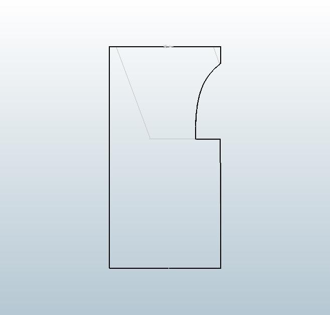

Milling dead centre perpendicular
Hi poobah, ron
I already have all these things - a wiggler, finger clocks and other analogue guages. The job I mill is a component carrier in plastic for moving coil cartridges. This horror is cylindrical in two diameters and square at the back. There are several slots, recesses and threaded holes. I've made jigs to hold the piece while milling or drilling and everything is set up true with clocks.
What I wanted to do was once the 'blank' has been turned on my lathe, was to make 'mark' with a small centredrill before it comes ot of the lathe and then transfer the job to the mill, held by a jig.
To give you an idea of how accurate things should be, the front end is 6mm dia and it has an angled 5mm recess 5mm deep and a threaded 2mm hole further on.
My jigs hold the job securely but I would have thought if you could fit a 1mm red laser device into the milling chuck and manipulate the bed until the beam is dead centre on the guide
mark, then fit whatever cutter is needed.
The wellknown 'wiggler' and analogue machine clocks are fine for normal work but not on the stuff I do. The reason is simple - if your're 'out' by even the smallest fraction of a millimeter, the stylus points offcentre.

How about a dwg or photo so we can understand...
Are you trying to pick up an ID turned on the lathe when it goes over for milling?
Is the ANY chance you are picking up tool deflection in the milling op?
Length & diameter of milling cutter?
Length/diameter ratio of cutter?

just a stab in the dark, but would the tightness to which you chucked and "vised" have any implications? From my own experience, I know it's darn near inpossible to put anything back precisely once moved. Even using stops are not ultimate many times, depending on how much you tighten or cinch. I also know that setups used for precision are often left alone to do that job in a dedicated fashion because setup is time consuming.
Did i understand correctly that you are doing a hole in a cylinder that you prevously turned on your lathe?
If that is the case, and I realise this is obvious but needs to at least be said so we can understand better, why not simply drill the hole necessary while the cylinder in on the lathe using the tail stock to hold a jacobs chuck?
Hi Chipco3434, RetroAudio, DaveM, Willem Fick & bluebeard
A real brainstrust here I see!! My gratitude and thanks for all the useful suggestions and links. The problem with this little part has also stumped my fellow members at the Cape Town Society of Model and Experimental Engineers.
@ RetroAudio I think you homed-in on part of the problem - the hand-torque applied to my milling vise. After the turned 'blank' comes out of the lathe chuck, it is then inserted into a two-part 'holding jig'. The other part of the jig goes into a precision Jacobs chuck, taper fitted onto a threaded 16mm mandrel with no run out, which in turn is fitted into the collet chuck of the mill. The latter runs perfectly true.
At this time, the job, fitted into the bottom part of the jig is in a vertical position in the vise for the purpose of alignment with the top part of the jig.
I then manipulate the mill's bed until I have 'perfect' alignment with the vised job. In other words, the top part of the jig (in the chuck) has to have perfect alignment with both the jigged job and the bottom part of the jig as well. To make absolutely sure the job is centred, it is sprayed with engineers' blue and the top part of the jig rotated by hand until there are no marks left by this part of the chucked jig.
Now comes the part where all these shanoogles go wrong. Since the 5mm dia x 5mm deep circular cavity to be milled at the tip of a 6mm dia plastic roundbar must be angled @ 20degrees off the vertical, I am now compelled to remove the job (still held in its jig) and tilt it and then 'vice-up' again. I think (as RetroAudio pointed out), the 2nd revising before milling is where things go wrong.
The degree of 'offcentreness' of this cavity (where the cart's magnet goes) is so small that it cannot be seen by the naked eye, but causes all parts inserted to be off centre.
I have in the past (while the blank is in the lathe) pipped a 1mm hole in the tip, which I then lined-up in the milling machine with an identical centredrill in the mill chuck.
Even this is not foolproof as the centredrill and its holding components (The chuck) is steel and the job is engineering plastic of 6mm dia. I think the slightest touching of the job by the steel guide drill, deflects the plastic job.
If such a 1mm (maglite) type chuckable laser beam is available, the job can be inserted already angled and the beam positioned over a pre-marked deadcentre pip which I could colour with engineers's blue.
