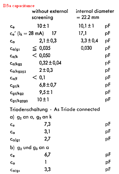

Cg1-g2 is typically 20-30% more than the Cg-a of a comparable triode.
I don't understand clearly the above.
It's more easy if the manufacture shows the specs like this D3a tube. And then we can calculate C-Miller and estimate its effect.
Does anyone can tell me what relation between Cinput, Coutput, Cgk, Cga, Cg2g1.... ?
C-Miller is different to Cinput ?
Cmiller is the input capacitance due to the Miller effect multiplying the in-out capacitance. Cinput includes Cmiller, but also Cgk, Cgh and maybe others C's too.

In case of calculating C-Miller for a penthode tube in triode mode, we can use Cinput (in triode mode) to know how is Miller effect.
If we have no data of Cinput at triode mode, or also no data of Cg1-g2, then How do we calculate C-Miller ?
