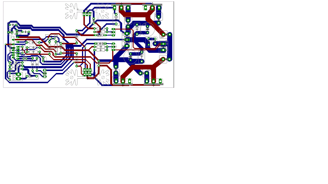

guy's please give your thoughts on this , I had posted this some time back but project was shelved for some time . I am really gonna make some pcb's if the basic design seems okay..tweaking the values afterwards is fine.
The output BJT's are actually MJL 1302 and 3281, Eagle had only TIP so used that in schematic.
With EAGLE you are going to want to learn to make your own devices pretty quick. I decided to make my own transistor lib - EAGLE does actually have all the package layouts needed, including TO-247 and TO-264 devices. Using TO-247 is ok but remember that TO-264 is wider.
I usually take no-scaling prints from PDF and check out the parts fit, if something doesn't fit change. I'll check this out whether the transistors actually fit.

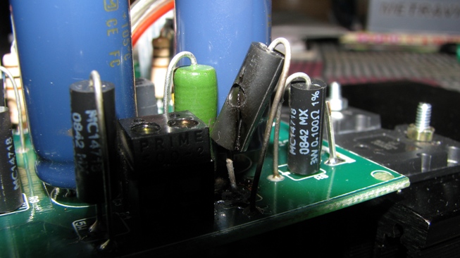

finally got around to making some pcb's and testing this amp, amp runs fine and plays nicely for around a minute or so before blowing up 0.1ohm resistors in the output R5 and R4. If you put a new resistor in it will do the same thing in another minute or so..rest of the amp seems fine nothings overheating smoking and sounds good also.
I had simulated this extensively on multisim and found the voltage drop across it to be only around 0.3 volts even with 6A current from the amp..I would really appreceate some help on this..
6 amps was just in a simulation. I had not measured the acutal current output when I was running it and total output from both the halves, so each half was delivering only half the total current.. so it should be around 0.3 volts across each resistor. The resistors were 3W wirewound types, I agree this is a bit undersized for the app but to reach 3W dissipation level I would need much more than 3 amps.
Am I just seeing the effects of thermal runway ?..My Vbe multiplier was not coupled to the heatsink where my output transistor was mounted.It was coupled to the driver transistor, which itself has separate smaller heatsinks . I have now moved the Vbe multiplier to the main heatsinks where the output transistors are mounted. Should I move my driver transistors also ? Should the temperature compensating element alone mounted on the main heatsink suffiice ?
turned out that CFP's are sensitive to driver temperature rather than output transistors (I didn't do enough research the first time) and also MJE340 as a Vbe multiplier is too slow, I need a faster reacting one like a BD139 ? ..I tried these changes sometime back, the amp runs for slightly longer durations now, around 10-15 mins then the bias current goes through the roof. Is there anything better that I can use instead of a BD139 as a Vbe multiplier. I have attached the BD139 directly on top of my driver transistors.
