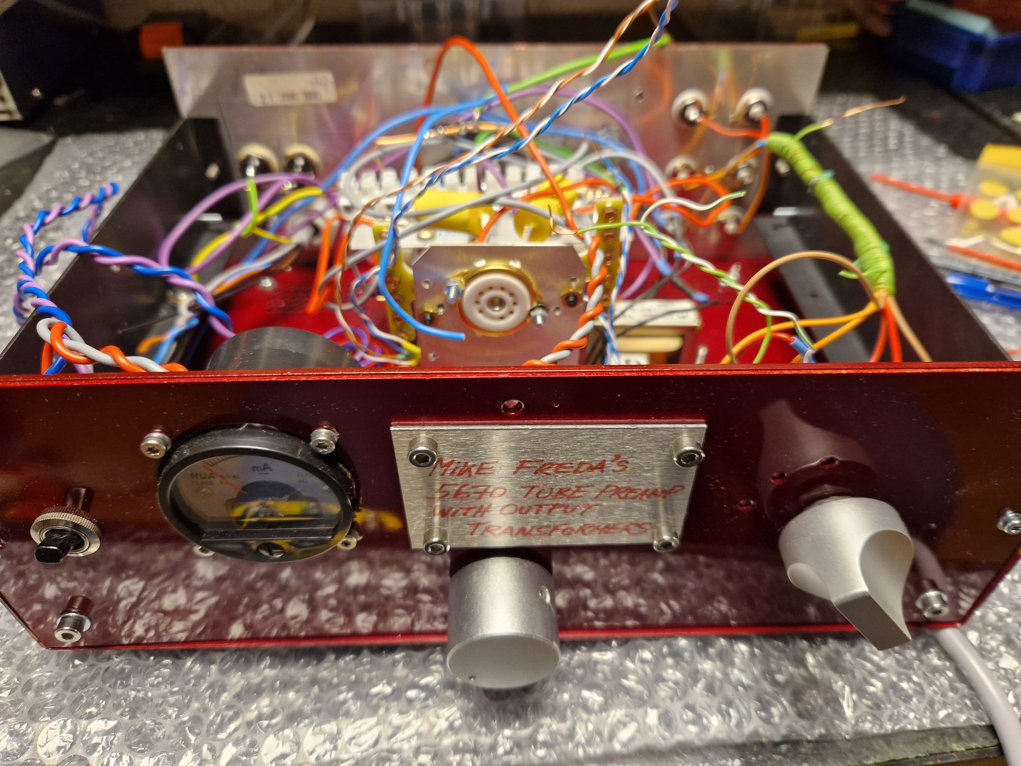

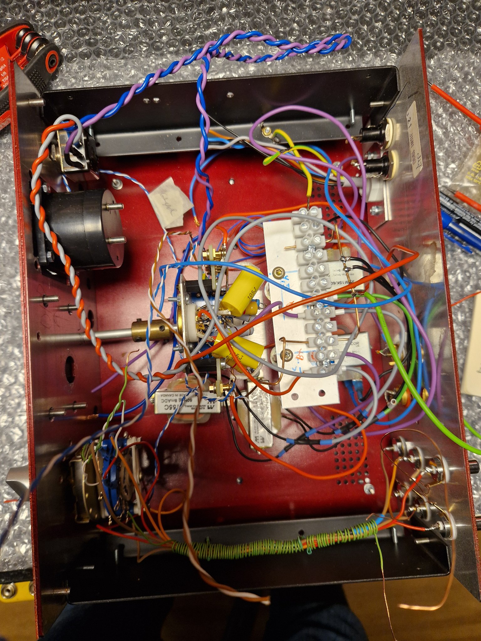

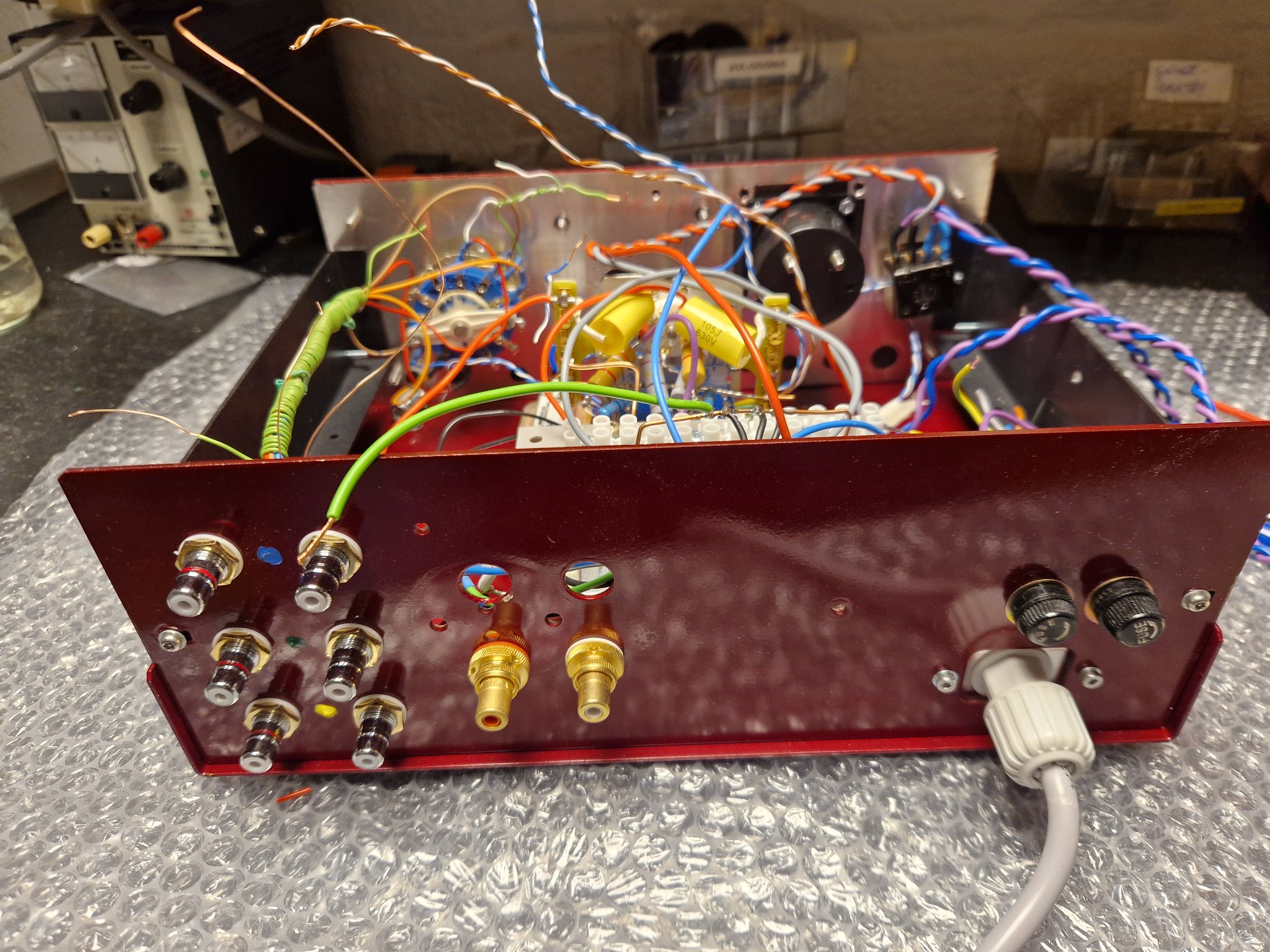

The project has stopped. I'm not sure if I should go for ccs, or just put in drop resistors/chokes...I have so many tube amplifiers lying around, so I'm selling a bit away. Selling the amplifiers for what the iron cost a few years ago, but they are difficult to get rid of... Better to store them in a warehouse, then I can try later... Can post a picture of what it looks like....

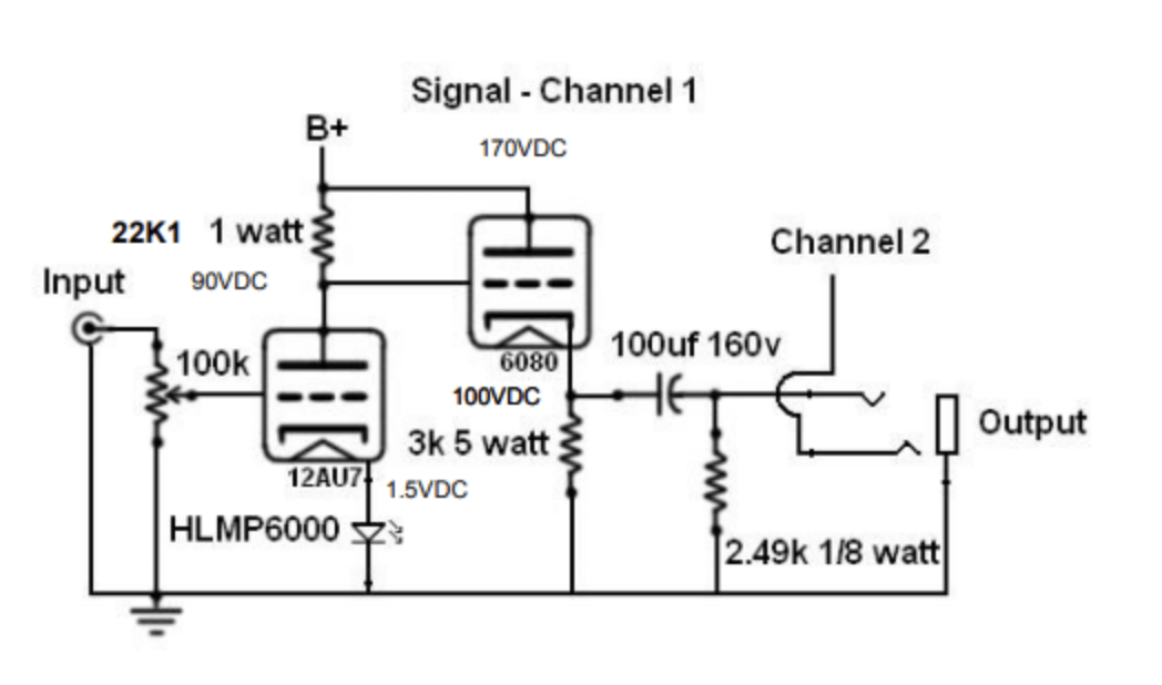

I'm comparing to the crack circuit, if redone as a simple 12AU7 single stage. Why was 100uF the choice vs 1uF here? Was this to bring down the output impedance for headphones?
My Schiit Vali 2 appears to be output capacitor coupled at 470uF at its line level out. How is this value selected?
Two stage Crack circuit without CCS:
