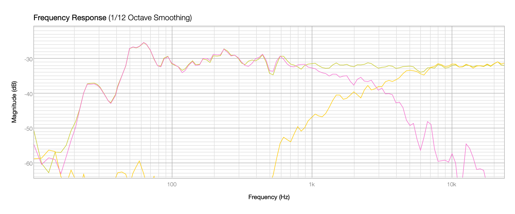

There are many other brands and drivers that will work. The main priority is the Bitches Brew design uses wide bandwidth drivers that can handle wide overlap. For example this is the current configuration I'm using - acoustic outputs from the individual drivers as well as their sum:
The objective is that after DSP crossover, the acoustic slopes are a low-Q 12dB/octave gentle slope with no surprises. I've talked about this a lot in other threads. So you want a 10" that can go up to 4-5K even if the official xover frequency is quite a bit lower.

I see why you want an efficient midrange, but I'm puzzled by you saying that it has to be 98 dB. I assume, since you're taking inspiration from the Bitches' Brew, that your plan is to use the 18" woofers on an open baffle? (With wings?) If so the sensitivity you'll get in the bass range is going to be determined less by the nominal driver sensitivity, than by the effective baffle size and the rest of the driver parameters. To give an example, modelling a pair of 18N862 on a large effective baffle (1.5m square) you can get 98dB/2.83V at about 70 Hz and above. But if you want more extension (say -6dB in the low 30s) I don't think you're going to get more than 92-93 dB out of them. And if you're crossing at 150Hz you'll need to be careful about how deep your wings are. So my guess would be that a midrange with sensitivity around 92-93 would be sufficient.
@ianbo; yes I plan OB with wings, and you guessed right as regards the woofer model. I do want to get down to the low 30s so I take your point about baffle size. 150hz is just an estimate at this point; I’d go to say 100hz if the mid could be crossed there without compromise.
If you are right about the effective sensitivity of the woofers then that does open up the choice for the mids, albeit to my slight disappointment.
The woofers might produce only 90dB at 40Hz but if they're putting out 98dB above 70Hz, and if you're using the passive series crossover, then it's best if the mid SPL to be in the high 90s. If you're doing 3 way full active then the SPL of the mids is less of a priority.I see why you want an efficient midrange, but I'm puzzled by you saying that it has to be 98 dB. I assume, since you're taking inspiration from the Bitches' Brew, that your plan is to use the 18" woofers on an open baffle? (With wings?) If so the sensitivity you'll get in the bass range is going to be determined less by the nominal driver sensitivity, than by the effective baffle size and the rest of the driver parameters. To give an example, modelling a pair of 18N862 on a large effective baffle (1.5m square) you can get 98dB/2.83V at about 70 Hz and above. But if you want more extension (say -6dB in the low 30s) I don't think you're going to get more than 92-93 dB out of them. And if you're crossing at 150Hz you'll need to be careful about how deep your wings are. So my guess would be that a midrange with sensitivity around 92-93 would be sufficient.
At this point I’m not sure whether I’ll go semi-active (2 channels per side) or fully active (3 channels).
Yes, I can see that the passive crossover can help with a bit of filter gain. I guess the size of the baffle and wings is key to getting the sensitivity up there. And your DSP eq helps the extension a lot.The woofers might produce only 90dB at 40Hz but if they're putting out 98dB above 70Hz, and if you're using the passive series crossover, then it's best if the mid SPL to be in the high 90s. If you're doing 3 way full active then the SPL of the mids is less of a priority.
I noticed the post you just made with the current eq curve (https://www.diyaudio.com/community/...rshalls-live-edge-dipoles.424917/post-7959206) Do I understand it right, that you don't need any equalisation specifically for cavity resonance created by the wings? If so, I guess the slanting of the wings is important?
No EQ necessary for cavity effects with wings because that resonance is 150Hz which is above the crossover frequency. Plus the cavity residence is different for each of the two 15OB350s.
The sinewave shape of the wings is important, but they don’t have to be slanted wider apart, so as to be non-parallel. Though I suppose that might help a little.
