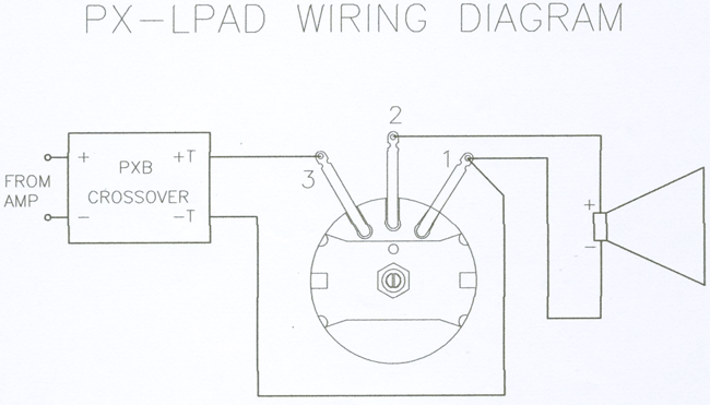

Do you have an L-pad on the CD to knock it's output level down to compliment the woofers? With around 107dB sensitivity you should have 7-10dB of pad on them. I suspect you would also get much better results with the crossover frequencies moved up a bit, that is easy to do with an activer crossover of course so you might consider going down the route if you can't get the passive crossover dialed in, I also had a lot of experience with piezos when they first appeared back in the '80's and this model is very much a super tweeter which works best when it's just adding some topend sparkle, you don't want to overdrive them as the output turns to mush.. we used to call it the frying bacon effect.

An L-pad is the recommended method for level matching with a passive crossover, hugh cuts on a graphic EQ will create a very lumpy response and generate a lot of unnecessary phase shift. And the added benefit of using an L-pad is it can be used to help flatten the highend response of the driver/horn combo by simply adding a certain value capactior across the series resistor.
I appreciate the advice - thank you. I have the option of integrating the L-pads into the brackets I'll build to hold up the horns. Alternatively I could include them in the cabs and have the knob either pointing downwards near the piezos or even out of the blank panels I've fabricated to go where the old horns go but really, I've fooled around inside those cabs as much as I feel like.
I've been resisting (heh, heh) using the L-pads because of an aversion to turning amplifier power into heat any more than necessary but yes, those horns' output is definitely elevated relative to the rest of the cabs'. But what was surprising to me was that even with the replacement one-piece horns installed, the cabs are way more efficient than my two-way JBL L56es. I figured driving them with the 215W/channel Crown XLS1000 amp would be plenty, but I have since picked up a Hafler P125 at 60W/channel that probably would drive the cabs as loudly as I'd ever need. The Crown isn't bad - and I really selected it from several amps at a used shop because it was crazy light - but the Hafler is I think overall the better amp.

Oh you have adjustable L-pads. Here is what I suggest.. you don't actually want to install those in the cab because they tend to become intermittent in PA applications, you want a fixed L-pad made from ceramic resistors added to the crossover. But you can use the adjustable unit to figure out what value resistors are required, just hook one up temporally with wires, dial in the correct balance with the pot, and then disconnect it and measure the resistance across both legs.I appreciate the advice - thank you. I have the option of integrating the L-pads into the brackets I'll build to hold up the horns. Alternatively I could include them in the cabs and have the knob either pointing downwards near the piezos or even out of the blank panels I've fabricated to go where the old horns go but really, I've fooled around inside those cabs as much as I feel like.
I hear you, but power loss is going to be pretty small with the L-pad correctly wired in between the crossover and the driver, that circuit may only see 10-20w at most.I've been resisting (heh, heh) using the L-pads because of an aversion to turning amplifier power into heat any more than necessary

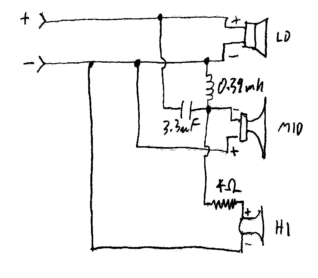

You can not use a "universal" crossover, because this is a special speaker and not the unknown Dayton "universal driver combination".
The first rule of speaker construction: Every driver needs a crossover matched to it.
If you use the Dayton "500-4k" with serious level, you will burn the horns voice coil.
@conanski - Great idea re using the adjustable pads to figure out values for "hard-resistoring" more permanent ones. Would I need to be using, say, 20W resistors for that?

@Turbowatch2 - Padding down the compression drivers post-power-amp has already been suggested and accepted especially since I do have a pair of adjustable pads already. I figure the drivers are going to do what they do and same with the crossovers; I've accepted that the matching of drivers and crossover may be imperfect (although I might should have gotten one of the other models with somewhat higher L/M cross now that I know there were such things).

As others have mentioned, a crossover designed for the chosen components is a better option than an off the shelf crossover. Being able to measure each section - lows, mid, & treble will be critical, especially since the woofers are in a unique cabinet & you may have drivers w/o reliable spec sheets.

For a time I had resisted replacing the cabs' original crossovers but as I became concerned about how unequal the two cabs' responses were, I realized that I really did not know if the existing crossovers were wired up legitimately - they were just components nailed to a board and soldered to a terminal strip with nothing labeled. I sketched the schematics from inspection and they resembled no other crossover circuits I'd found:
So yes, I acknowledge I've just thrown together some parts hoping to get a good result...and other than the unequal mids, I actually have. If they don't have audible problems once EQed as close to flat as I can make them and well-produced music sounds good through them, I'll have succeeded.
@noggers - Because the crossover I'm using has the option of selecting either 4 ohms' or 8 ohms' worth of woofer, I could actually make the GRS 12PT-8 speakers work. I think I decided to go with the GRS 12SW-4 in part because of its Xmax of 8.5mm versus the 12PT-8's 6.8mm. I'm comfortable going forward with the 12SW-4s; so far so good sound-wise.
