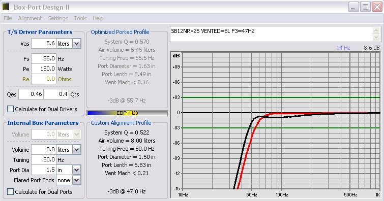

The SB12NRX2504 is a perfect choice for the XT25SC90. This mid-woofer is very impressive. Loaded in BR box:
5.5L box ---> F3=55Hz
8L box ---> F3=47Hz
Best of all, the Voice Coil Linear Travel = 10mm p-p. With contouring, you can get this 4 inch to kick some bass.
The SB12NRX2504 can easily be crossed at 3,500Hz with the XT25SC90. I find that below 3,500HZ, the Vifa starts to strain. Try to keep the tweeter at 3rd or 4th order.
8L box ---> F3=47Hz

An 8-liter vented box is a very good suggestion, but modeling and first tests will be done on an existing 5 liter box I have: 220mm h x 120mm w x 120mm d. What do you think?

The SB mid-woofer will be fine in a 5L box. According to modeling, 5.5L is optimum. This is about the same size as my Hafler M5 near field monitors. I'm sure your speakers will sound better. In my M5, the mids are muffled.
