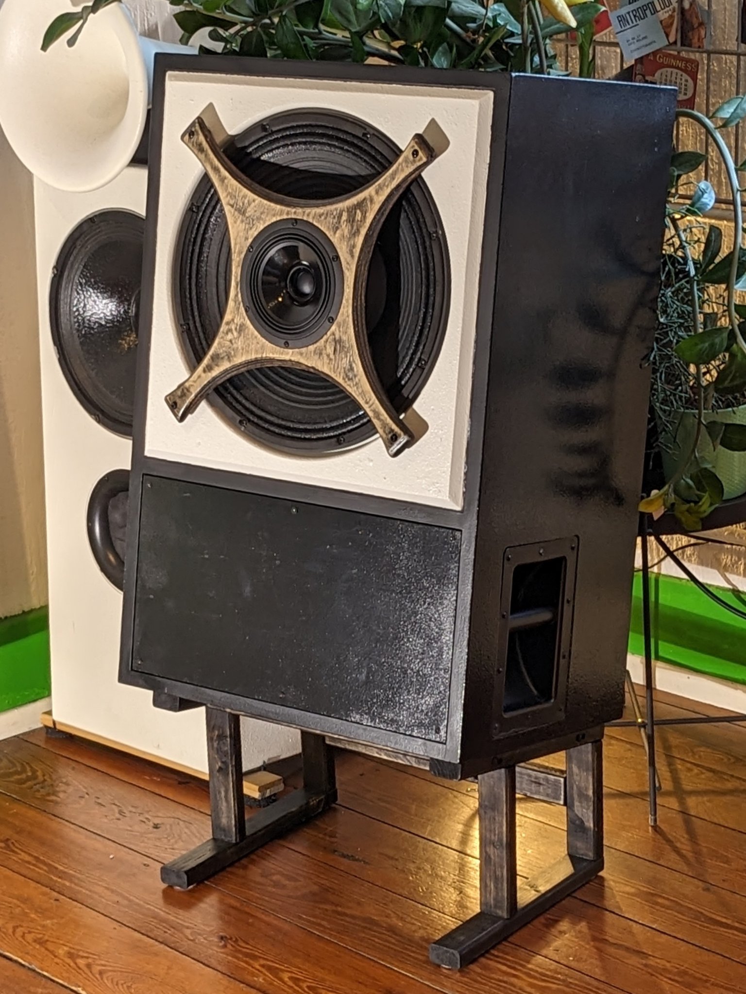

Stumbled across this RL 921K speaker. This design would be amazing for the "wife acceptance factor". How would the sound waves coming off the woofer not royally screw up the mid and tweeter response?

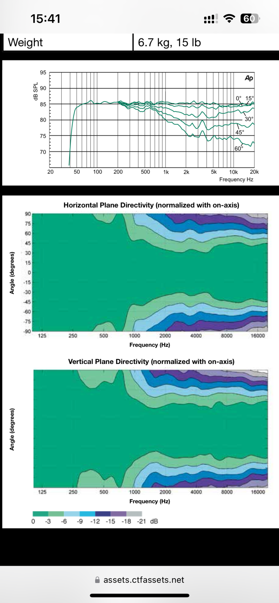

I also notice that the measurements include a 45 degree response plot but no other angles. I can't speak to their intention but using this method can indicate a positive trend without drawing much attention to possible negatives.

I would think the low frequency sound waves hitting the back of the mid and tweeter would affect their performance.
I would also think the mid and tweeter in the way of the woofer would affect the woofer's performance as the sound bounces back towards the come off of the mid/tweeter mount.
It's really kind of a mess. Even highly developed true coaxial drivers still have real problems.
One thing I can say, Geithain monitors sounds really good.

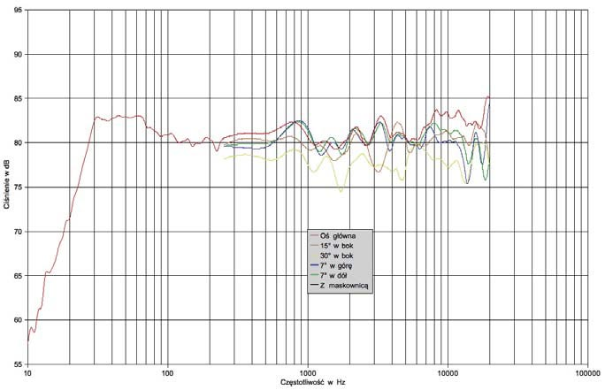

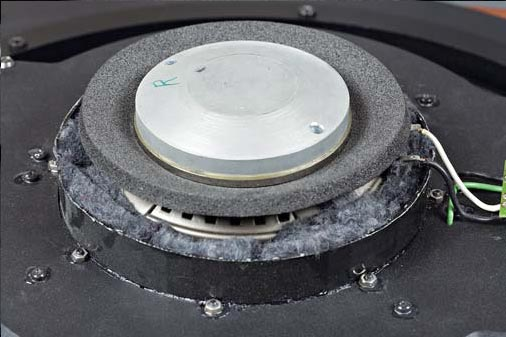

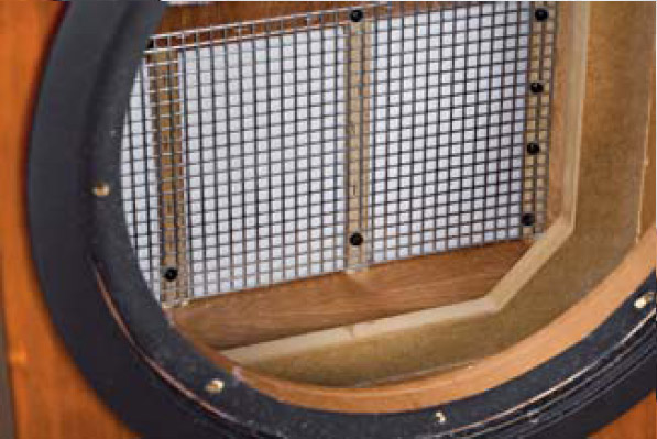

Mini baffles have some absorptive material behind the mid driver, which should create cardioid radiation (I think it's still more dipole with reflection from the bass driver, kind of a second order dipole?). The bass cabinets of at least the big monitors also have a cardioid design with a port on the back wall, I don't know how useful that is.
The Polish magazine has measurements of the large monitors and some photos: https://audio.com.pl/testy/stereo/kolumny-glosnikowe/329-me-geithain-rl800k#laboratory

here are other measurements of a Geithain: ME Test

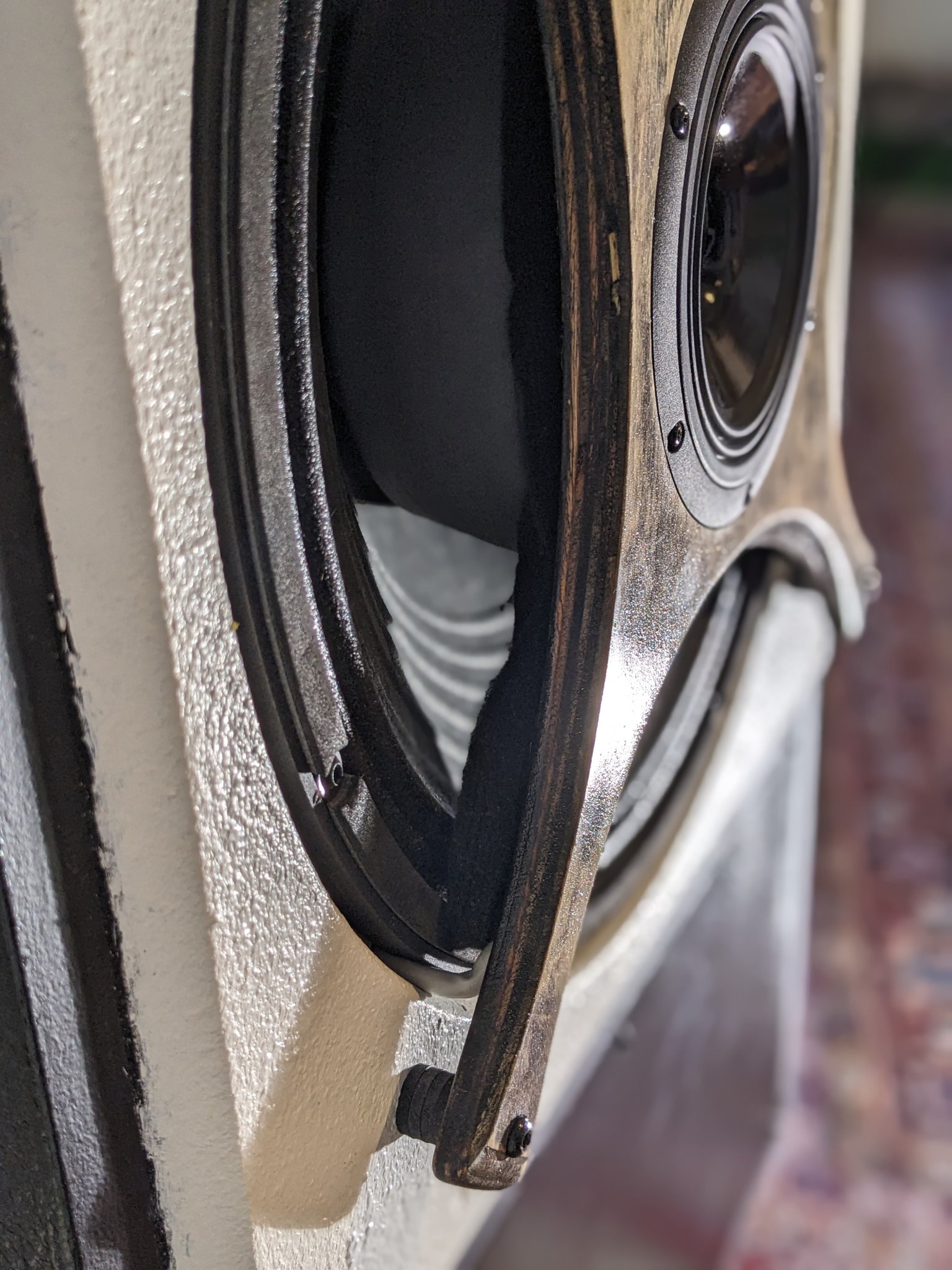

As long as the top drivers are sealed, the small front baffle will have more effect on the woofer. Not the first time we have seen rear-mounted woofers peaking out of smaller hole in the baffle.

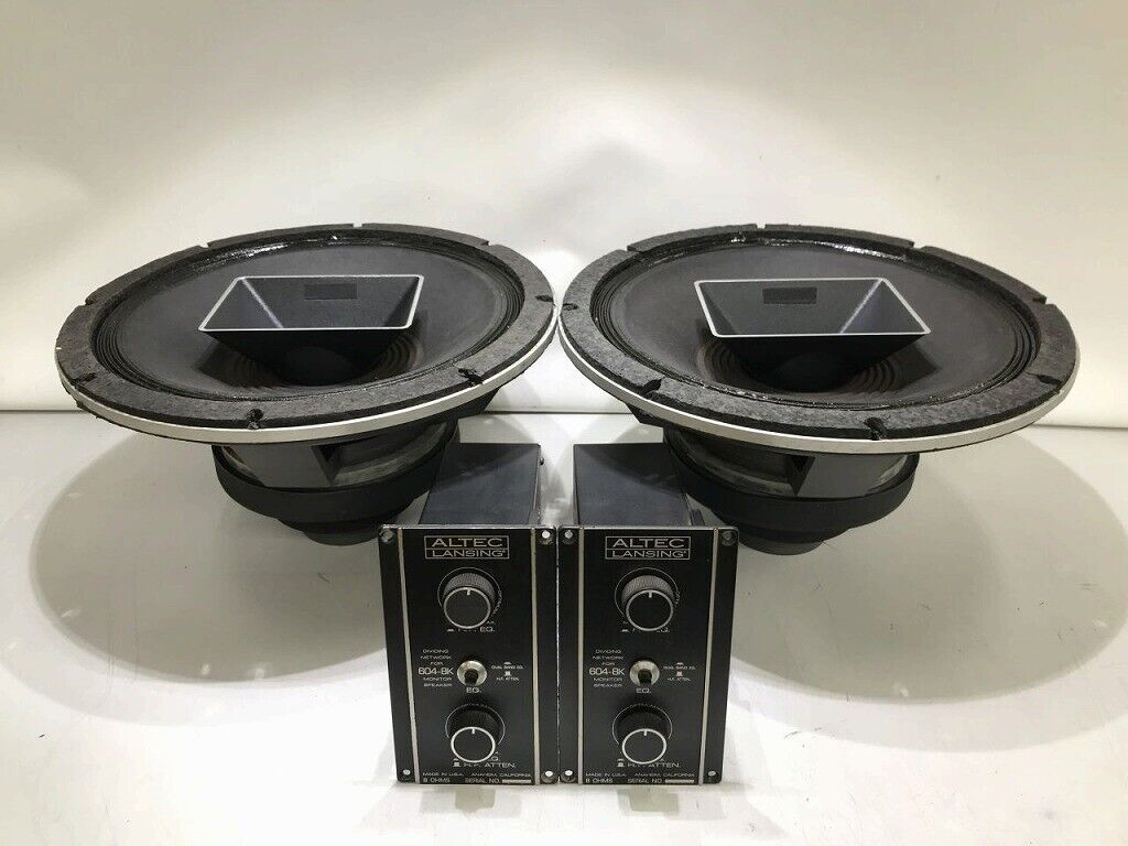

An other example is the Altec Lansing 604, The tweeter horn also is in front of the woofer and covers a large part of it and still this is a legendaric driver, that altough it's antique (released in 1944), it still sounds quiet good today, and it still is very popular. The horn changed shape over time (but not that much) but in essense the driver remained the same for his whole lifespan untill the mid 80. And it's still made (more ore less to original specs) by Great Plains Audio...
Will correct a little this: horn is in front. Magnet, coils atc are IN THE BACK of the woofer. Haven't seen this in person, but probably that little "bump" on the back of the big magnet is the small magnet of the tweeter. It is the correct way. Or to be precise - better way.
