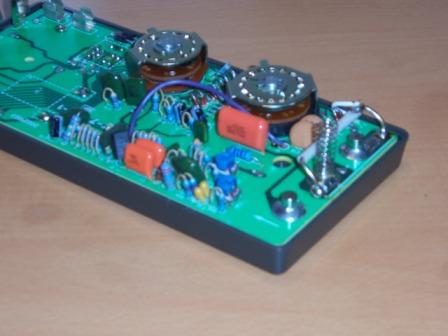

So I borrowed a digital camera to show the kind of switches that are in my Micronta target! Do I un-assemble these by taking out the e-clip and then use an eraser on all contacts or do not un-assemble the switches and use a non-residue spray cleaner or a cleaner/lubricant? (see attached picture)

those switches are better than the ones i was describing.... use deoxit on those, and it might work like new. i was thinking of the switches etched onto the PC board and the knob having the leaf spring contacts on it. the ones in the pic are usually pretty reliable and will last a lot longer. cleaning those switches with deoxit should work just fine. the only thing that would NERTS those switches would be a bad case of corrosion with visible green crystals.

Oh well. it was worth a shot.
I spayed and clicked and sprayed and clicked. I can see the contacts and they are clean and fine. Maybe the center contact is bad on the lowest settings or maybe the resistors in the ladder just went? I am not sure which resistors are the ones for the lowest DC settings.

you might look at the pc board and see if it's cracked or if you have bad solder connnections. the resistors for the lowest ranges will be low value resistors (comparatively speaking, they are usually at least a few megohms), usually in meters they are all 1% or less tolerance. another thing that happens to DMM's (especially older ones) is damage to the input amplifier and ADC from static electricity. i once had a new Beckman DMM go south, just from the static picked up near the face of a TV picture tube. back then DMM's were a new thing, and DMMs were easily damaged by static. the problem has long since almost completely vanished as manufacturers have made the electronics in meters more durable. it is possible that your meter got damaged from exceeding the input voltage (marked in red between the banana plugs) limits if you have measured something that has a low average voltage but a very high peak voltage (like a horizontal output transistor collector on a TV or computer monitor, some of which might have an average voltage of about 200 or less volts, but peak values above 1500V).
So I got to the range selector switch again and put sonme 400 grit sand paper where I could clean the contacts. The switch will not come apart with it soldered into the PCB, even with the e-clip removed. Another blast of residue free contact cleaner.
While open, I checked evenything and the resistors, solder joints and PCB all look perfect.
I turned it on and the three lowest ranges worked again....... for a half hour and right back to the problem.

while those switches are far better than most used on cheap DMMs, they do have their limitations..... if the silver plating was worn off the contacts to begin with, you didn't hurt anything using sandpaper on them. the copper does have a tendency to oxidize quickly. there is a better way to burnish switch contacts (and relay contacts) and that's with a piece of brown paper from a paper bag. glad you bought a new DMM you're happy with. i have an old milsurp Fluke handheld i'm happy with, and also hace a couple of odd cheapo meters i keep for things like working on the car, etc...
