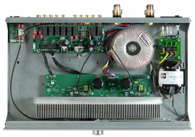

Looks like there are 4 LM3886T for the stereo unit. This is a paralllel LM3886 design. Paralleling 4 LM3886 would yield an amplifier that could drive anything. But I have never seen one.
I listen to another parallel LM3886 amplifier. It works great. Without knowing how the Micromega is built, it is hard to say how it sounds. But the LM3886 are not the limiting factor here. Maybe the digital volume control, power supply, and steel case.
Used to sneer at amps using chips. Now I admire them. They CAN sound very good. Like all other things, it all comes down to design and implimentation.

Interesting to learn from Micromega that the "specially designed heatsink" should keep the electrolytics cool.
Four ICs for a stereo amp means two in parallel per channel. Not that special, is it?Panelhead said:Paralleling 4 LM3886 would yield an amplifier that could drive anything.

Just one per channel?, like chipamp.com gainclones. I think is just a gainclone with poor components and high price. i don't know how much it cost but knowing Micromega you can think about 1.300 euros, 1.900 USD.
What about the position of the trafo and the binding post, is not a little forced?
That fin spacing of the heatsink specs for forced air, not convection draft. It appears to be some sort of "space heater" arrangement specifically designed to get rid of electrolytic caps as quickly as possible. Wasn't there supposed to be air inlet holes underneath a heatsink? 😉
With that many digital circuits. . . did they include a radio?
Its rather nice that it has a remote control (see all those relays for input--that's a bog standard remote board that also makes a buffer), so kudos for that feature.
