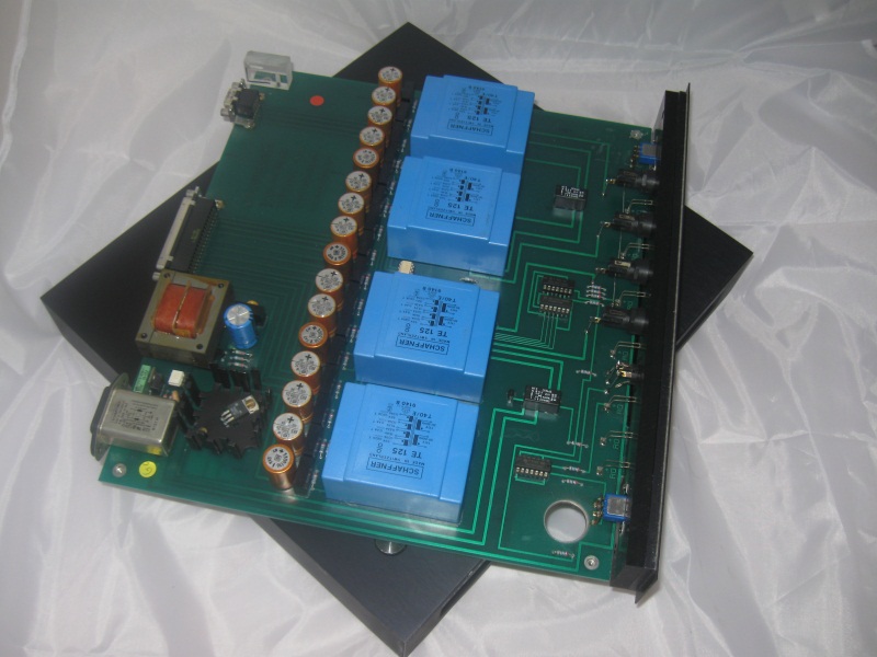

For those who like to know , the micromega cd 3.1 transformer has :
2 primary windings , 2 x 162.5 ohms , for 110 v and 220 v
5 secondary's windings , 4 are center tapped :
no load voltages ....................................dc resistance
16.7 v -0- 20.0 v ...................................4.2 ohms - 88 ohms
5.6 v -0.................................................2.1 ohms
20.0 v - 0 - 16.7 v ..................................85 ohms - 6.7 ohms
measured with Fuke 289

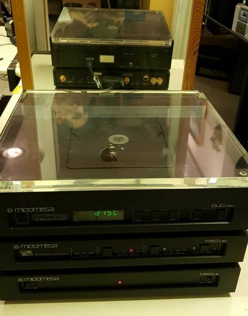

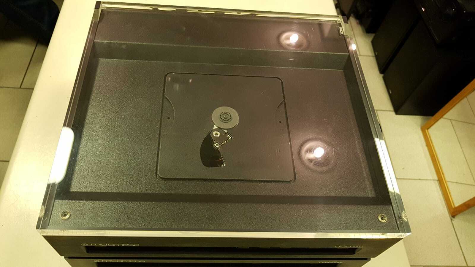

is it this model ?
Micromega TRIO CD High-End 3 Box CD-Player- VERY RARE | eBay

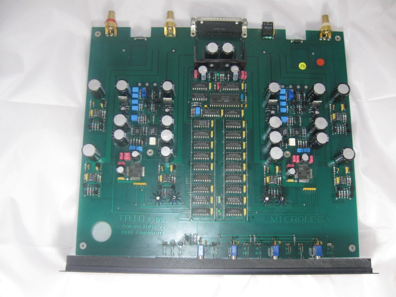

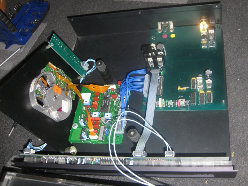

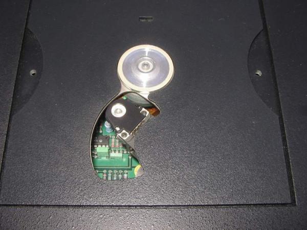

Then it is necessary to carried out a strip down for making images of the internal details - in the kind of examples from post #52 under
Micromega Solo CD Player - help!!
With help of the uploaded cd transport and PCB images (include IC's) it is possible to find out for other members the corresponding Philips models and the associated service manuals.
Please don't use portals like photo bucket, image shack and so on.
I assume that all (possibly only sketchy) circuit diagrams of the old Micromega products have been smashed in and are therefore no longer accessible to anyone - check out post #9 under
Schematic for this beautiful Micromega Solo, Trio and CD f1 (first edition) wanted
Thus there aren't other possibilities for troubleshooting than the above mentioned.
P.S.: if there is a philips transport below CDM-9/cdm-9pro (i. e. CDM1-4) in use, repair and spare parts are not difficult to find from good available philips models with same parts.

Yes, it looks like the top unit in this picture:Micromega TRIO CD High-End 3 Box CD-Player- VERY RARE | eBay
First series of "TRIO" uses the CDM-3 - go to
Philips CDM3 cdmechanism - DutchAudioClassics.nl
MK-II versions uses the CDM-9 in the "DUO" transport envelope - go to
Philips CDM9 cdmechanism - DutchAudioClassics.nl
Philips CDM9/60 Pro cdmechanism - DutchAudioClassics.nl
in the attachment the associate images stolen from web sites like ebay (log out for looking the naming of images).

The transformer is bad, not the CD drive.
There are a lot of transformers in use. Which of them is bad ?The transformer is bad, not the CD drive.
