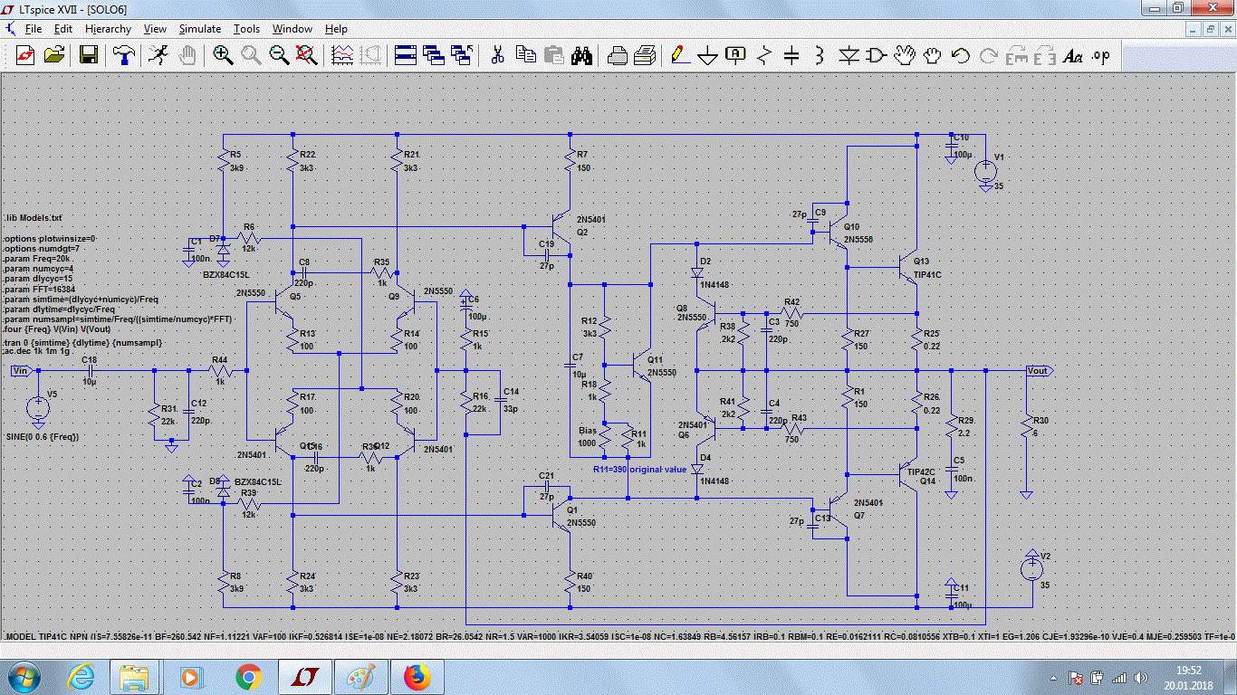

I have Microlab Solo 6 speakers. Then I bought the Monitor Audio BX2 speakers. I wanted to make an amplifier for the BX2 speakers. I tried various circuit diagrams. Then came the Solo 6 circuit diagram.
I have been following the forum for a long time and I have tried to develop the Solo 6 scheme as far as I have learned. But I am totally inadequate in this regard. I need help.
- I added CCS to the zener diodes to work between +- 20V and +-45V. LED and FET. Which is more convenient?
- I have added a Beta enhancement for VAS, but is it true?
- How to make open loop bandwidth, phase shift, square wave, clip etc. To do?
- how to behave different loads?
- What do I do wrong?
The transistors I can use are KEC d1047, KEC B817, 2SC4793, 2SA1837, BD139-16, BD140-16, BC550B, BC560B
I can use the power source as DC + -22V or DC + -44V.
I want quality, not very high power
I can understand english but I can not write, so this is the translation of the google translator.
Thank you.
