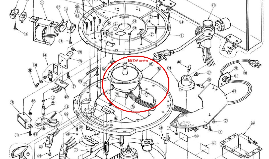

That motor looks familiar. It's very similar to the JVC QL-5 but the motor model is M935A.
Partstore.com has JVC motors for sale you can perhaps ask them about this motor model.
The flange is different from the QL-5 but the other parts look similar. Here are some pictures from a repair in Japan.
Some pictures of the higher model QL-7 in disassembled form. Different motor but spindle is similar.
Even if the rotor on the QL-5 is the same, there's no guarantee the taper spindle will fit the Micro-Seiki platter. I hope all these information helps.

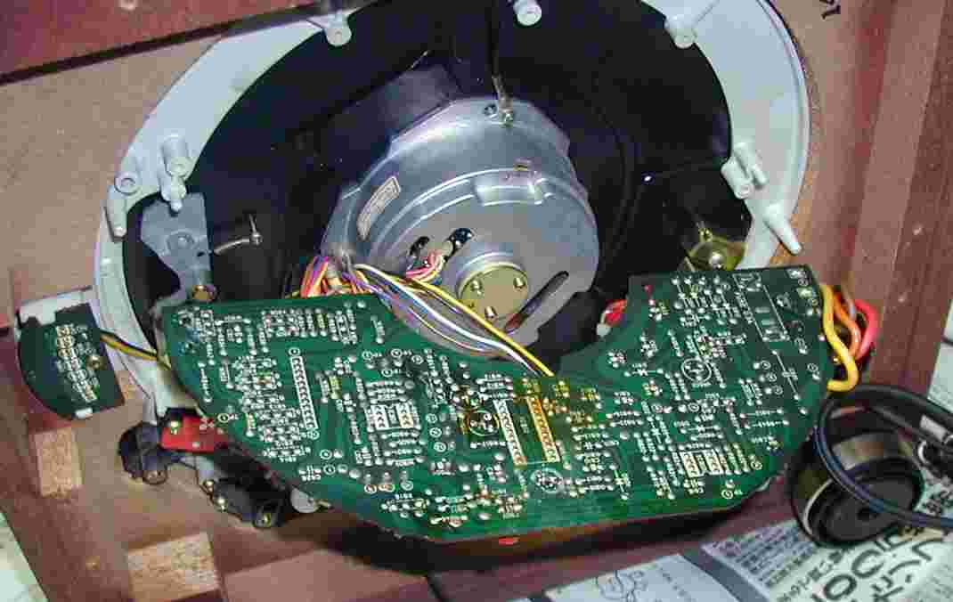

Here are some photos of a motor taken from Micro Seiki DD-8.
The model is JVC MC936B2.
The one on the DQX 1000 I am looking for is MC936F.
The control electronics is different but the motor unit looks very similar.
I may buy it to use the rotor and the bearing.
The size of the spindle is the same, looks that it will fit the DQX 1000 platter.
