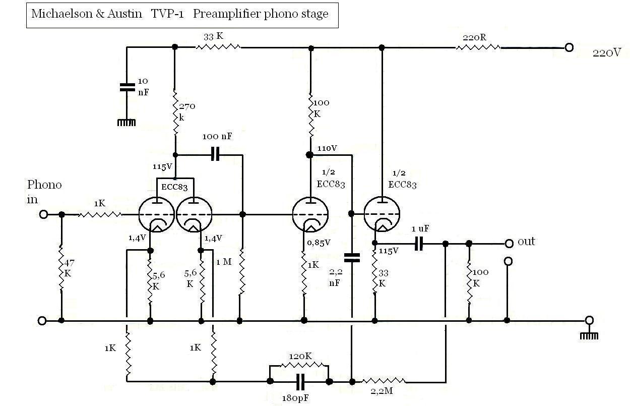

Does anyone have a schematic or manual for this unit? Previous owner removed parts from board and played with the wiring. I've already checked all of the usual places; can't find a thing. It seems to be a pretty rare piece. ANY help would be greatly appreciated.

I'm pretty sure the connection shown to the grid of the right hand section of the ECC83/12AX7A is a mistake, it should be wired in parallel with the grid on the input side.
Interesting how the HF feedback is taken before the cathode follower with just the extreme LF taken from the output. This would tend to prevent external capacitive loads from affecting the accuracy of the RIAA equalization.
Note most cap values are shown in nF which might be less than obvious at first pass.
The schematic in the previous post seems to be a redraw of the schematic Frank found on google.be.
Something else to note is that the cathode follower section of the second ECC83 is running at 3mA which is pretty high for this type. Seems like a 12DW7 if pinned out correctly might be a better choice in this position.
I have found an identical hand-drawn schematic on the web. In that drawing,there is a question mark on the line from the grid of the second triode section and the output of the 100n cap. I'll have to look at the board to verify this.

From memory, I had drawn the complete diagram but lost it somehow, Kevin's analysis is correct.
The line stage uses a pair of ECC82s where one triode section is configured as a current source.
A topology TDP used throughout for the flagship TVP-X.
My friend from UK also found the mistake with connection from grid nr. 2 to the capacitor..... should have been to grid nr. 1

You could take a close up picture of your preamp PCB from the component side ( may be two pictures if the PCB is a A4 size), and after that one or two pictures from the soldering side, and post the pictures . Then we might have a chance to make the schematic.
Overall, it's limited how many ways valves in a preamp can be connected.

That said, it wouldn't surprise me at all if the circuit diagram as shown here in previous posts is incomplete or even contains more errors.
