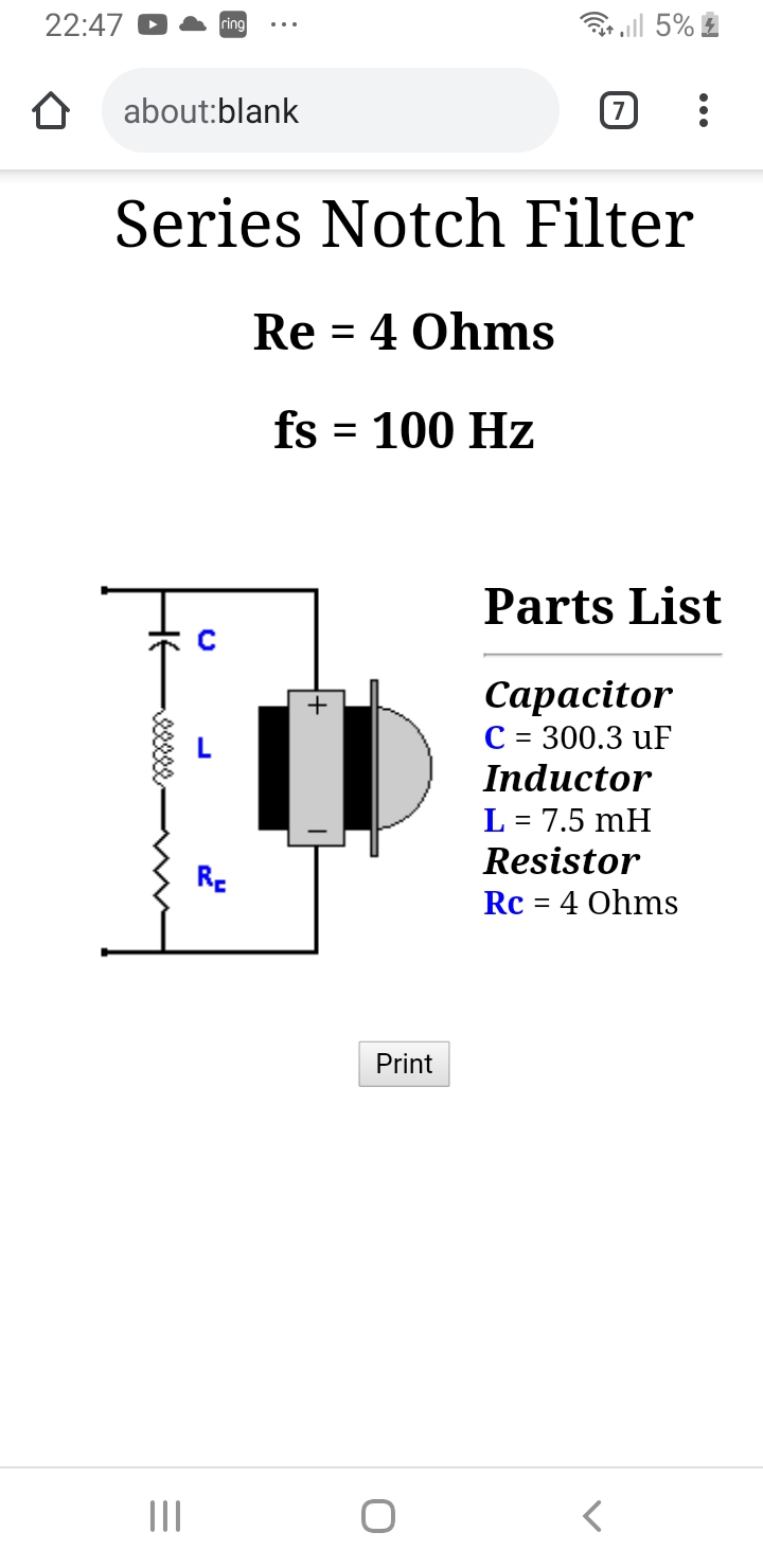

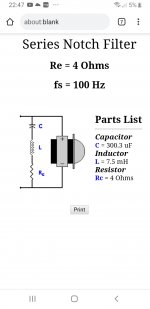

hi, unfortunately my room dictates both speaker and listening positions. I am getting a ~10bd spike at frequencies 120hz down to 60hz. would a notch filter (image attached) work to attenuate this?
I think it would bu I'm looking at about £100 in part to find out, which isn't a problem if it works.
cheers adie

No, that one is to equalize impedance, not frequency response.
If you want to go this route, you are looking for a parallel notch filter (also called a parallel trap circuit). I think it will probably be fussy to get right and not as precise as you want though.

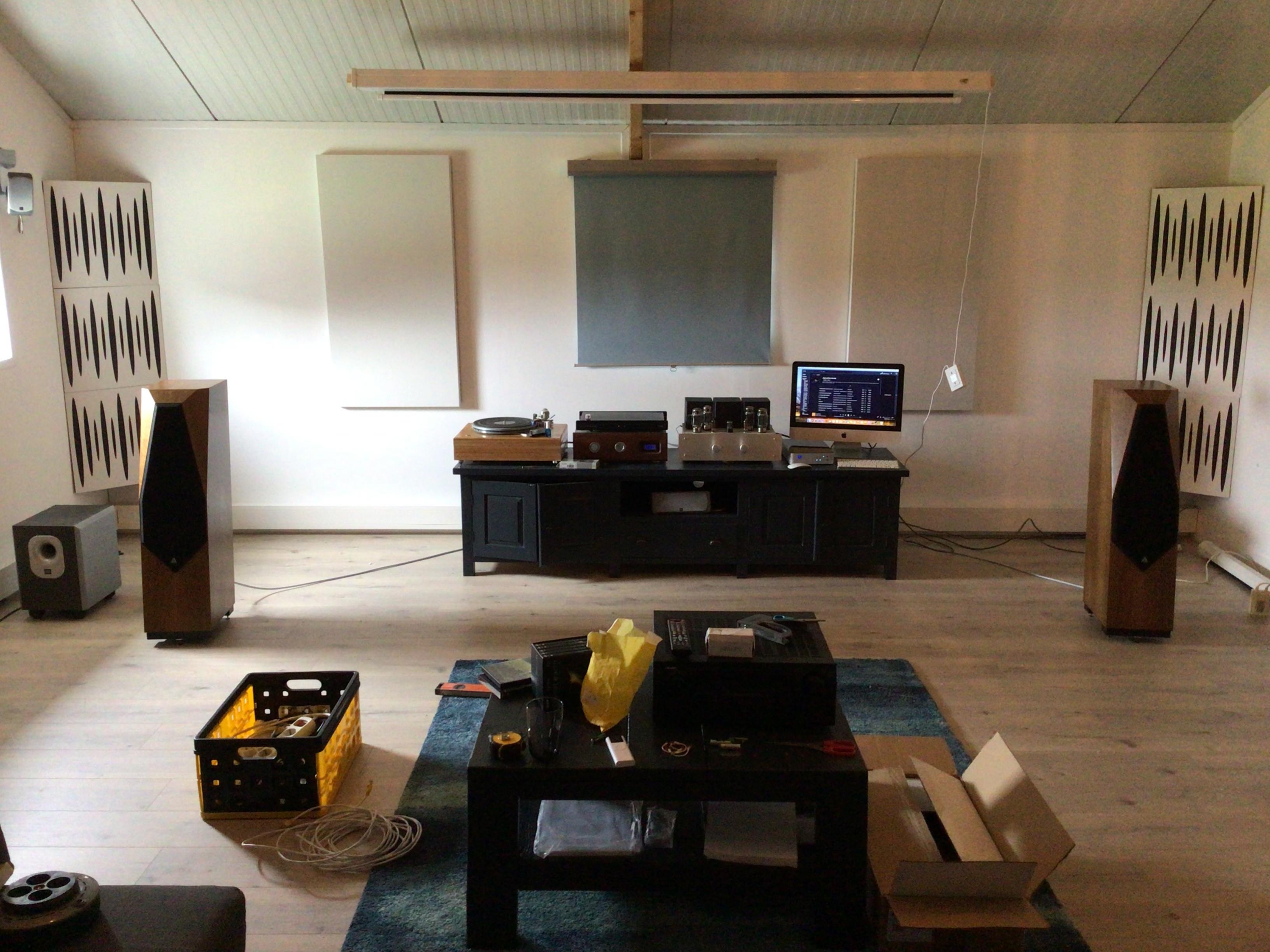

Have you ever thought about acoustical treatments of your room? I just finished my listening room and I had the same problem. My room is 6 by 6 meters. And the room sufferd from a zooming noise in the low region because of standing waves.
I bought 6 basstraps from i4studio. This is a webshop based in holland. And I put 3 of them in the corners behind my speakers. And really it solved all of my problems. They ship to England. And they are not that expensive.
If you need more damping, you could also place them in the other corners behind your listening seat.
See the picture i have attached.
Regards edwin

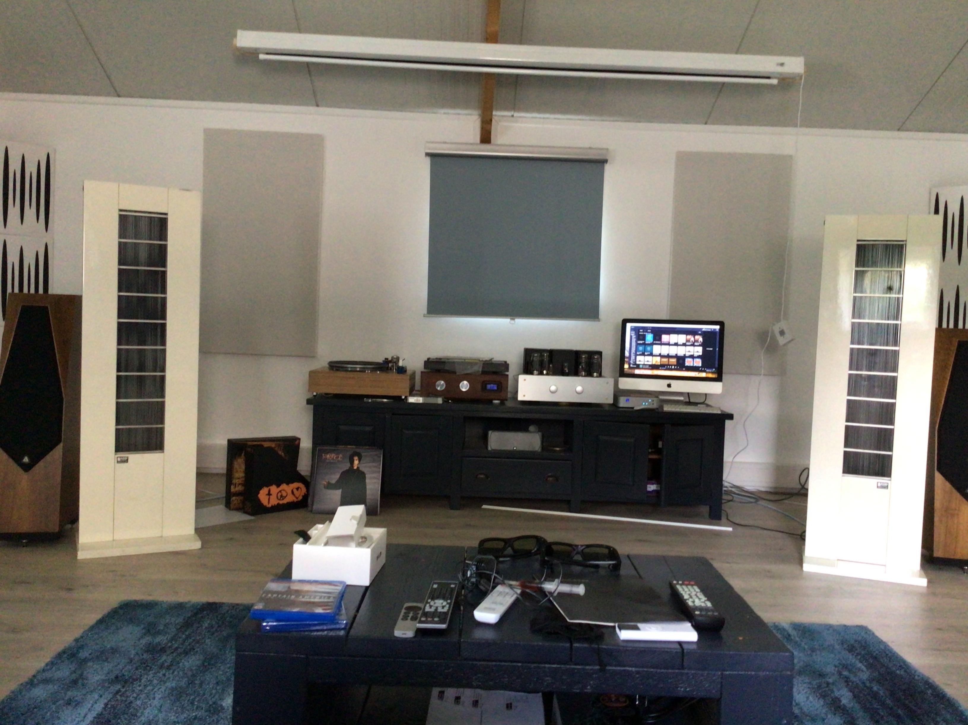

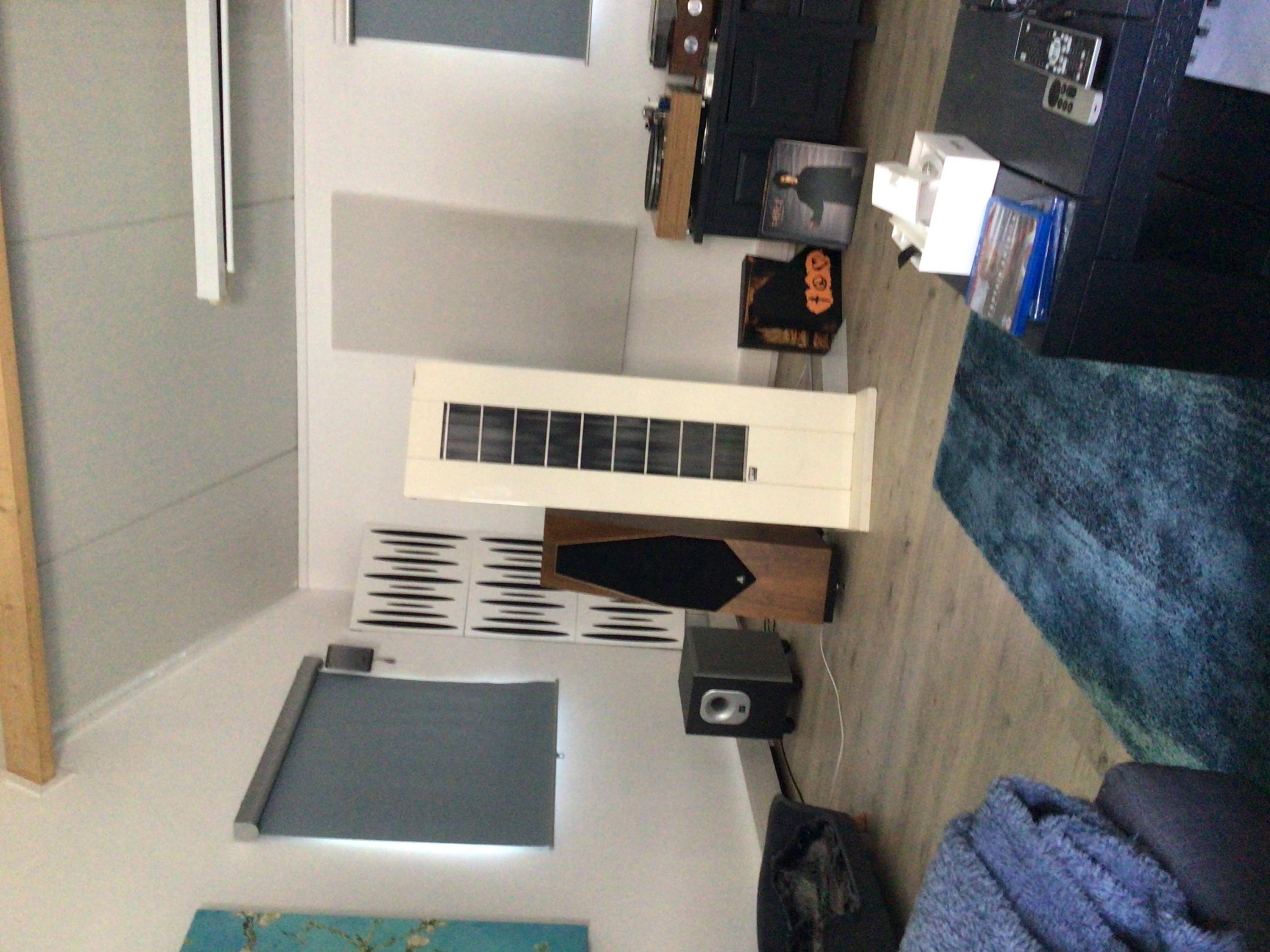

Again some more pictures. I also threated the rest otherroom with acoustic stuff and it works amazing
Edwin
