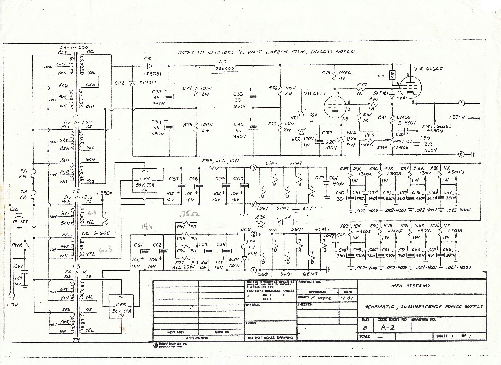

MFA Lumi started "motor-boating" today
MFA Lumi started "motor-boating" today 🙂 Any ideas what is causing it? I have the diagram. My thoughts are: 1) regulator tubes 2) filter caps 3) coupling caps 4) who the hell knows...

I would check C35 & C36 for leaking....Going "high".
I would also drop a cap at pin three of your 6L6GC to ground, Appx 1.5uF400+VDC(The 'perfect' capacitor)..I'm suprized there wasn't one in the first place.
Just throwing ideas out.
______________________________________________________Rick.....
vr3?

No, VR2, one of the pair (chain) providing reference 340V dc voltage. I replaced them with a chain of five 68V zeners.
VR1 and VR2 actually clamp the voltage on the grid of the 6L6GC during warm up, when the 6EJ7 has fully warmed up and the feedback loop is closed you will see that the voltage at that point is below the zener threshold by some 40V or so depending on the condition of the particular 6L6GC and the line voltage.. They also will clamp the output voltage in the event the error amplifier tube (a 6EJ7) fails - in this case the output voltage will be much higher though than is the case for normal operation, however it is below the rated voltage of the caps that follow the regulator. (I've worked on a number of MFA Luminescence pre-amps over the last 15yrs or so..)
