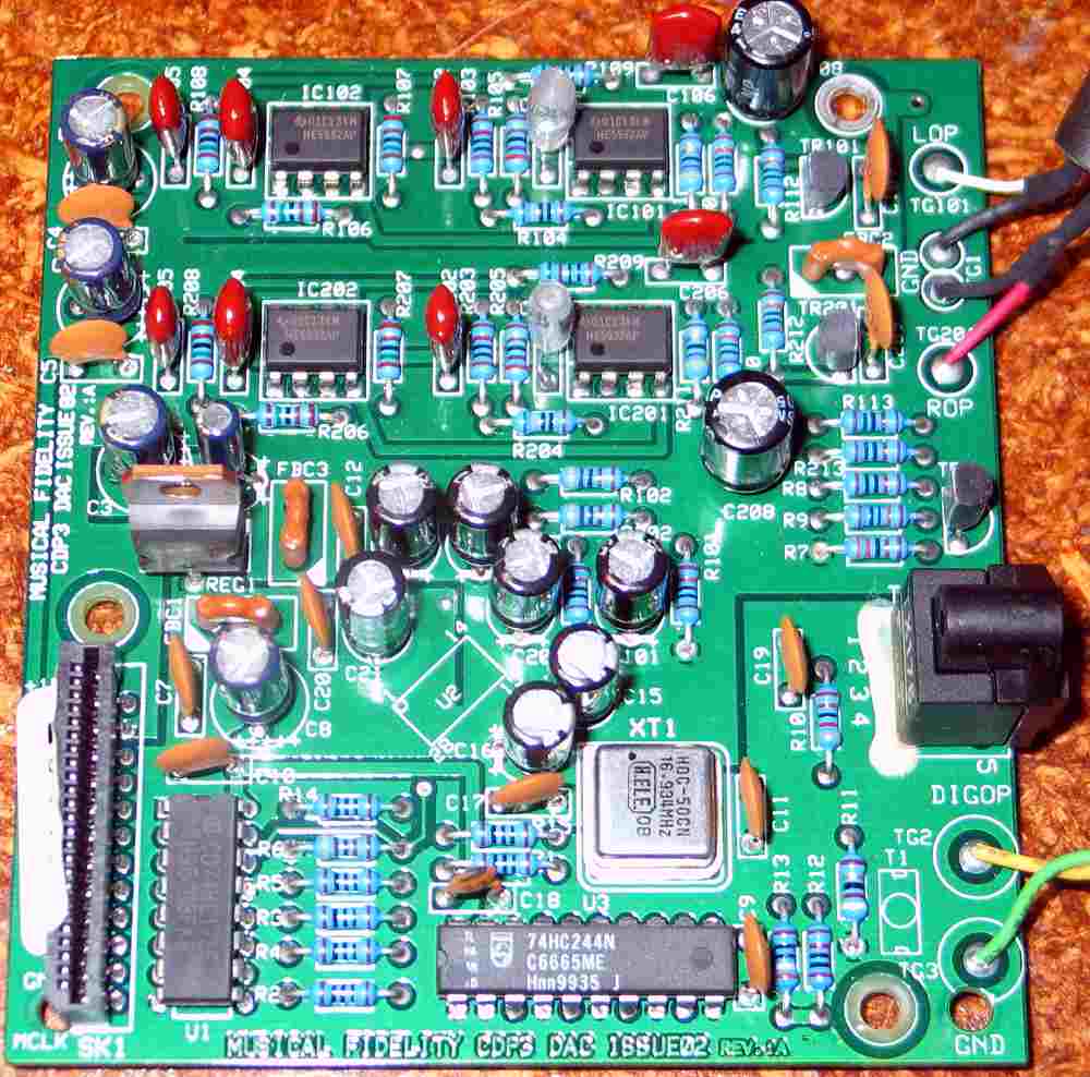

Most are being replaced with panasonic 'FC' or 'NHG'.
DAC and audio out section questions.
General concensus of starget caps ?
Good - bad- don't bother ?
Also, trying to find decent non polars.
Need 47u16v.
Unless I can find non electro replacements that will physically fit ?
Lastly, opamps are 5532's.
Suggested replacements ?

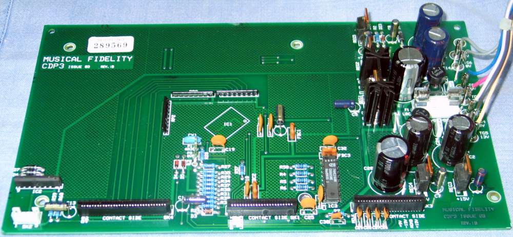

Have finished re-capping the main power/control board.
Will recap the DAC board on the weekend.
OK, job done.
Mostly.
I've changed all the electro's for a mix of panasonic FC and NHG.
Only reason for the mix is availability and size constraints.
If not for these reasons I would've used FC's throughout.
Only two caps I didn't change are a pair of 47u16v NP.
Still need to find a good replacement.
As far as I can tell there is no difference in sound quality after the cap change.
I feel better for being rid of the teapo's though.

Black gates, yes, not the esiest to get in australia I don't think.
I was hoping for something like a poly/foil type cap.
Problem will be finding a low voltage one or one that's physically small enough to fit neatly.
If I'm going to change these two, I want the next step up on electro's.
Opamps, see first post. I do want to change them, just not sure which to use.
These "Burson" units could be possible.
I lived in Wollongong for about 10 years. I can only buy the components in Jaycar and dick smith. You may need to order the Black gate in the web. For the opamps, I only recommend the high end model such as opa128sm/lm, opa627sm/bm, LT1057ACH.
They have different sound depends on what you need. From my experience, don’t use the same model in the I/V section and the output section. Since no opamp is perfect, you should make a combination.
I don’t have a X-ray but I have a X-24K. X-ray uses PCM1716, X-24K uses PCM1728. They have the same output current so I think the output circuit is the same. The expensive combination I use is OPA128SM/LM for the I/V and OPA627SM/BM for the output. It is not bad but I still don’t satisfy with the performance, compare with the PCM1704 and PCM1794. May be PCM1728 is not a high-end DAC.
I also try a cheaper combination that is OPA627 for the I/V and OPA2134 for the output. The overall 3D feel is less than OPA128. OPA627 and OPA128 are single opamp. You need an adaptor to make it dual.
