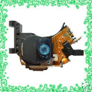

I just want to ask if anybody know the part number/model of the lens of Musical Fidelity Tri-Vista cdp? i cant seems to find the model from the lens itself.. I also dont have the service manual..thanks

No other numbers anywhere on the assy ?
Even a number on the spindle motor may help track it down.
Is it faulty, or just wanting to know for future ?

yes the lens is faulty and needed to be replace...I've looked into the whole lens assembly and could'nt find any part number.. thanks

Not being rude etc, just curious, what made you come to the decision the laser is faulty ?
More often the table motor goes giving the same sort of problem.
Have a look at http://www.wagner.net.au/catalogue/ and download #3 (I think thats the one) it has a list of laser assemblies, most with pics of the assy.
Maybe with a chunk of luck you might find one that LOOKS the same.
Maybe even one with similar numbers.
Although it might not be the right part, it might help narrow down manufacturer.

wow thanks for the links guys.. i think i've found the part number in the wagnet.net site.. thanks Madnutt.. 🙂

I came across this by chance on ebay.
Is it the same part ??
