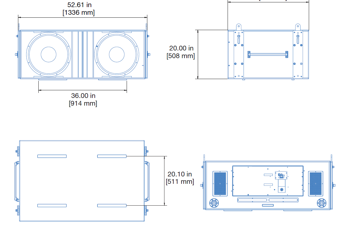

Is this a horn ?
only info i have i that it is a dual 18"
VLFC
Never mind , looks like is just a reflex with very low tuning
BUT.......
how they achieve that low tuning if the size is like of other dual 18's

The specification of +/-4dB from 13-30Hz at 125.dB peak can be met with 113.5 dB in the low range.
The port(s) would have to be long, but it's cross section does not need to be large to meet spec.

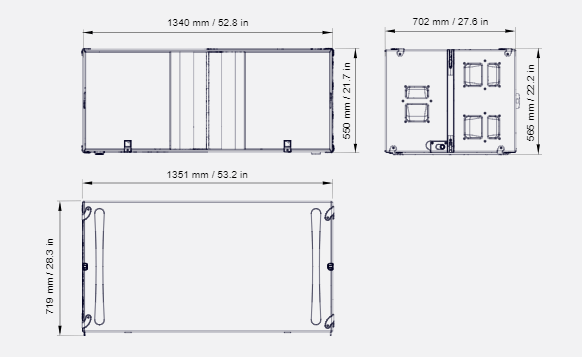

So same size as the KS28 but tuned lower

Yeah, that's the catch isn't it?The specification of +/-4dB from 13-30Hz at 125.dB peak can be met with 113.5 dB in the low range.
So just song ports and the L'Acoustic style vents it seems...
I wonder why they decided to use BR instead of a horn or a bandpass design
At that frequency range, a cabinet of that size wouldn't be able to fit a horn that is able to drop that low with any authority (it would still behave mostly as a ported cabinet). The upper tuning frequency of a bandpass cabinet would have to drop down to 30 - 45 Hz to make any difference, in the same sized cabinet that would take away SPL from the frequencies below that.
It's the size of a standard-ish double 18" BR cabinet, that is typically tuned to 30 - 40 Hz for a good output to size ratio. Instead it's tuned an octave lower. At that size, for PA, the only sensible thing is to put in two very high excursion 18" drivers and give it tons of power.

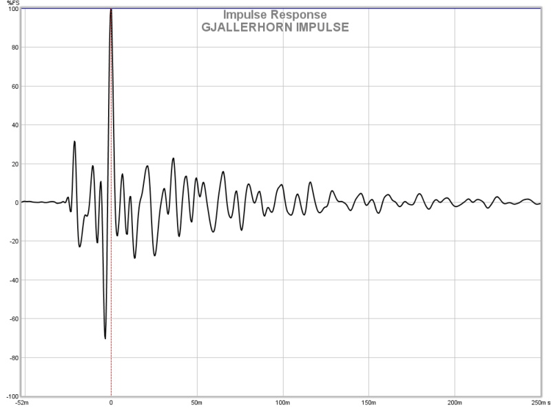

It's worth looking at the step response of various enclosure types and asking yourself how this might affect LF reproduction accuracy. Everyone (hopefully!) goes to great length of building stiff enclosures to minimise resonances, but imagine enclosure walls resonating for a couple of hundred milliseconds after the signal has stopped. This is what I am trying to get at my using the term 'stored energy'; something present in any resonant system which we need to minimise or dissipate very quickly to improve fidelity - low unsprung mass and shock absorbers (dampers), to use an automotive analogy. To my ear, employing a deliberately resonant speaker loading is not pleasing.
Which sub do you suppose would produce the cleaner reproduction of a single kick drum beat, for example? To my mind this is a simple signal-to-noise scenario in the temporal domain, but I am always happy to be educated otherwise.
Hi MrKinky, thanks for the reply.
I really don't think I can say anything about those two impulse responses without knowing more about how they were taken.
It almost looks from the action past the impulse peaks, that the GJALLERHORN doesn't have any kind of low pass filter in place, whereas the 18n862 sealed looks to maybe have one in place. Also I don't get all the gack in front of the GHorns peak. I'd need to go to Ricci's site and read up, to know what to think.

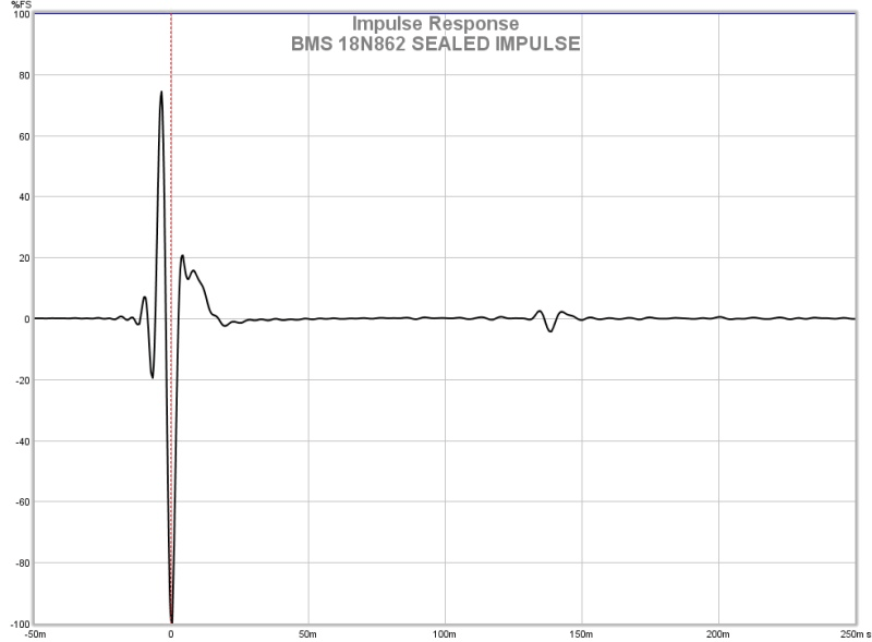

Also, I question comparing a tapped horn to a "vented vs sealed" discussion in terms of the idea of energy storage.
And must admit I'm not a fan of tapped horns, with their drivers butt hanging out playing the higher end, typically having to wait at least 8+ ms for the low end horn output to catch up.

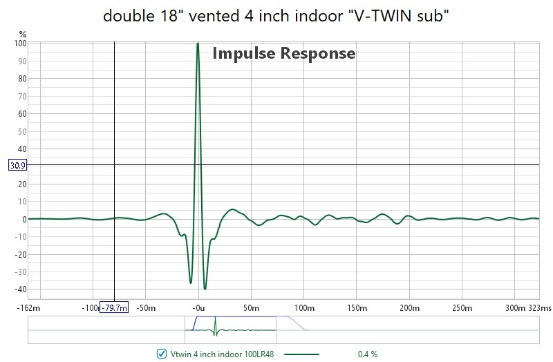

I use the 18n862 in sealed, vented, and dual opposed configs. And yes, the impulse can't get any cleaner than sealed.
BTW, I really like all your sealed subs, in their tube like enclosures !!
Anyway, here is an impulse just taken of my latest sub, a double 18n862 vented, with the drivers facing each other at a right angle. I can it my "V-Twin" sub.
Indoors at about 4" from sub, right in between vent and drivers. Looks clean to me..you?

Define "clean". Any well-designed TH will have lower distortion than a sealed box with the same driver playing the same SPL.
It's also worth noting that the apparent ringing from the Gjallerhorn may well be outside of the intended passband. Do you know if processing was in place for these measurements, or is it the raw cabinet?
All we can say for sure is that the sealed box seems to be better behaved at higher frequencies. That shouldn't come as a surprise to anyone.
