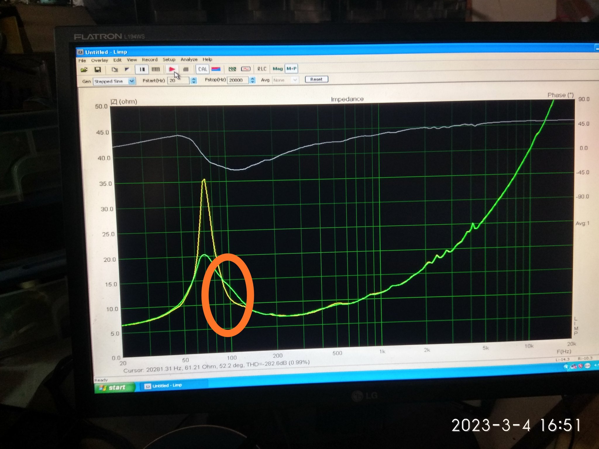

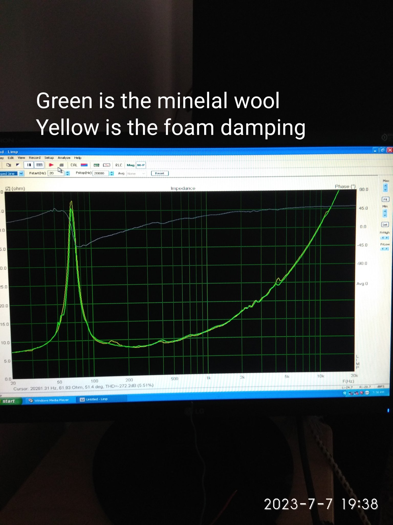

Arta limp is a great method but never i understood what is the goal?
I mean how i can recognise ideal curves?🤔
This will be very useful if someone can teach right way.
