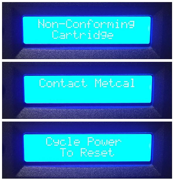

I've got a used Metcal recently, with the MX-H1-AV handle.
I don't know if it's normal or specific issue with my unit, but I'll get the attached error message if I turn on the station while holding the handle in my hand. There is no problem if I turn on the station while the handle is on the stand, and after that everything is working fine, so not a big issue but still keep me wondering why ...

Probably the SWR is out of the ideal range when its out of the stand triggering that warning. The tip needs to be a 75 Ohm load at 28 MHz +/- something or a lot of power is reflected back to the power supply. On very early units that could damage the power supply, for example unplugging the tip with the power on. Once they have the sensor its not hard to add that to a micro to display. You may have an issue with the cable.
