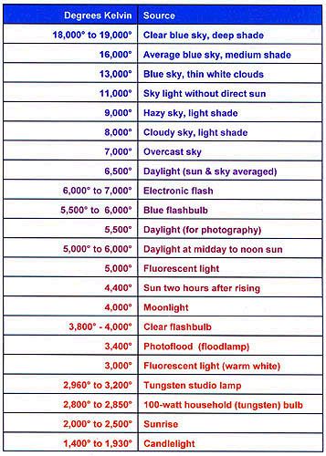

2. What is the best color temperature to look for? Simple question but I can't seem to find an answer.

Projector light bulb color
I am not sure which color is good for projector light.. I guess anywhere between 3800 to 6000 K should be good.
Re: Projector light bulb color
Ok, I found it somewhere else on here. 5500 is the magic number.
rajkumar said:I am not sure which color is good for projector light.. I guess anywhere between 3800 to 6000 K should be good.
