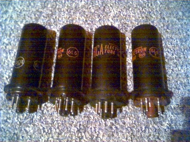

I was recently given a quartet of matched RCA 6L6 metal tubes. They've hardly been used at all, only powered up a couple of times, so I thought something fun could be done with them. One of the tubes unfortunately has a dead filament, so no stereo PP, but a stereo SE (perhaps UL?) should be possible.
I was thinking of building something from scratch, using Boozhound's article as a guide, but if anyone has a complete schematic it would be nice to use as a guideline. The cheap Edcor SE OTs should be a good match, I think.
Now, before I get started and making a complete fool out of myself, are these tubes worth going with? Any suggested schematics?

Voltage should be lower for 6L6G, GA, GB, or metal - 300V should be fine. I would use 1/2 6SL7 or 6SJ7 as driver, as I have a bunch...
Oh yeah - heat pins 2 and 7 on that "open" one - it might be open OUTSIDE the tube...

Beware the metal case of these tubes is connected to pin 1. Some old amps use the extra pins on the tube socket for tie points. The old Stromberg Carlson amp that I used for a stereo in the late 60's used pin 1 for the common connection for all of the screen resistors. I learned this the hard way at exactly the same moment that I discovered that that cool looking Steppenwolf the Second album (vinyl LP) cover was conductive! Make sure that nothing (except ground) is connected to pin 1.
Metal 6L6's can often be found cheap, and can be used in many 6L6 circuits. Just keep the power dissipation and voltages within the ratings. That being said I have abused these tubes (the old Stromberg was one example) to the point of the paint peeling off without failure. Don't plug them into a 50 watt guitar amp though, you can't see the red glow of death, and you won't know that failure is emminent until it is too late. Within these limits they sound a lot like modern 6L6GC's.

If the bassman survived, and the owner didn't complain of loud popping or frying sounds from the speaker (tube arc), the tubes are probably OK. If the amps bias was set really hot the tubes would have been subjected to excess dissipation. Examine the paint for signs of peeling or blistering. Check the lettering. Continued overheating can cause outgassing from the internal metal elements which can raise the tubes distortion and cause a runaway condition due to grid current.

Visually the tubes look perfect, and there were no scary sounds from the Bassman, so I guess they have survived. I was thinking I could check them in my friend's 6V6 guitar amp (just to check if they made any sound at all, not for long periods of time). That shouldn't be too hard on them.
