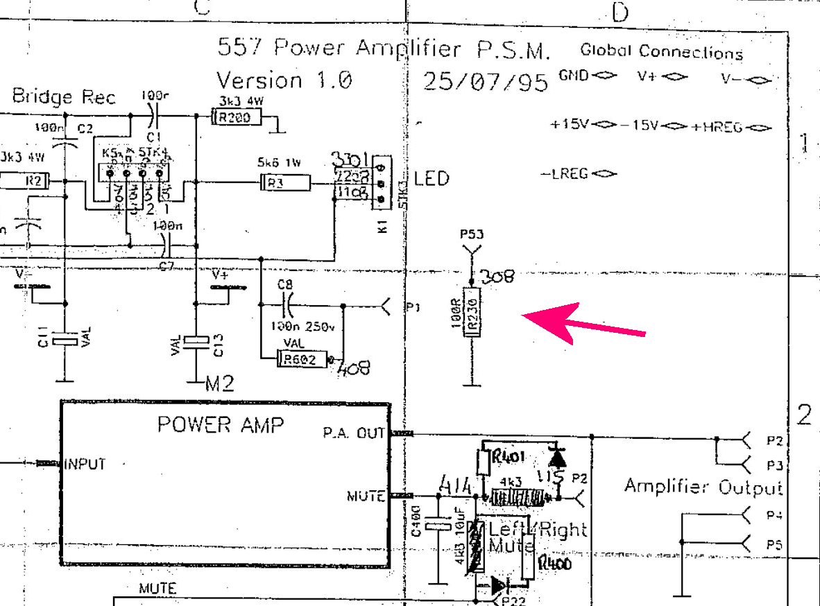

Build a "dim bulb tester", it's a incandescent lamp in series with the load/amp, it acts as a current limiting device so as to limit further damage. Also allow you to do some voltage measurements with unit partly powered up, some of the tested transistors may need a few "volts/amps" before they fail. Can you post a schematic? Look downstream of R230. When powered up on DBT certainly check output and driver transistors...

found link to schematic in above thread, couldn't locate R230...

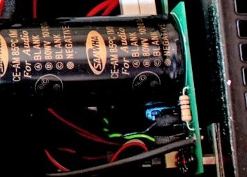

Thanks for help guys and nice to meet u all, ill have to see if I can source an incandescent bulb from somewhere. R230 is connected between ground on the power supply section and the chassis ground, its connected via the black wires to the right hand rca where a few ground connections terminate.
Yes that's the fellow, I was thinking maybe I had a bad ground somewhere ? Output trannys look ok and emmitter resistors are all in one piece, the current resistor for the front led has taken a battering at some point also. I have a sansui au919 that I rebuilt a few years ago that needs looking at I was hoping to put the meridian in its place for a good while ! I found the sui easier tbh n it's a monster !
