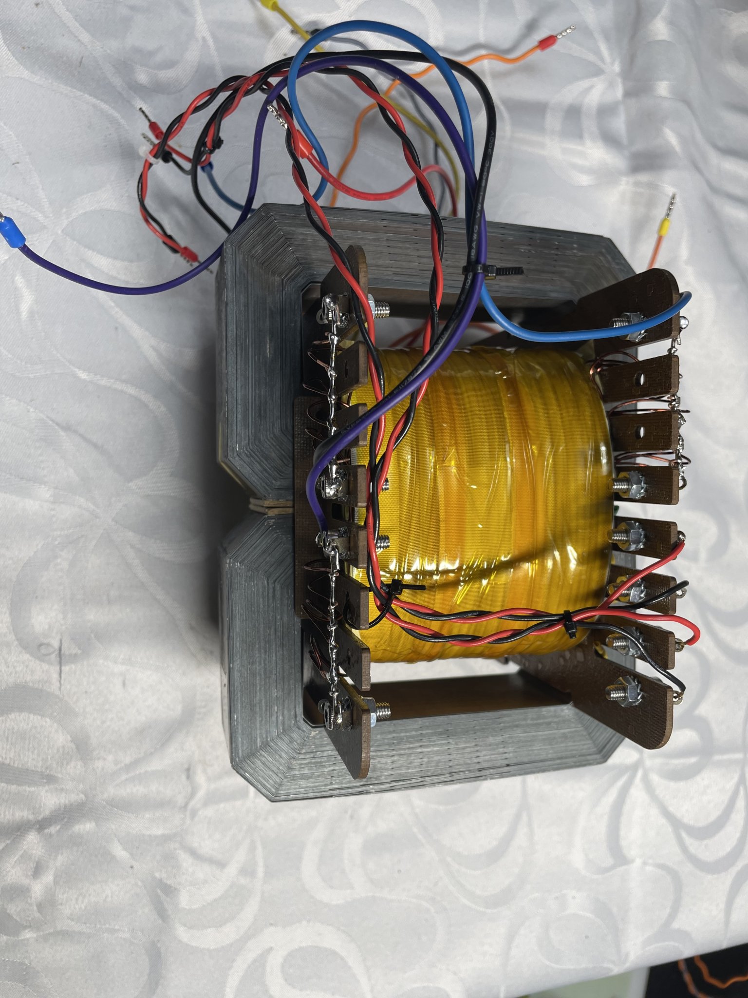

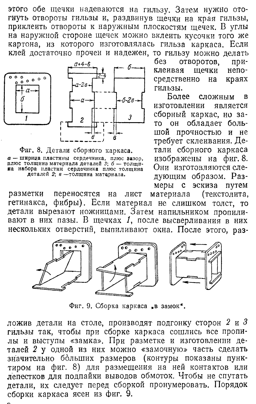

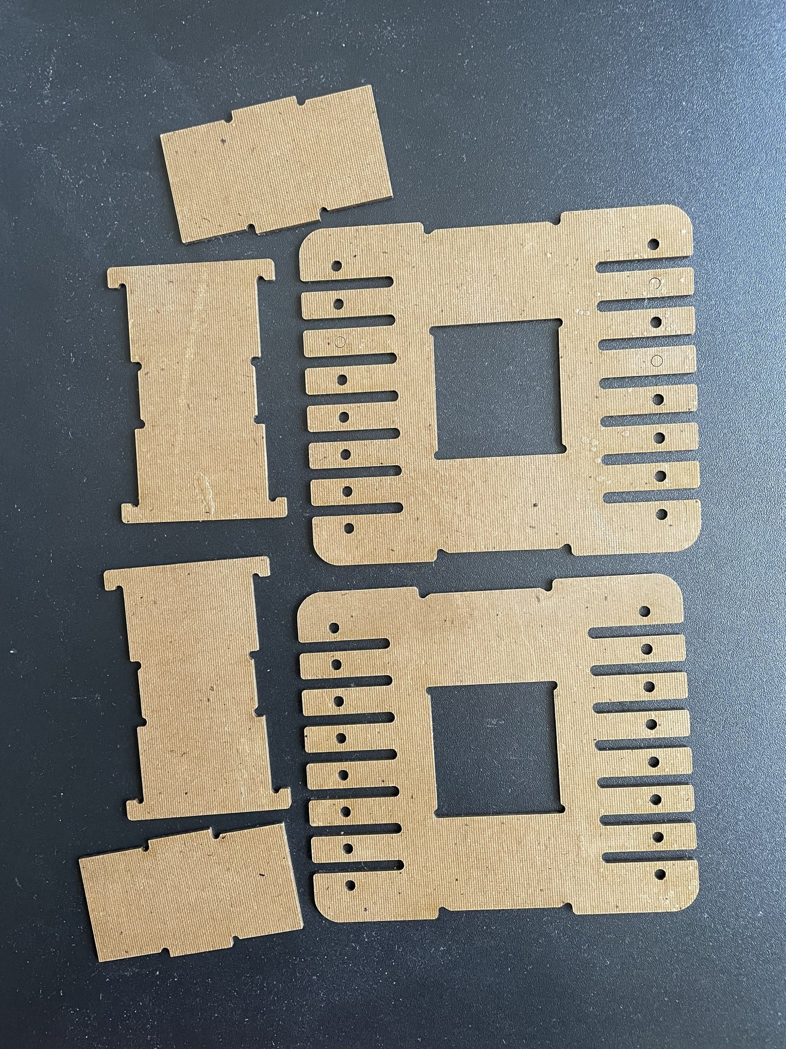

The process of actually winding the transformer in neat layers with the correct number of turns is only one of several parts that can be problematic. Finding the necessary materials is another, and also making safe and secure connections between the windings and whatever the transformer will be connected to.
I would love to find a place that sells metric-sized EI bobbins with solder tags.
You can make them yourself from any suitable sheet material or 3d print. Visual instruction and example attached.

Yes, I've made custom bobbins out of PCB laminates (with the copper removed) but it's not easy to get good results with manual tools. I've been thinking about 3D printing bobbins but I'm not sure they would be durable enough.

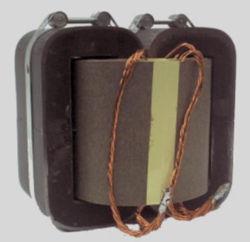

With accurate winding you can use flangeless bobbins.
Four pieces of hard paper around a mold (fitting on your winding machine axis) does the job.
It gives freedom of making bobbins for all sorts of cores.
Pretty much, there is a huge variety of solutions. You can go flangeless with direct wire lead. Or flangeless with short wire lead for panel terminals.
Or you can design on CAD 2D drawings coil formers and cut them by laser.
You can also go flangeless with terminals by insulation strip on the finishing layer (Hashimoto power transformer style)
