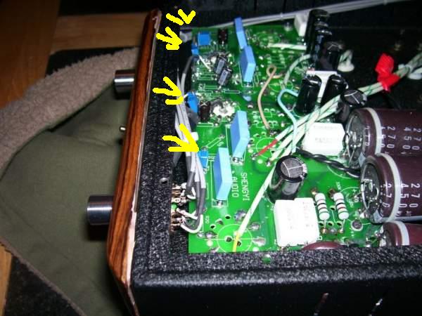

hi i have one of these little amps it is the EL34 version i must say the sound is very good i paid £160 for it. the guy who had it before me had changed the valves but he said he never ajusted the bias. i am hopeing that it is a fixed bais, as i have not a clue were to start with byassing has an y one got one of these amps
all help would make me very greatful
Actually I think you want self biased in this case as "fixed" bias is more likely to need adjusting. I tried to find a schematic for you but google came up dry. I suspect it is probably PC board based making it hard to trace the circuit but why not try to locate the cathode resistors on the output tubes and report back the color code on them?
Be careful of leathal voltages and stay way from those power supply capacitors!
mike
Simple question, are there any pots other than a volume control (if fitted) that are accessible either directly or through small holes in the chassis? If you see no means for adjustment it is most likely that the amplifier is cathode biased and no adjustments are required. (Or possible without mods.)
If you are unfamiliar with tube/valve amplifiers, and it sounds like you are -- you should read the safety and newbies thread here before taking the bottom cover off of this amplifier.

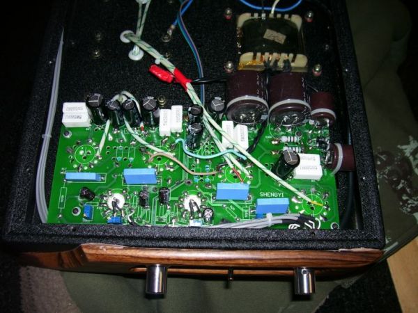

hi there is 4 pots near the front here is a pic

Two of the pots are for hum-balancing the heater supply (one for each channel). The other two pots adjust potential dividers used in the paraphase inverters, to get proper balance (one per channel again). The cathode resistors are big grey ones in mine, though I can't remember the value off hand.

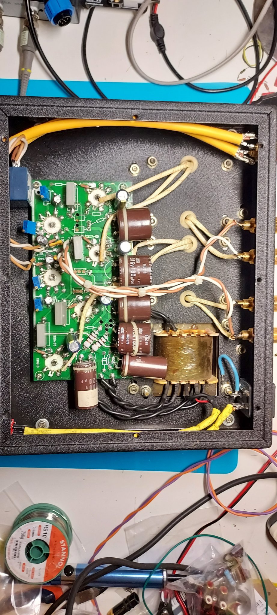

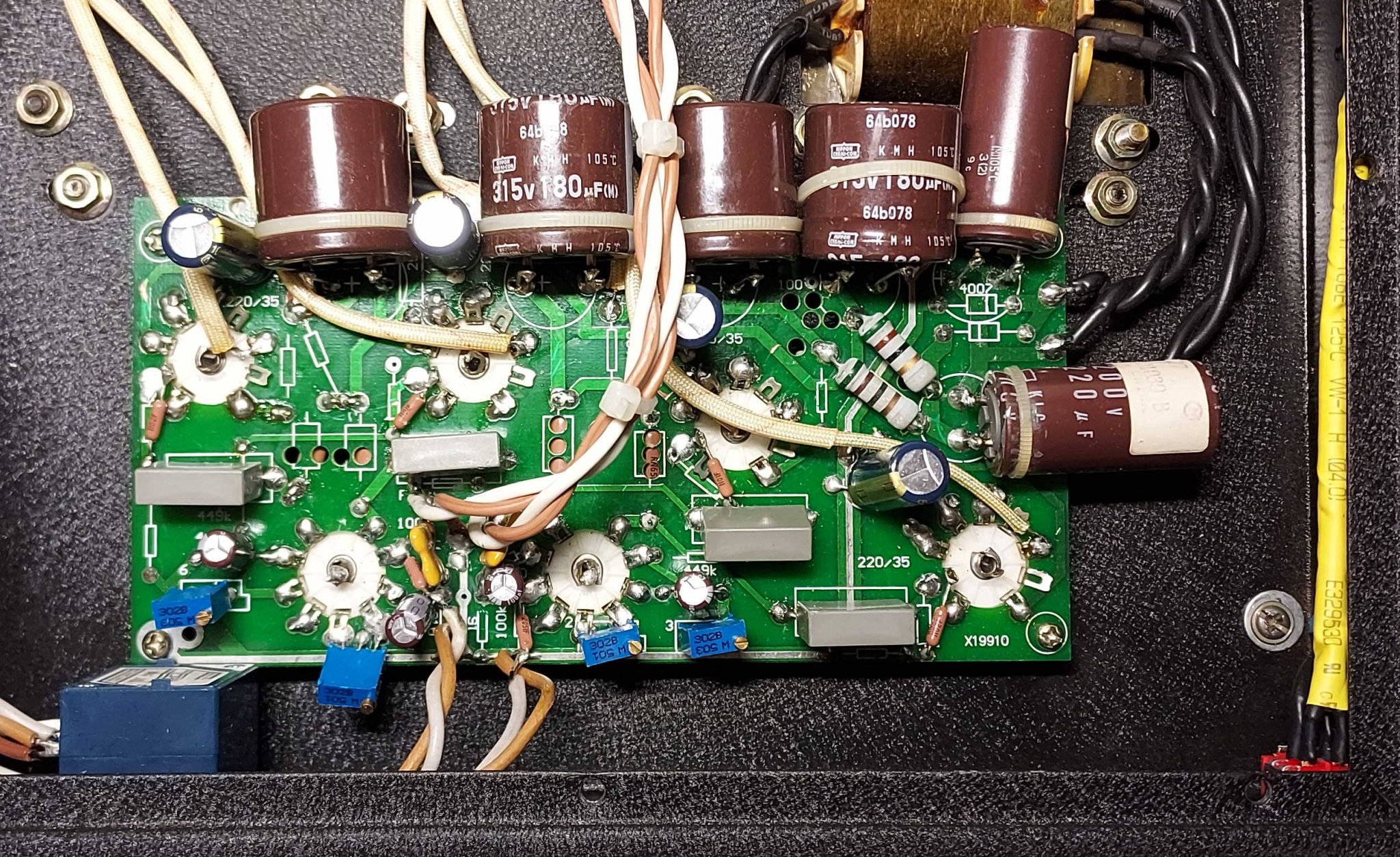

I had one of these forgotten in the closet and I took it out over the weekend, repaired and modified it. Some safety definetely aspects need attention, stability was dreadful, and some critical parts are too cheap and needed replacing. So here goes:
1. Mains power is routed to the front panel power through a signal-type coaxial cable. This violates western world safety standards. In addition, the power switch is mounted in the most unfortunate location electrically-wise, that is the power cable runs alongside the input signal cables. I got rid of the very cheap two-input selector and I moved the power switch to its location, bottom side of the picture. This way the mains cable is far away from all small signal circuitry and cannot induce hum.
2. Next was the cheapest volume pot. Out with that and in with a 100K Alps one.
3. The input signal connector affair is cheap and I replaced it with a pair of some no name-ish teflon parts.
4. Small-signal cabling was unscreened ribbon cable, and it needs to go. I changed the length from the RCA jacks to the pot with VDH D-102 MKIII. The portions from the pot to the tubes, and from the output to the feedback resistors were also replaced with same type cable, shields removed and wire pairs twisted to reduce impedance.
5. The board was extremely dirty with sloppy hand soldering flux remains, which I had carefully cleaned with isopropyl alcohol.
6. The dreadfully magnetic carbon 100K resistors strapped across the input tube grids were removed altogether, as they are in parallel with the pot and modify its logarithmic characteristic. The Alps pot will not loose contact and upset the tube bias.
7. 2K RN55 grid stoppers were added to the inputs, as the amp would oscillate wildly when the pot was turned down.
8. My amp had some 2.2meg resistors strapped from the output tube anodes to their grids. This is something I have never seen in any textbook or even in an on-line schematic. It of course had the effect of reducing open-loop gain, whilst hurting phase margin. Out with them.
9. Two of the four anode load 75K resistors had gone open, so I replaced all four with 75K RN65s.
10. One of the four 220uF caps that bypasses the o/p tube cathode resistors had dried out, so I replaced all four with Panasonic FC 560uF/35V that I had lying around.
11. The EL84s did not have grid stoppers, a clear no-no. Added 4x 1K1 RN55s by lifting pin 2 from the board.
12. Checking stability with a 5KHz squarewave on the scope showed that some, but not much compensation was in order. Paralleled the feedback resistors with 220pF silver mica caps. The optimum value was determined on the bench.

Next was adjusting the symmetry 50K pots with a scope for equal amplitude signal on the output tube grids, and the 500R hum-balance pots. I then performed some measurements.
Comparing open and closed-loop gain shows us that there is some 5.2dB worth of feedback. Reasonable.
Inserting and removing a 8.2R load on the output allows us to calculate the output impedance, found to be about four ohms, with feedback of course. So damping factor is ~2. This makes for a current mode amplifier, rather than a voltage one. So, well-behaved speakers are in order. I hooked up my Proac Studio 120s.
