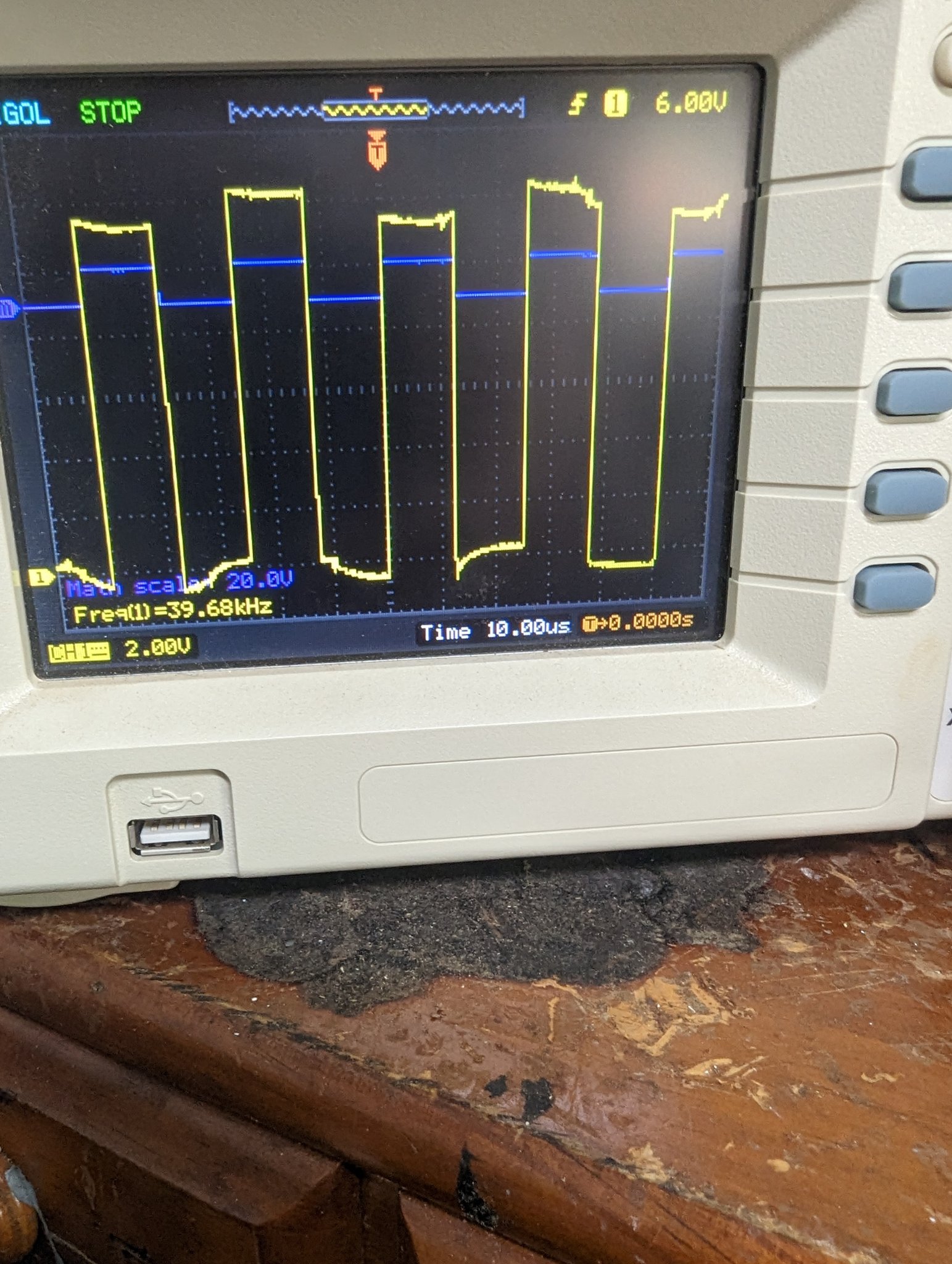

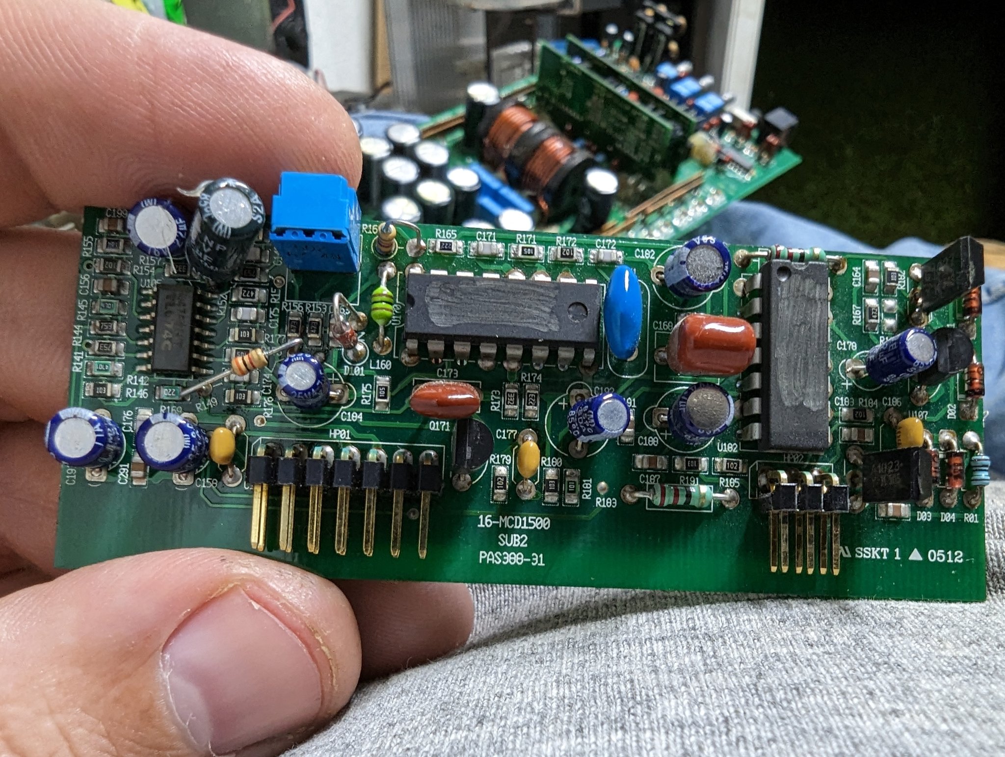

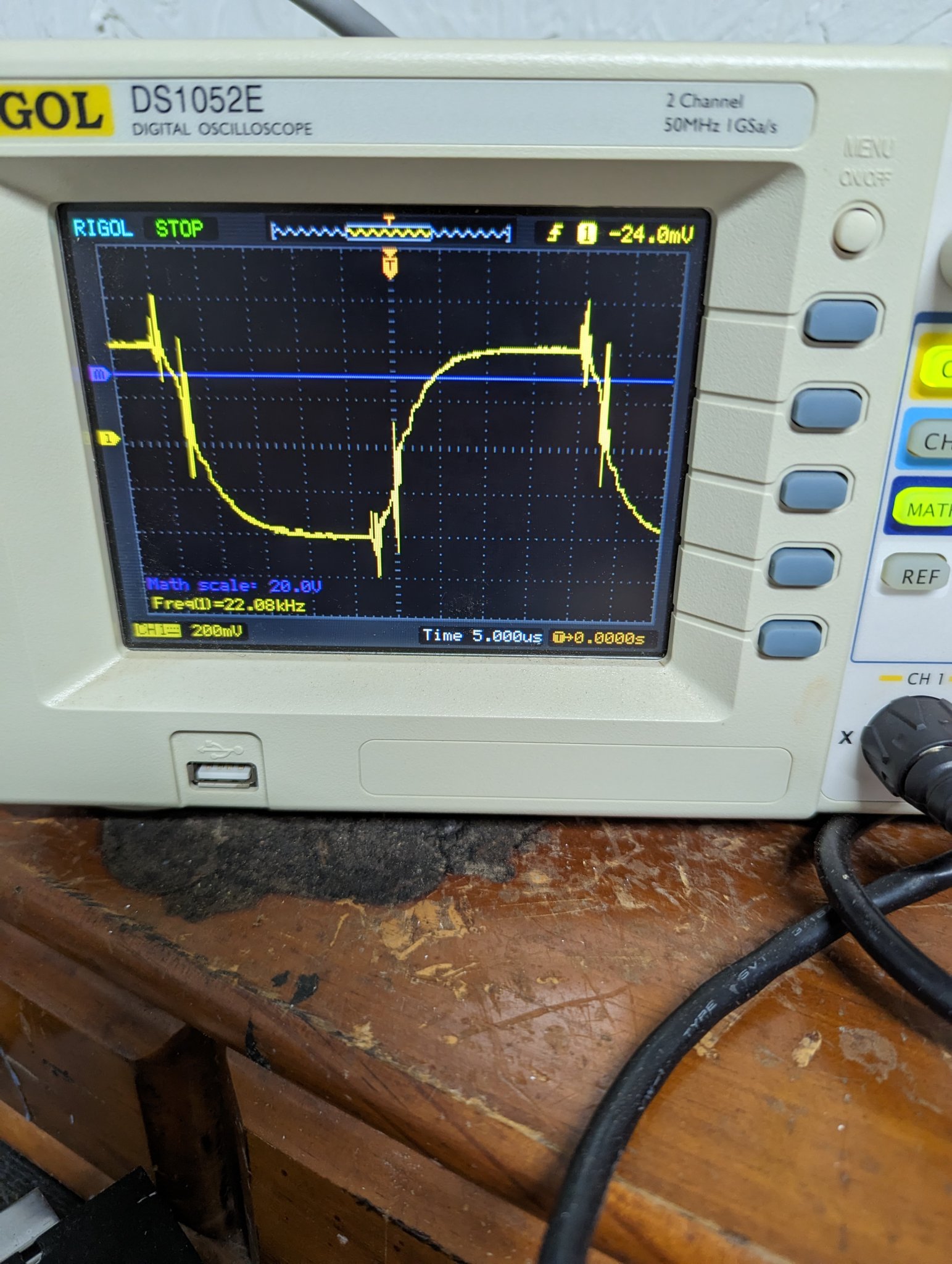

I have a Memphis mcd1500 that had blown up or at least had some bad Ird3205.. I sourced them Nos from out of country .. and replaced all of them and all the ird 640 also the irf 9640 .. the amplifier will power on now no protection light comes on but it isnt receiving a drive signal from the board... I believe it to be the chips are blown but Memphis has sanded off the part numbers .. or if any of y'all could think up something different it may be let me know .. I'd appreciate it ..
I removed all the amp section MOSFETs and rechecked but I have no drive signal ..

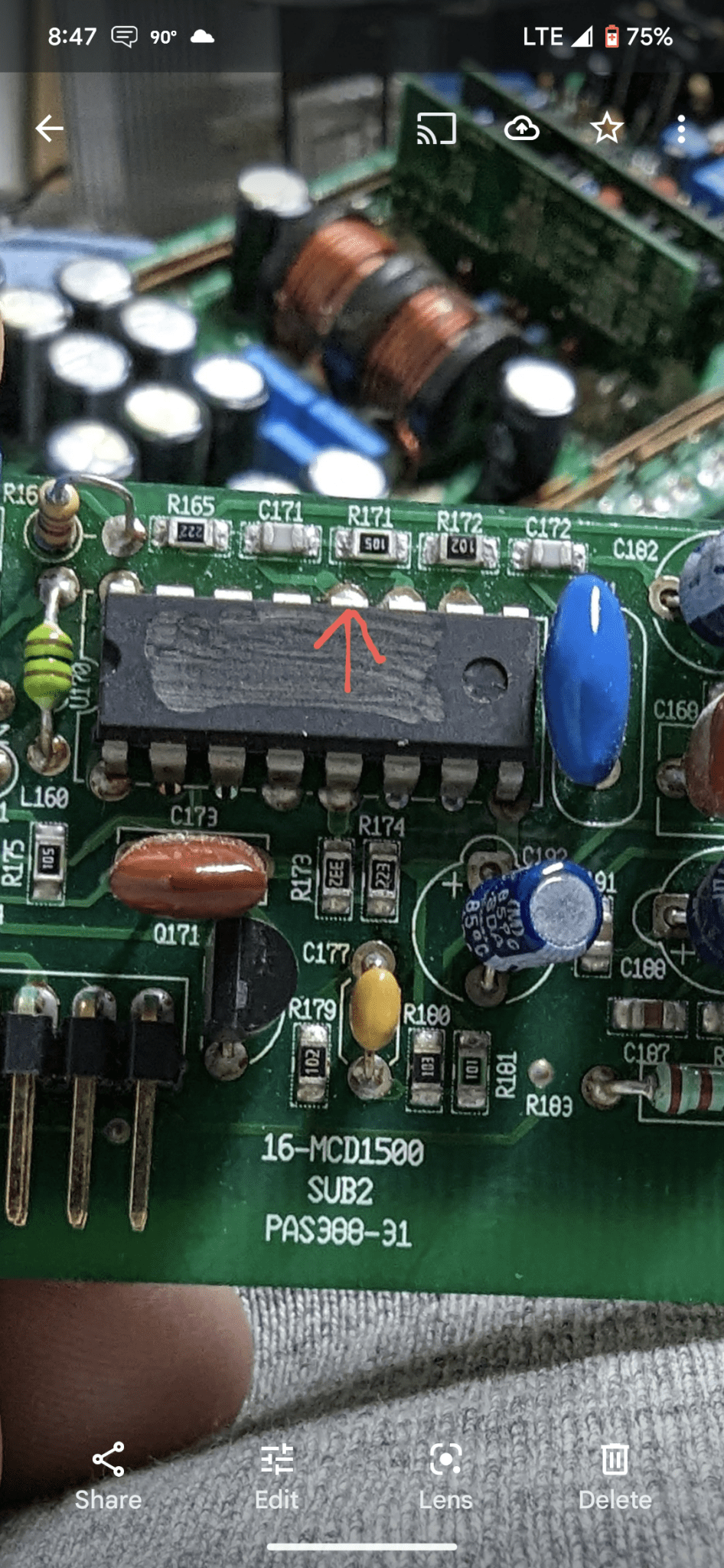

Any idea what the part numbers are in the ic chips??

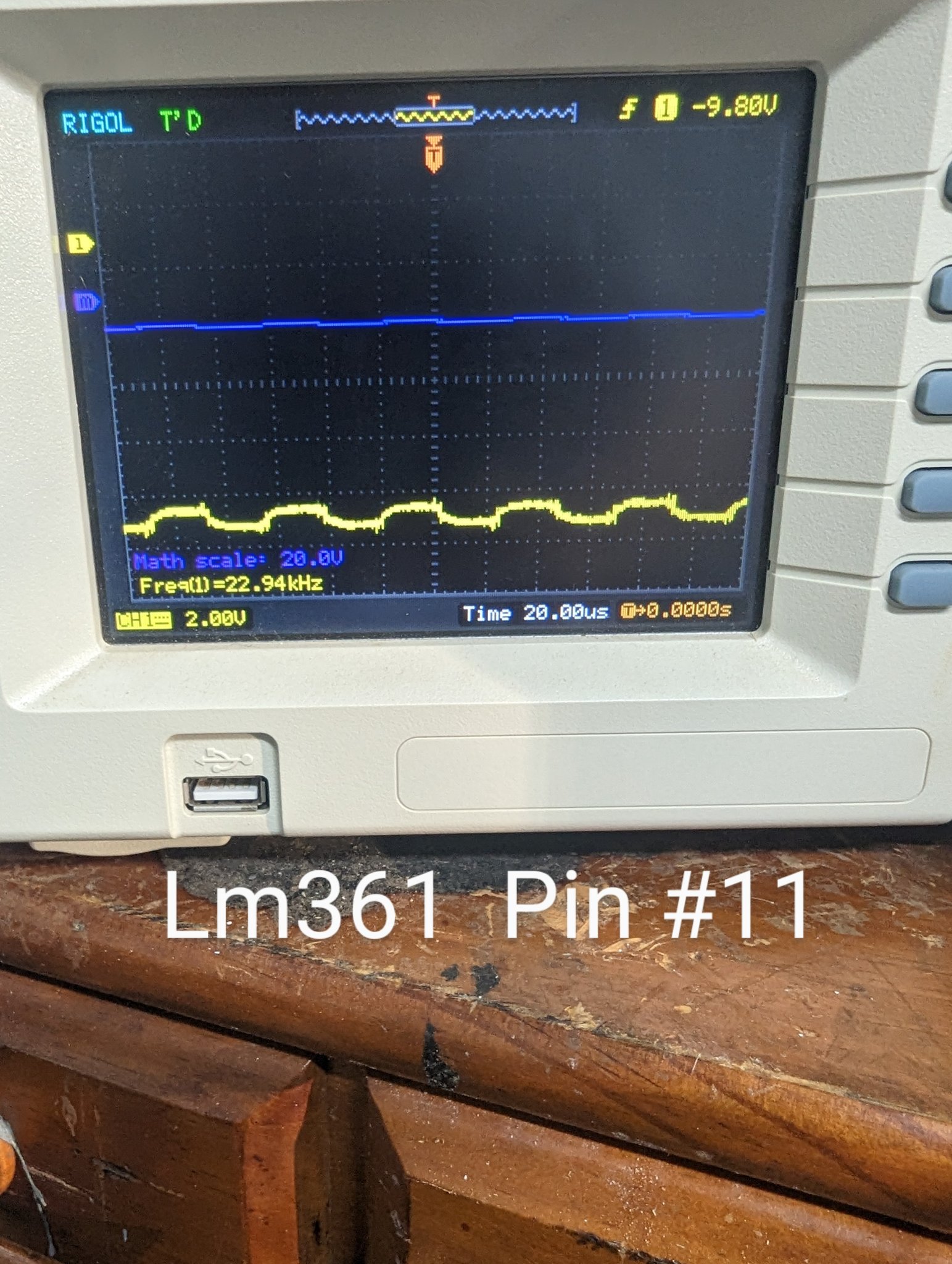

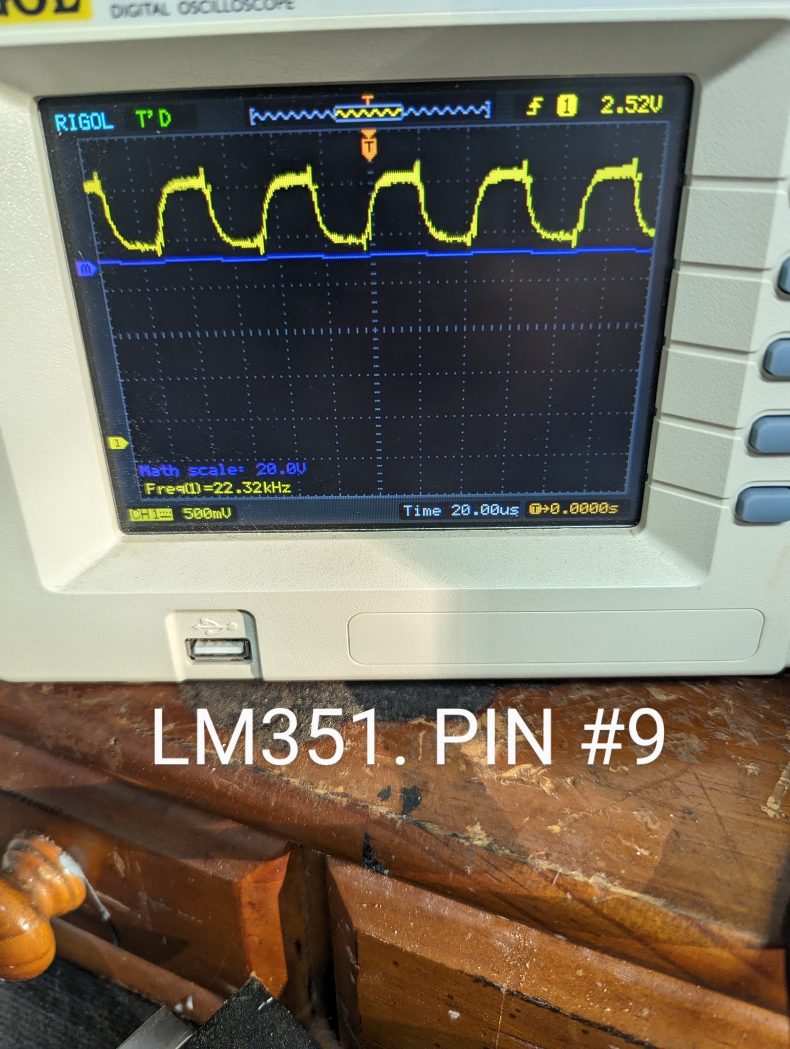

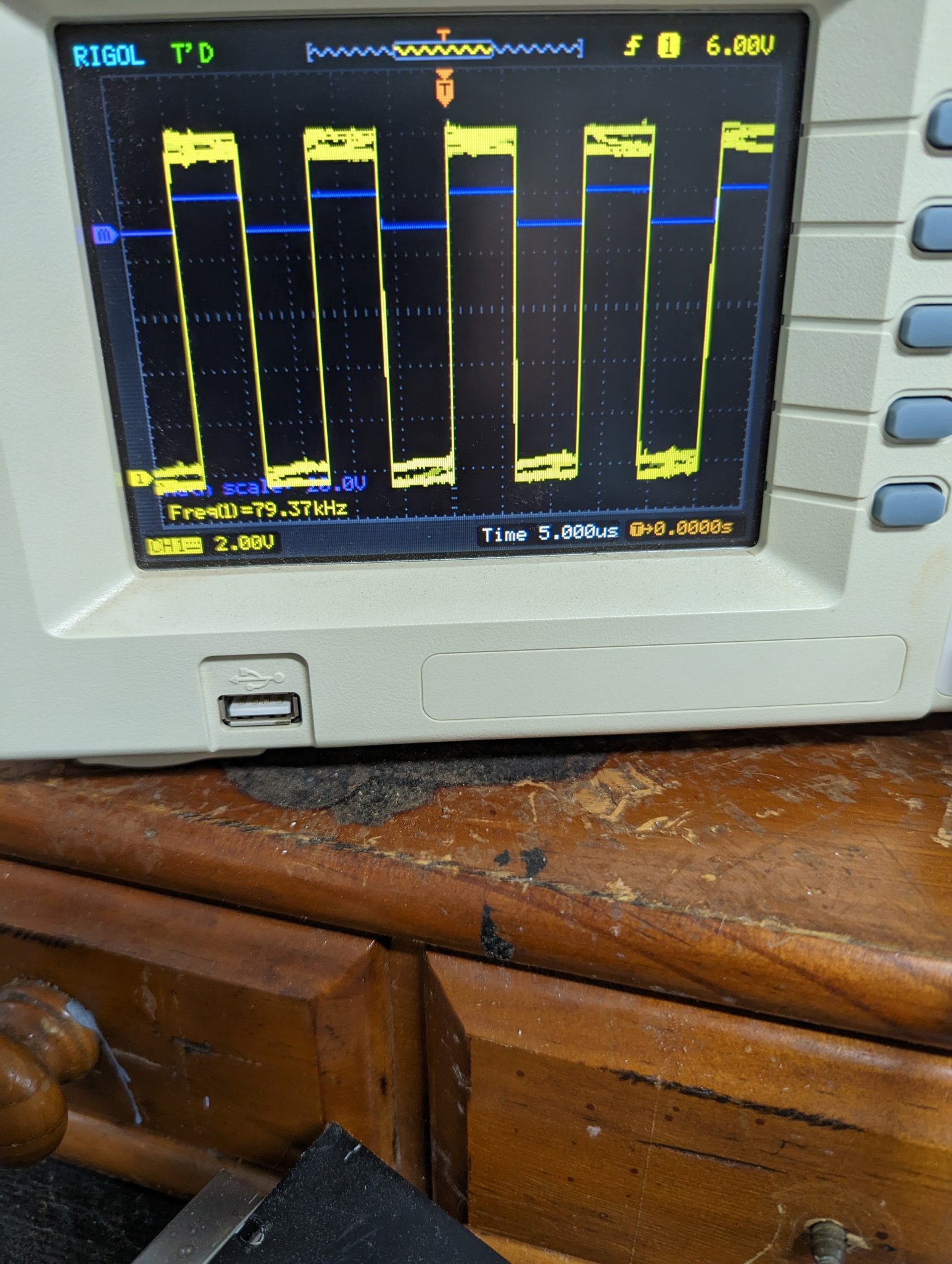

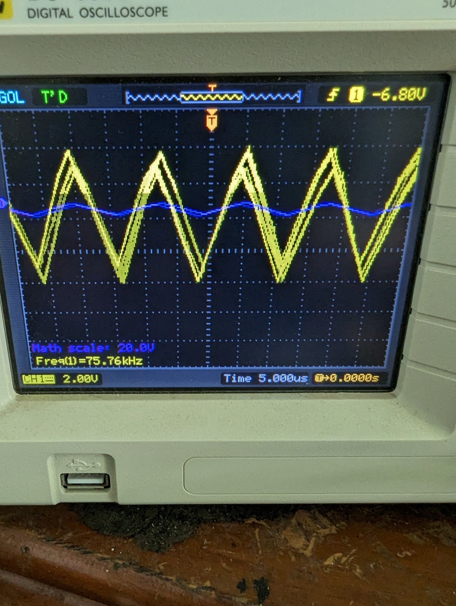

Those are the signals on pin 9 and 11 on the lm361..
I have the output fets uninstalled from the amp at this time.. thanks for the help
