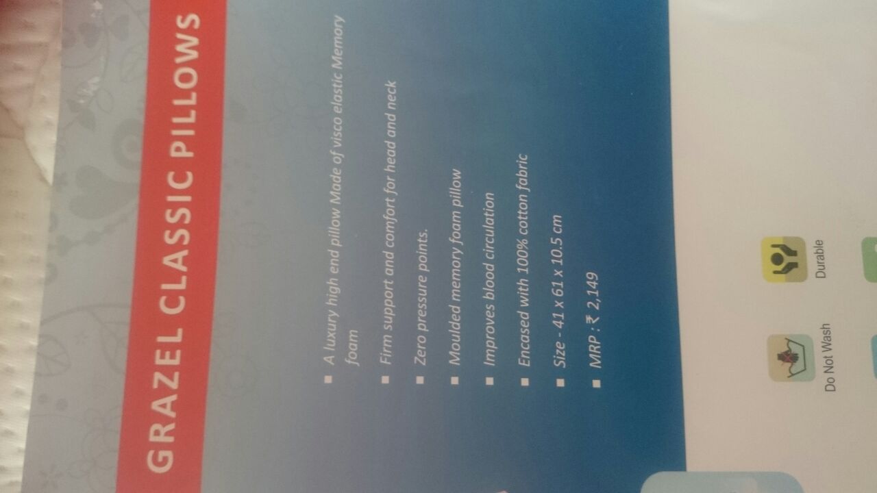

I believe that memory foam is a closed cell foam. So you can put in slabs of it, but you will reduce the cabinet volume by the same amount.
Memory Foam is made of Polyurethane (Memory foam - Wikipedia)
The closest shop has pillows available (which the article indicates is open cell). I don't want to cut across mattresses and sheets are not available.
So am I assuming that it's open cell?
(Polyurethane - Wikipedia)Open-cell foams feel soft and allow air to flow through, so they are comfortable when used in seat cushions or mattresses. Closed-cell rigid foams are used as thermal insulation, for example in refrigerators.
(What You Need To Know About Polyurethane Foam and Memory Foam | Sleepinglikealog.com)…This brings me to viscoelastic foam. You’ll sometimes see viscoelastic foam referred to as “open-cell” foam, but it’s important to realize that both flexible polyurethane foam and viscoelastic foam are open cell. All foam used in mattresses are open cell…

They have a patent for the manufacturing of this pillow material. Saw it on the packing. Led me to this where it mentions open cell: Indian Patents. 219746:METHOD OF MANUFACTURING VISCO ELASTIC FOAM PILLOW
So I guess the only question are:
1) How good is Dacron as compared to Memory Foam.
2) Should I need lining on the internal walls when using memory foam?
