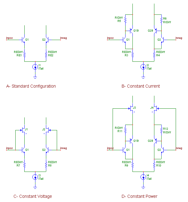

Hi Colin, Nordic,
Let's see if we can avoid another blistering row in this thread!!
I'm not so sure the distortion is all thermal. It's perhaps more related to variation of base/emitter voltage with collector current.
In a conventional bipolar transistor, as you increase collector current the base emitter voltage increase, non-linearly, according to Early effect. This is pronounced with long tailed pairs, and leads to an S shaped transfer function, not unlike the BH curve which defines the magnetisation flux of a transformer.
This S shaped curve means that transconductance of a LTP steadily reduces as an increasing differential voltage is applied to both inputs. The differential input to a power amp is higher than one thinks; if the feedback factor of an amp is 1000, for example (60dB of feedback), then the signal differential between input and feedback nodes is 80mV at 100W/8R output (80Vpp). This transconductance compression is of course dealt with by the feedback network, but it is not eliminated, only reduced.
If you can run the LTP devices in constant current, the Early effect is eliminated, and the transfer function is essentially linear, viz straight.

How do you feel about the writer's opinion, that constant power. i.e. constant voltage AND constant current, would lead to even lower thermal load...
I think some of the claimed improvements are that the peak temperature produced by any one cycle of the signal is shared between more devices, leading to A smaller increase in temp per device, leading to quicker return to ambient temperature...
Once a peak is delivered the device is heated... the problem is that long after the signal passed, the device is not at the same thermal point it was just before the signal reached it... Like you can quickly boil a kettle of water but it will take much longer for it to cool back to ambient if just left to stand...

Nordic,
Constant power is a great idea.
However, consider the electrical environment. If we can achieve constant current, just how much does voltage vary anyway?
Assume a 36V rail, and a 2Vpp signal. This means power might vary from (37 x 1mA) to (35 x 1mA), that is 37mW down to 35mW, with a mean around 36mW. This is plus and minus 2.78%. This is not a large variation, and will not, in my view, result in much variation of temperature on the semi die, particularly at frequencies over 50Hz.

This is an interesting topic, but I am afraid the thread has started out with a few misunderstandings, that are better cleared up for the benefit of the discussion. I am sorry it got much more lengthy than intended, but I also discuss the actual topic a bit.
Presumable you are referring to the topology in figure B, posted by Nordic. The correct term is complementary feedback pair (CFP) or Sziklay pair, not current feedback pair. And to avoid myself causing further misunderstanding, figure B shows a differential pair (or LTP if you wish) with each of the usual two transistors replaced by a CFP. It is not the whole thing that is a CFP.
I am afraid not. You are quite right that collector current and base emitter voltage are related, more precisely they are exponentially related in the first order model. This is the most fundamental property of the BJT. However, this is not the Early effect. The Early effect is the phenomenon that if the base current is held constant, the collector current will vary with the collector emitter voltage (due to base width modulation). So both phenomenae exist, you just got the terminology wrong. (Blame it on a bad day Hugh, I know you know this.)
Yes, while a single BJT has an exponential relationship between Vbe and Ic, a diff pair has an S-shaped relationship between the differential base voltage and each of the collector currents. This is both good and bad. The good thing is that for very small differential voltages, a diff pair is much more linear than a single BJT, which is always exponential. However, as the voltage gets bigger, the diff pair quickly gets more nonlinear than the single BJT, so it is important to try avoiding big differential voltages.
(As a sidenote, this is one of the potential causes of TIM, or whatever we might call it, that due to slewrate limitations, insufficient frequency response etc. the feedback signal is not "fast" enough to keep up with the input signal. As a result, a transient on the input might cause a transient differential voltage that goes far outside the "linear" region of the diff pair. As Leach points out, the input signal should be LP filtered and the amplifier fast enough so this never happens.)
Sorry again, Hugh. I assume you mean keeping the tail current as constant as possible, eg. by using a CCS. As said before, this has nothing to do with the Early effect. However, it also does not essentially change the transfer function of the diff pair, which will remain S-shaped. Rather it will be a more perfect hyperbolic function than if you use for instance a resistor instead of a CCS. The S-shape of the diff pair is inherent to it. Making the tail current more constant impoves the CMRR, which also reduces second-order errors in the transfer function,
First, I hope I am not the only one finding the terms "constant current" and "constant power" inappropriate here. While cascoding, as shown in fig. C, is a method to attempt achieveing a constant Vce of the transistor (and the type of cascoding used in this case is probably as good as it can get without resorting to much more complex solutions), a CFP diff pair has nothing to do with constant current, in my opinion.
The idea of the CFP is as follows. A BJT has an exponential transfer characteristic, as mentioned above. This means that the relative error gets larger further away from the Q point, that is, it gets more nonlinear the larger the current swing. To improve the linearity of a BJT, one of the best things one can do is to keep the current swing on the collector as small as possible relative to the Q current. Often we cannot achieve this, since it would require an unreasonable Q current. The CFP attempts to fix this problem. In a well designed CFP (at least for small signal purposes) the input transistor of the pair has a very small current swing and the second transistor acts as a current booster, which provides almost all of the required current swing. Further, the input transistor should preferrably still have a fairly large Q current despite its small current swing. Then the input transistor will be much more linear than a single BJT would have been. The booster transistor, however, does not get that advantage, since it has to provide the current swing, but this transistor is inside a local feedback loop within the transistor pair, which compensates for most of its error. Hence, it is essentially the error of the input transistor that matters, and this error has been considerably reduced. Generally, a CFP will have lower THD, but with more pronounced high order harmonics in its spectrum, than will a single BJT. So, this has nothing to do with constant current, but with minimizing the current (swing). Saying that it is so low that it is almost constant is in my opinion very misleading.
So here we arrive at what Hugh said:
As I described above, using CFPs instead of single BJTs, we improve the (electric) linearity of the diff pair considerably. That means that even if there is no thermal effects at all, we should expect improved performance (speaking of measurements, to avoid the discussion of audibility etc.).
Hower, this does not rule out the possibility that thermal effects matter too. As I said above, the booster transistor is within a feedback loop and it is mostly the error of the input transistor that matters. Since we have reduced the current swing considerably in this transistor, we have also considerably reduced the power variations, and thus the temperature variations in it. So regardless of whether thermal effects was a problem in the ordinary diff pair, it should be even less of a problem with the CFP diff pair, and cascoding will have a further effect in reducing the power variations.
The question remains, how much of the improvement is due to electrical issues and how much is due to thermal issues? Unfortunately, it seems very difficult to measure the thermal effects since it is the temperature variations of the junction that matters. It is probably easier to make calculations of the expected effect using a good thermal model of the devices, as shown in one of the links. Unfortunately, that example used a TO126 package, which is not so interesting for input stage diff pairs. Finding a thermal model with thermal impedances, not only resistances, for a TO92 package would be helpful here. Does anybody have such a model?
Finally it should be pointed out that CFP diff pairs is not unkonwn elsewhere in the literature. I is mentioned by Self and many others, for instance, although they ususually only discuss the electrical properties, not the thermal ones. CFP diff pairs can also occasionally be found in commercial amps, eg. Halcro.
