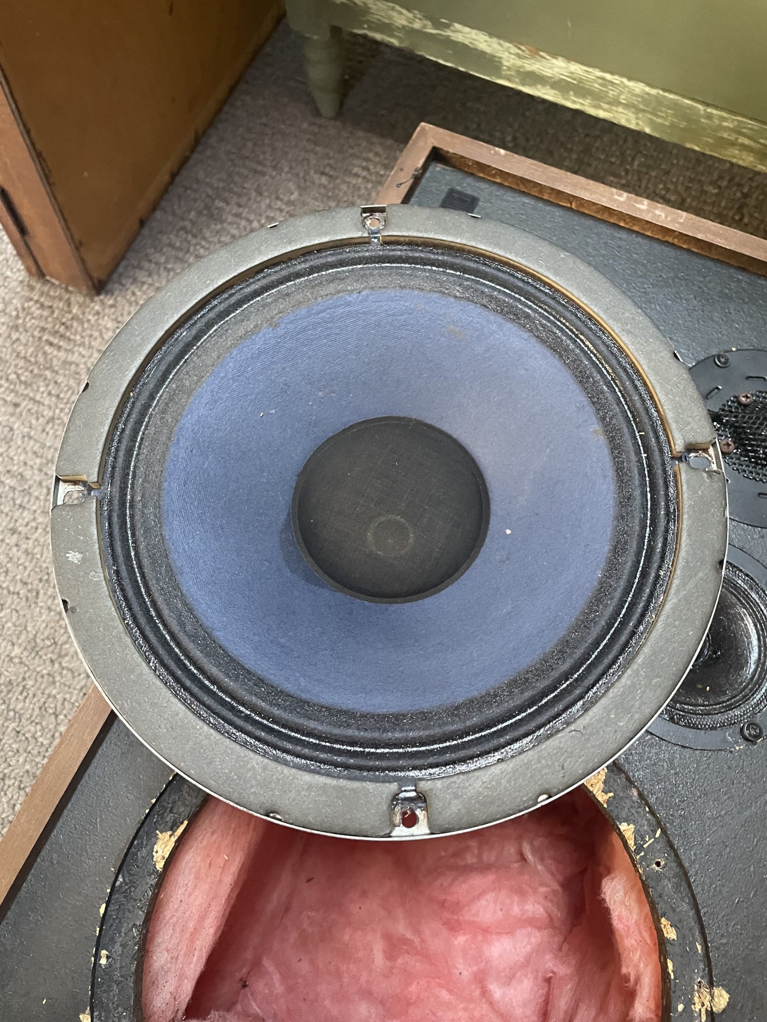

I picked up some more speakers to restore this week.
Interdyn P33 which is a nice unit, when I got there the mid ranges weren’t working and the woofers had been replaced. I nearly walked away but decided the cabinets might be resurrected and/or I could use the tweeters and crossovers as spares, probably too generous but paid $50.
Well….the mids are fine but these have to be the best cooked crossovers I’ve ever seen!

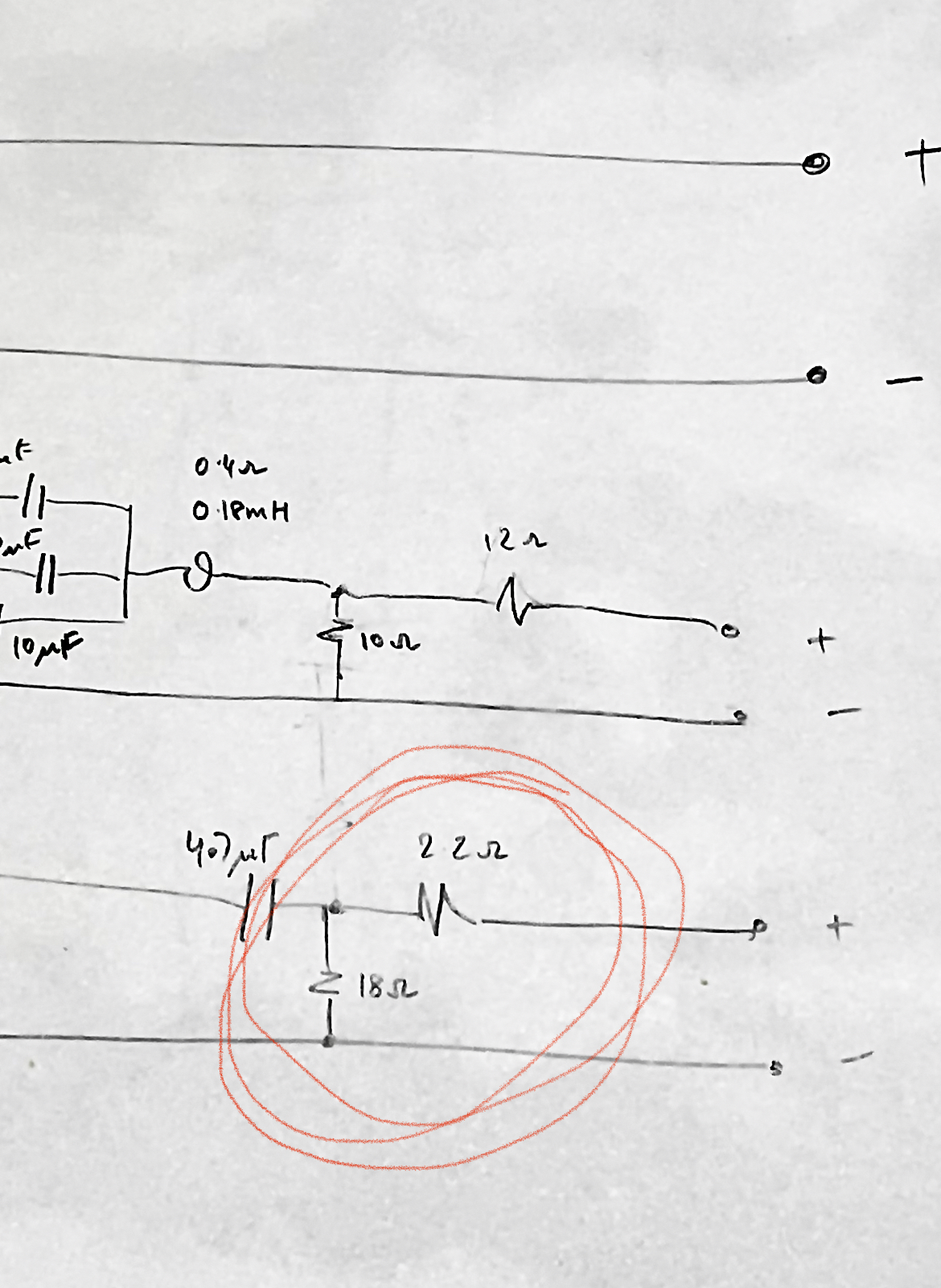

I did what I could to trace the design, I was a bit worried the inductors would be damaged but they both read an identical 0.18mH/0.4 ohm so I might be lucky.
The crossover design looks interesting, first order only with some impedance compensation, nothing at all on the woofer.
Based on the sketch this would be 700Hz/5kHz, can anyone see anything wrong with my assumptions?

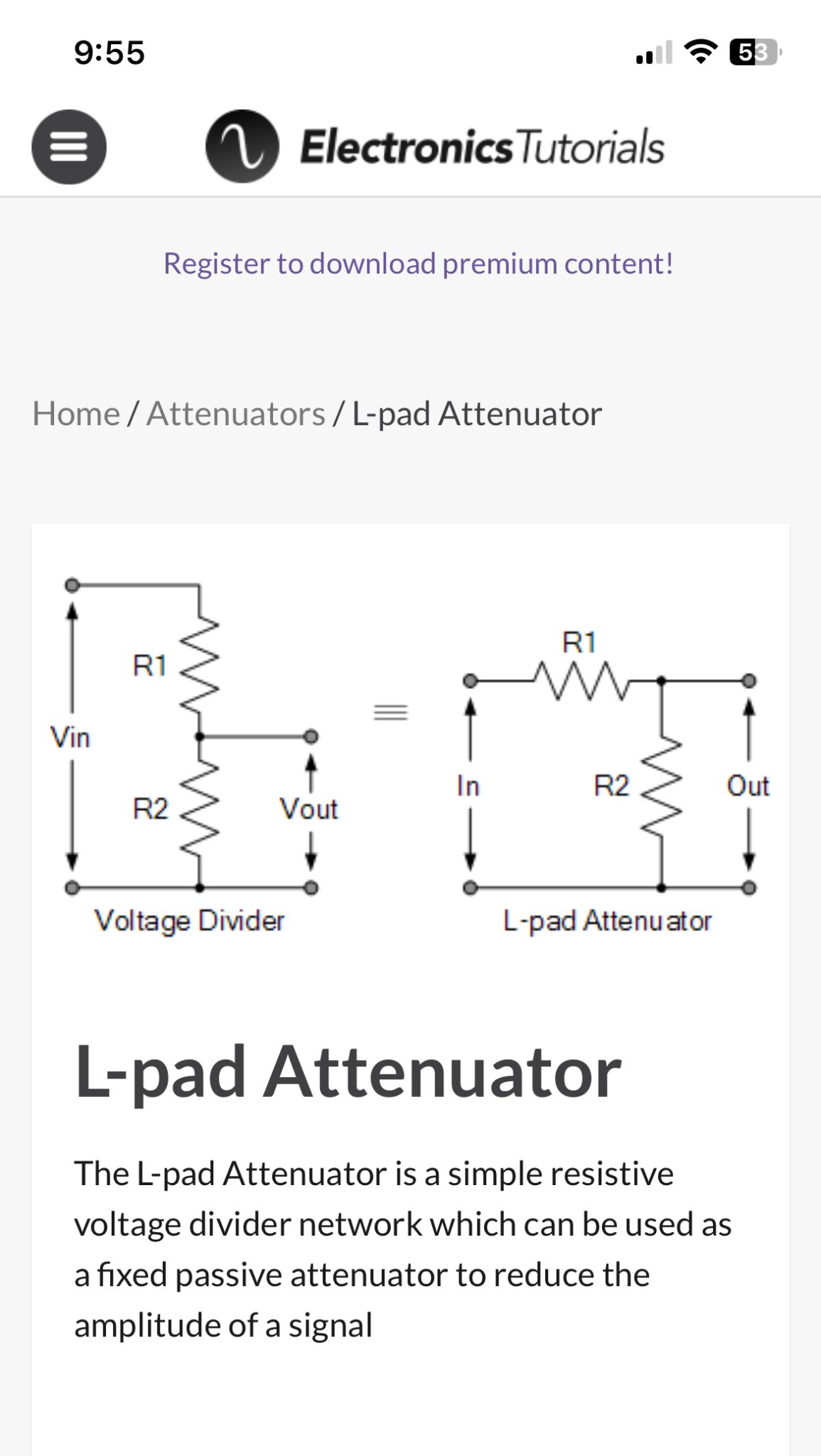

Re the L-Pads, that's not something I have a lot of experience with, but I'm pretty confident on the values and the layout that I've drawn up.
> However - I've done some reading this morning, and looking at this with that understanding, I think there is too much mid range attentuation in the design and maybe some of the values were actually wrong?
Eg
H085 woofer is 91dB. No series inductor either, so full output.
H084 mid range is 89dB. This design has ~13dB attentuation through 2x 5 watt resistors.
H086 tweeter is 89dB. This design has ~3.5dB attenuation, series 5W and parallel 10W resistors.
The tweeter has a recommend 6dB crossover at 4 kHz so 6.8uF is probably more appropriate, but looking at the 0.18mH inductor on the mid and the 4.7uF cap on the tweeter, it looks designed for 5.5kHz but to me there is no need for any attentuation at all given it is already less sensitive than the woofer.
The mid is also less sensitive than the woofer and has relatively flat impedance curve, so why would there be 13dB attenuation? Seems that's why the resistors got cooked...
I've asked the original supplier for the crossover design so I can check...
Maybe I’m misunderstanding something, but the series resistor for the midrange is 12 Ohms.
Interestingly all the big resistors still measure in spec even though the boards underneath were burnt out, but the 2.2’s measure as 1.4 Ohms.
