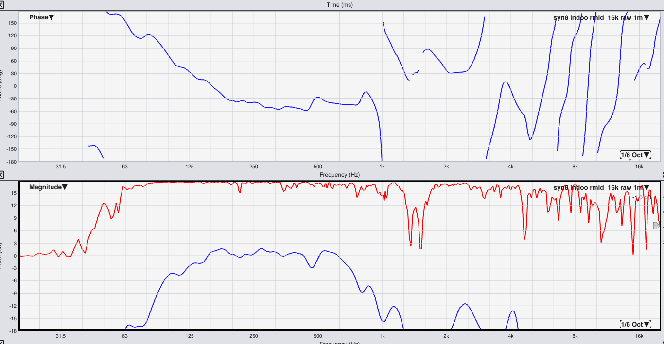

I had reasonable success with the bass reflex output in the SynTripP MEH, but failure in terms of out-of-phase cancellations in the upper passband of the woofer due either to upper port resonance or leakage.Has anyone been able to get a tuned port to work with success in a 2way MEH?
Sold the cabinets before noticing the difference in the upper response "with and without" ports in the early testing.

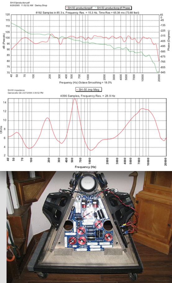

For example, the DSL SH-50 Fb (box tuning) appears to be at 90Hz (the lower impedance minima in the "imp mag" graph) which would normally be the -3dB point, while the low frequency "bump" maxima is at 70Hz.
The Fb that would be predicted with four round port holes only the depth of the horn wall (~18mm) in the net volume of the SH-50 would have a different "end correction" if placed elsewhere in the cabinet. The sidewall braces to the left and right of the ports in the above photo also increase the effective port length.

200/2^2 = 50 Hz Fc
sqrt(50*200) = 100 Hz Fb BP6, so near enough 90 Hz with real world acoustics and the fact that the SH50 is rated @ 50 Hz proves the old adage of 'don't fix what ain't broke'.

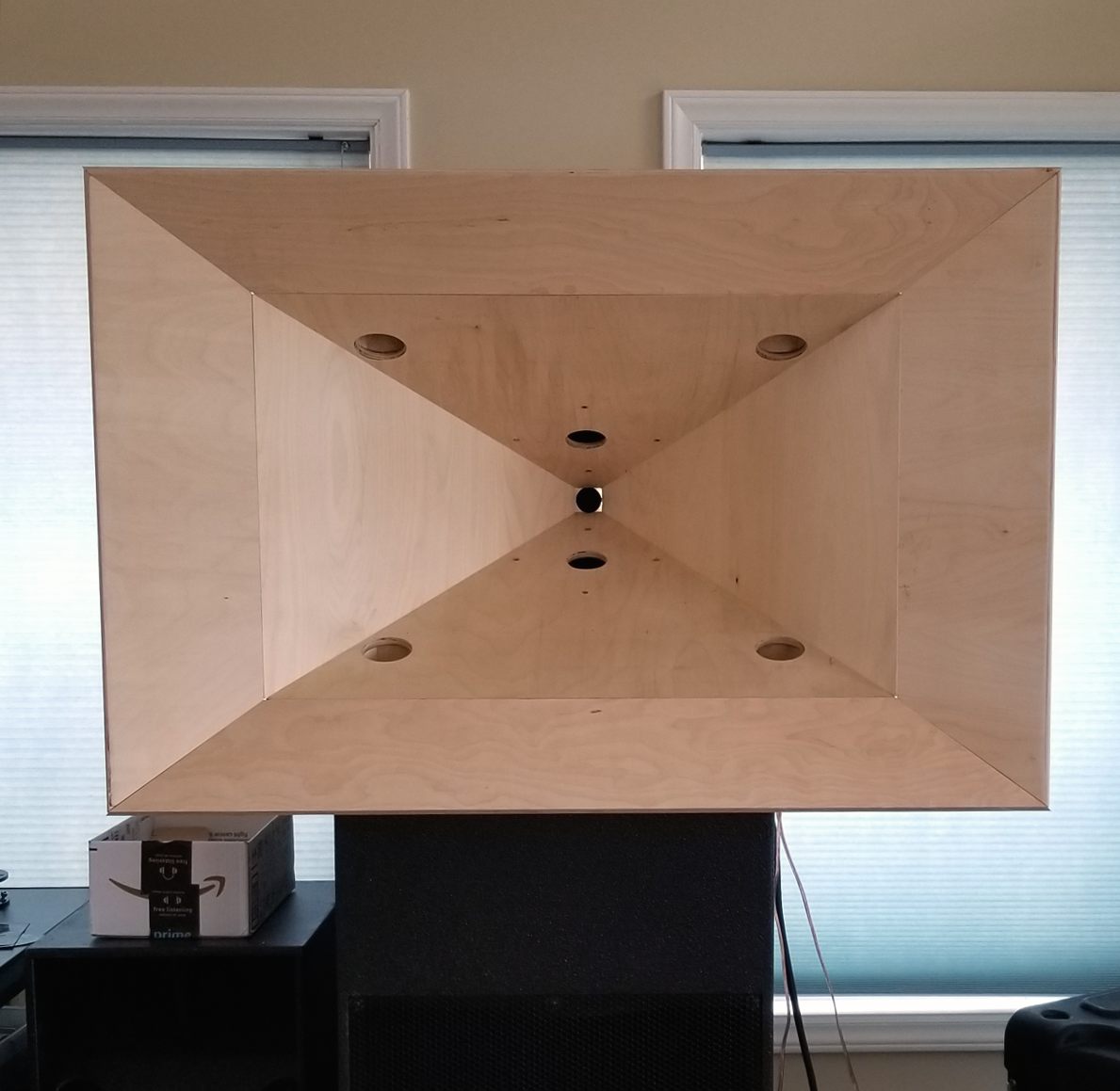

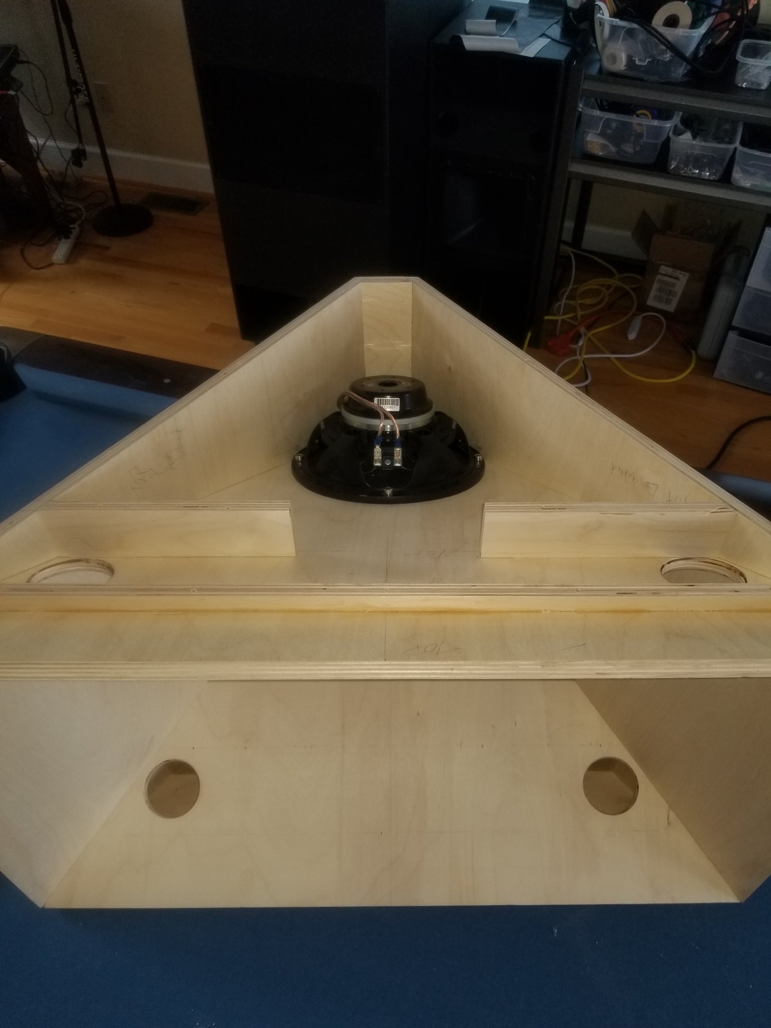

I got it to work with this one.
I needed 8" mid-low drivers to make f-6 @ 100Hz, to reach standard 100Hz sub cross target.
Right or wrong, I figure the ports work somewhat similar to any reflex design........
that some size air duct creates a Helmholtz resonance, and the air volume/cabinet volume determines strength of the resonance.
Just my simple way of thinking about how it works...
Anyway, I played with PVC pipe for ports, but ended up using wood ducts. Easy because a lid seals up both the driver chamber and posts.
Ended up with this before finishing/painting.
Here's the raw response of the 8"s. I don't remember how low the 8"s reached without the ports, just that they didn't get near close enough to hit my sub 100Hz target without adding the reflex ports.
