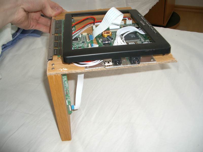

Things are starting to get going here. I'v received my hami display and started taking it apart. Too bad I have to do that though, I'v just started to like it, it is really nice. Well I guess I will enjoy it more when it sits in my projector anyway.

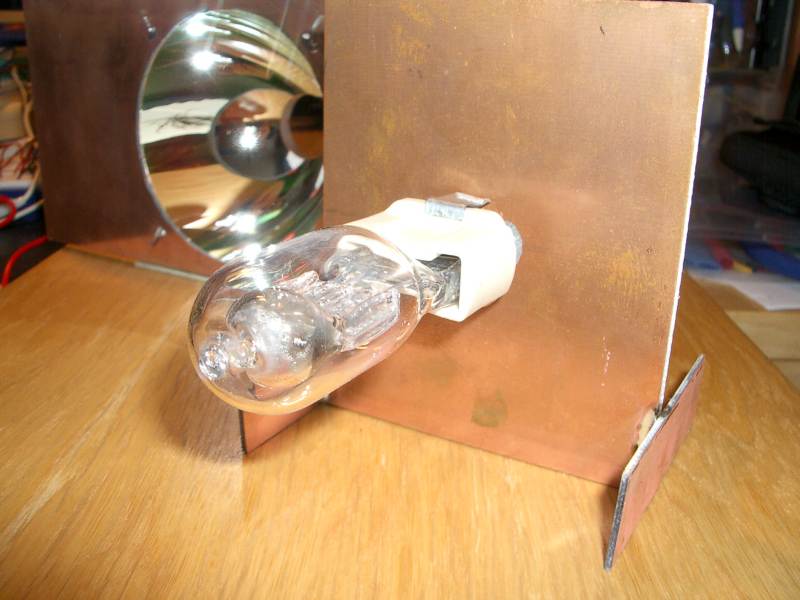

Reflector
Some pics of the reflector setup. I'v got a cone-axis ellipsoidal reflector which means that instead of directing the light to a point it will be directed to a ring. The hole for the bulb were not large enough so I had to grind it up using a dremel. Took a long time, damn that glass is hard. I used som old leftover pcbs to hold the reflector and bulb.
When I was playing around with positioning of the bulb and lenses I had no fan on the bulb so the reflector cracked after a while, although it is still useable, just have to be more carefull next time. Got a fan on it now.
Some results. The image is not as bright as I thought it should be and the colors are wrong. Although messing around with some adjustmens in the lcd might help to at least improve on that. (Colors looks like taken from some old 70's movie.) A better screen will also help a bit, both on brightness and color. I'm using an bed sheet right now.
