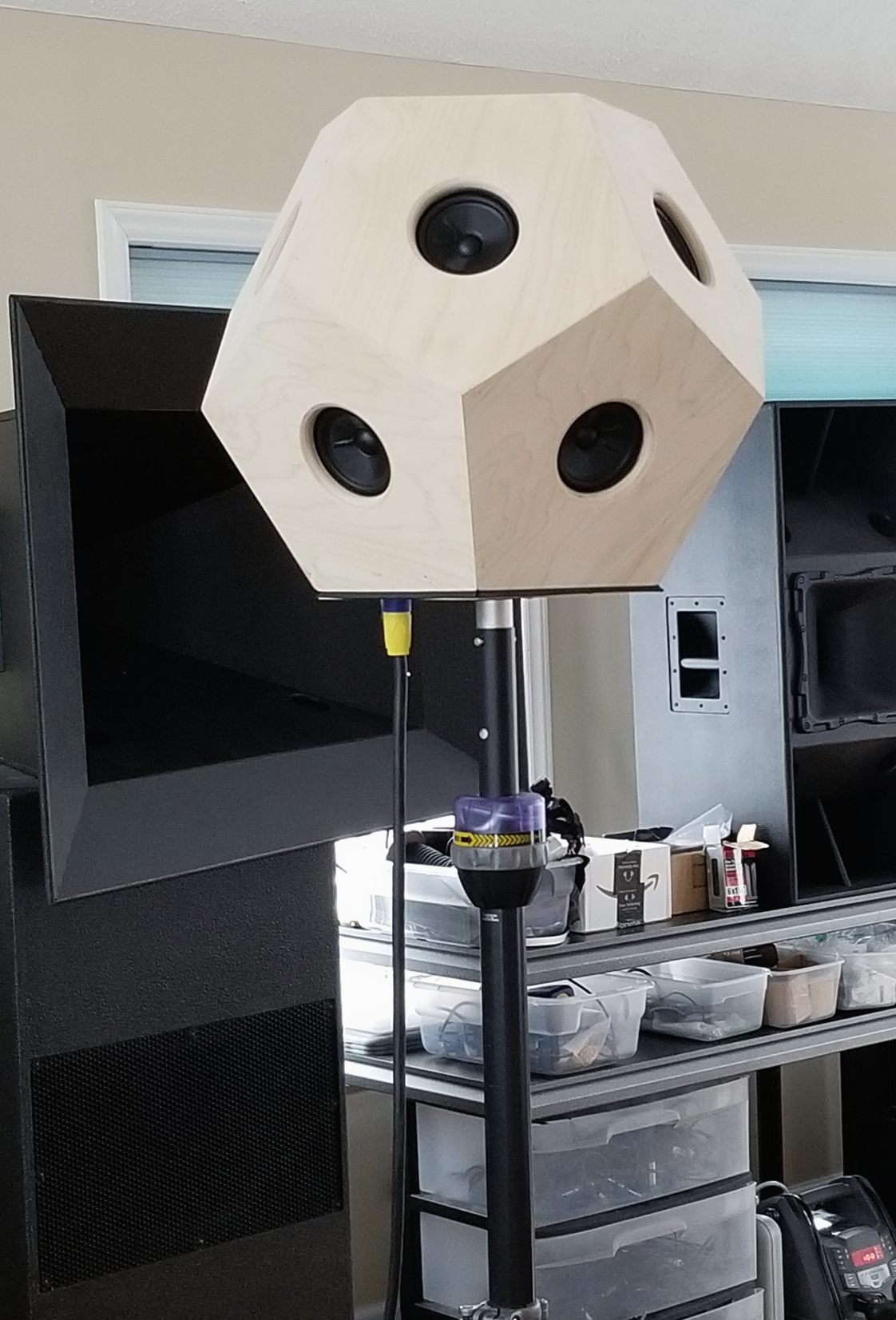

Not often i get to post a build in full range 🙂
Eleven 4fe35's on all the faces except for the bottom face, which has the pole mount and four 2" diameter vent ports.
Has strong response down to 60Hz...time to play with port length etc.
Put a quick and nasty tuning on it...kinda suprised how decent it sounds.
And I've truly never heard anything so even anywhere/everywhere in the room.

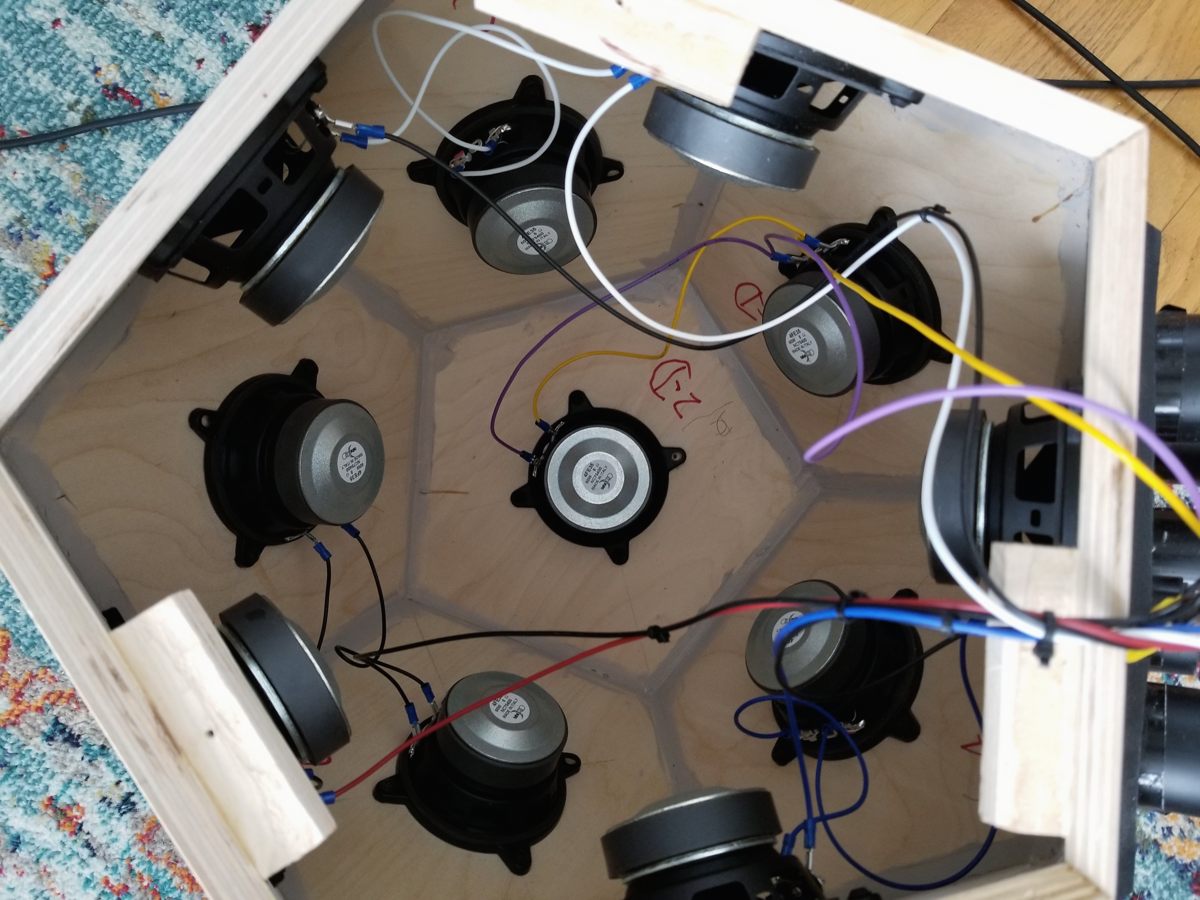

Beautiful woodwork Mark! Can you share build photos of the insides? How is it wired with 11 drivers?

Here's photos of the base and then the inside.
Pretty simple really.
I've wired it using two amp channels. All are 8 ohms.
One channel gets 3 strings in parallel, of 3 drivers per string in series. So 3P, 3S in hornresp speak. The other amp channel gets two drivers in parallel.
I close mic'ed a single driver from each channel to set relative gains.
See a better way to handle 11 drivers?

Although I had made the dodo bigger than was needed to simply mount the drivers, trying to get a little over 4 liters per driver for some bottom end extension..

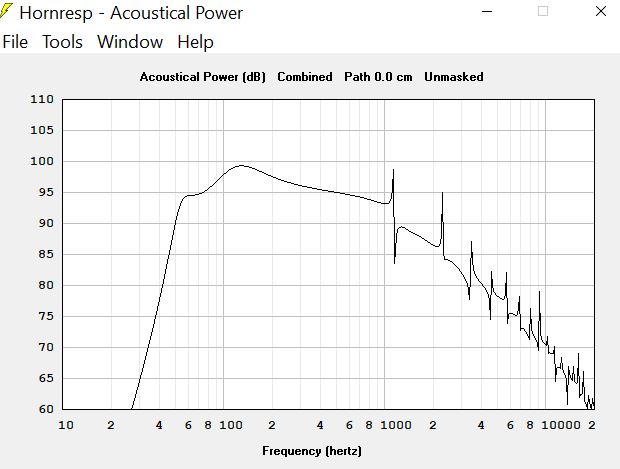

Here's hornresp with the ports i have in the base face.

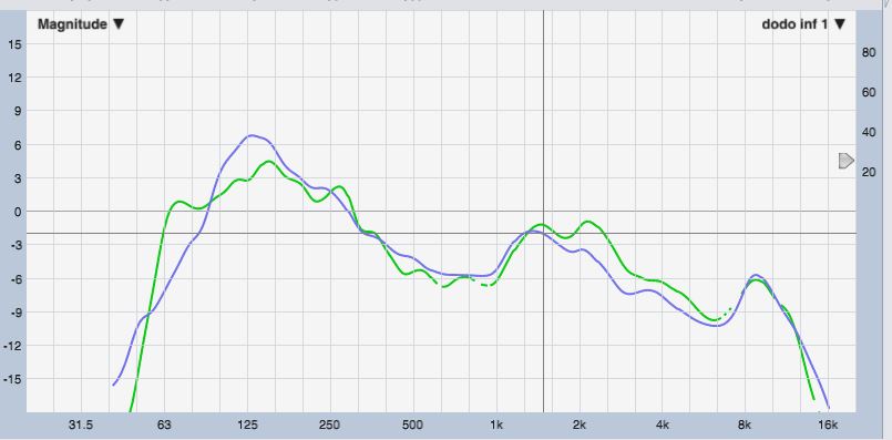

Here's the first measurement i took yesterday in green, that made me think the 60 Hz goal was accomplished. But now I'm not so sure. The blue trace is a moving mic average of about 3 minutes duration.
Heck, I'm not sure of any measurements right now. I have 3 mics all around dodo, averaging, comparing etc.
This may be a speaker that I throw away measurements and just start tuning by ear 😀
