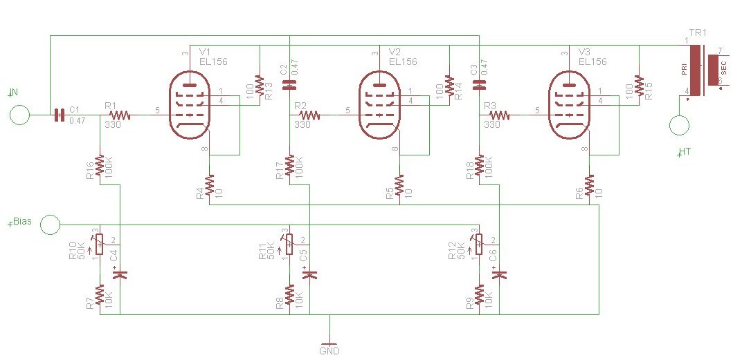

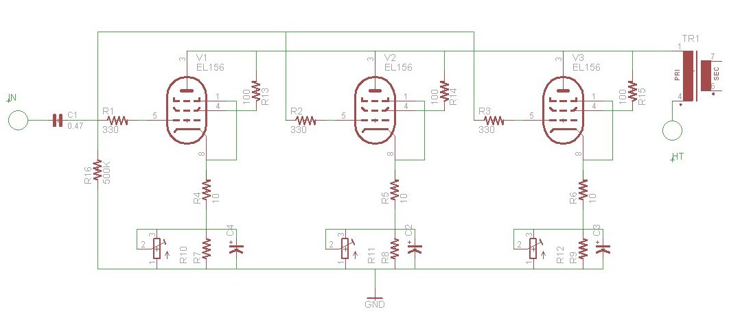

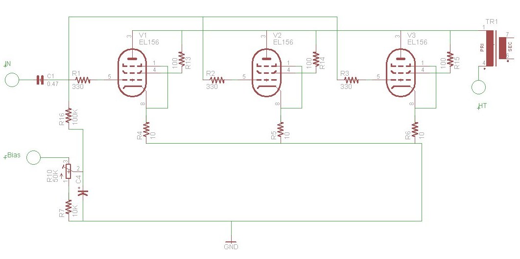

Background:
Recently I purchased an amazing low cost SET integrated amplifier: MP-401 EL156 Integrated Amplifier [MP-401] - $599.99 : Musical Paradise - Audio Art . It's the first SET I owned or listened to and I'm highly impressed by it's sound quality, which, as I understand, is to be expected from good SET amps.
Alas, this amp with it's declared 15Watt doesn't have enough power to drive my speakers to their full ability. Also, in high listening volume it distorts.
I guess I need about 30-50 Watt. Commercial SET amps of such power are way beyond my finances. Being retired, I just cannot buy a commercial one. So, I'll have to build one myself.
The Musical Paradise MP-401 comes with Chinese EL156 and I like their sound very much. I tried Chinese KT88 and Russian (SED) 6550 on this amp and a Push-Pull one and I didn't like their sound. So, the amp I'm going to start with will be based on the Chinese EL156. In order to get more power I'll have to use parallel output tubes.
Question:
Since I have zero experience with SET amps, I'd like to hear from you, experienced DIY'ers: when all else is equal, should I expect degradation of performance when parallel OP tubes are used in a SET amp? (Yes, I'm aware of the fact that the amp's sound quality will be up to the OP trafo used).
Basic decisions:
1. HT of about 420-450 Volt (for maximum OP power).
2. Class A1 operation (for purest sound).
3. Very little local negative feedback (for somewhat reducing harmonic distortion without big undesirable impact on the sound).
The options:
Right now I see 3 basic options:
Option 1: Fixed bias from regulated negative supply, adjusted individually for each one of the 3 OP tubes.
Benefits:
A. Avoiding the dreadful capacitor necessary for cathode bias.
B. Maintaining equal quiescent current for each one of the 3 OP tubes.
Drawbacks:
A. Should the bias voltage change or fail, the OP tubes will burn out.
B. Higher parts count than on the other options, especially input capacitors.
Option 2: Fixed bias from regulated negative supply, adjusted to bias shared by all 3 OP tubes.
Benefits:
C. Avoiding the dreadful capacitor necessary for cathode bias.
D. Lowest parts count.
Drawback: Should the bias voltage change or fail, the OP tubes will burn out.
Option 3: Cathode bias, shared by all 3 OP tubes.
Benefits:
E. The conventional method usually used in Class A1 SET OP amps, safe for the OP tubes.
F. Low parts count.
Drawback: the dreadful capacitor necessary for cathode bias.
All comments and suggestions are welcomed.

I would use individual biases but a single cap driving all the tubes (actually I'd allow space to 2 caps in parallel) - allowing for interesting combos.
Do you mean individual fixed grid bias as in my first option with the 3 grids fed from 1 input cap? In such a case it will be impossible to match the idle current between the 3 tubes, since all 3 grids will be DC connected and will see the same bias.

Oh I see - sorry I assumed you were biasing via the cathode for some reason, either way you need to be able to set each tube individually, and somehow I'd work to avoid the multiple caps - the easiest is 3 caps though I guess, unless you use a bigger grid stopper and 'bend' it with a bias adjustment. I'd be tempted to work out a single bias control, with balancer pots for each tube so you can experiment with different bias positions easily.

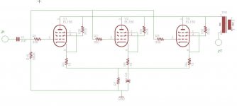

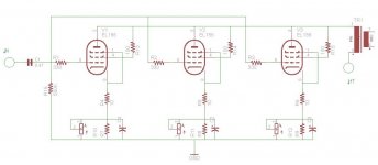

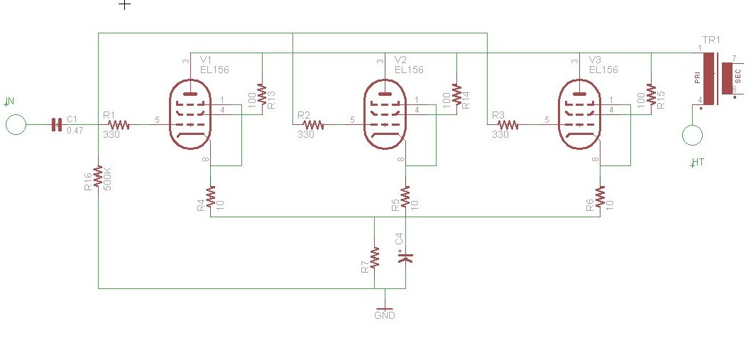

In any biasing scheme, each of the parallel OP tubes need be biased separately.
With cathode self-bias, I'll need 3 electrolytic caps to shunt each of the 3 cathode resistors. Those electrolytic caps I prefer to avoid, if possible.
With fixed bias, should there be only 1 cap feeding from the driver stage, the 3 grids will be DC connected, no matter what I'll do, thus it will be impossible to set individual bias to each OP tube.
Actually I'm left with 2 biasing options. Schematics for those options are attached below.

Ok - I think I'd use the first schematic, so as to avoid cathode capacitors.
For the biasing, I'd only have one capacitor for the bias circuit, not for each pot. For each pot however I'd put a bleed resistor down from the pot centre to ground, so any pot noise cut the tube off instead of leaving it floating.
As you are driving 3 tubes now, I'd also go for a meaty driver like a 6n6p or something..
