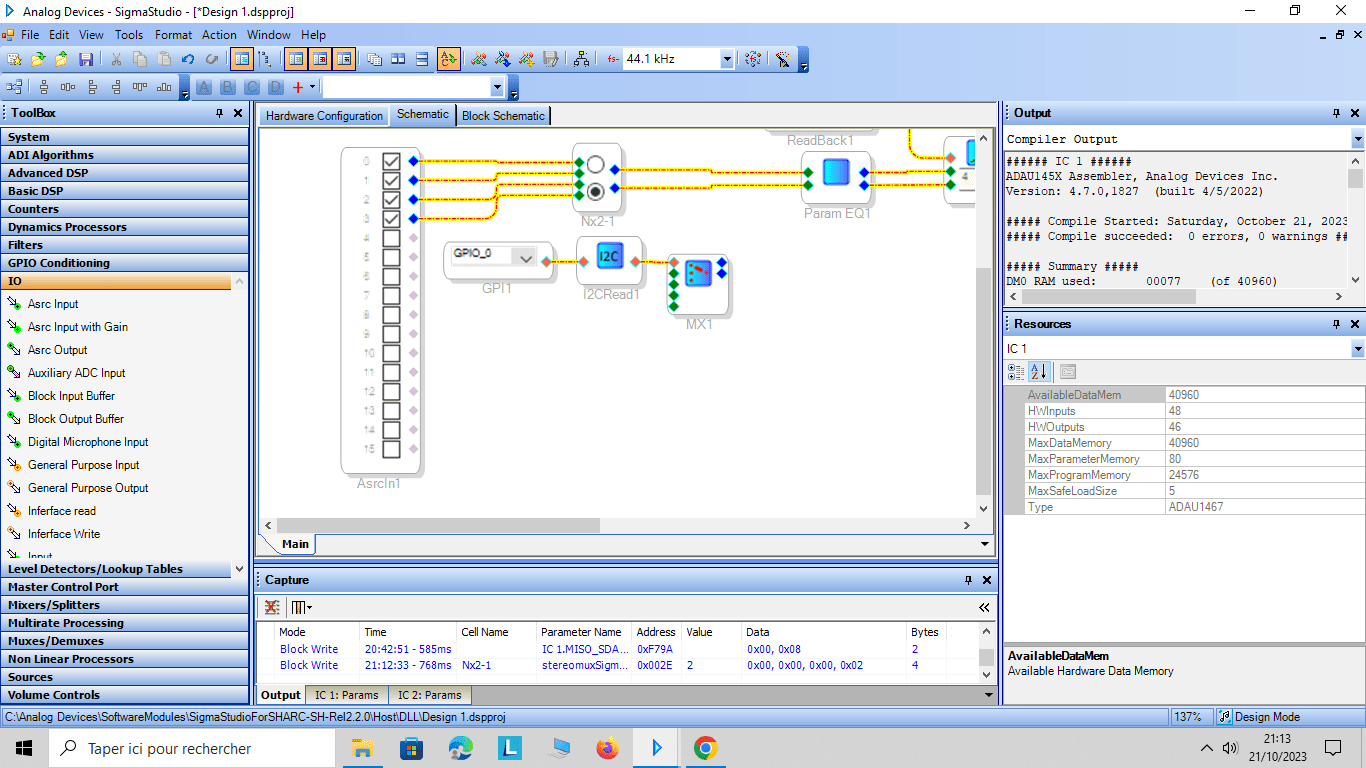

Dear, i'm doing many thing with this ADAU1467 this is crazy.
I have a question now before going inside a crossover from the 4 I2S input i want to be able to select one input with Stereo Multiplexer but the thing is that's i want to control this multiplexer via the second I2C input (SDA2m pin 31 and SCL2m pin 30) controled by a PIC32MX.
How can i link the box I2C in te design to the second I2Cm input?
I really don't know how to do i just design an idea to make you understand me.
Using I2C is new to me, but here's my take on using it: The 1452 has dedicated pins (see below) for the I2C slave port . So you don't want the GPIO_0 block, just the I2Cread block.
SS/ADDR0 Address 0 (Bit 1 of the address word, Input)
CCLK/SCL Clock input
MOSI/ADDR1 Address 1 (Bit 2 of the address word, Input)
MISO/SDA Data (bidirectional, open collector)
Here's a couple of links (besides the ADAU1452 datasheet) I found helpful:
https://ez.analog.com/dsp/sigmadsp/f/q-a/556440/adau1452-i2c-read-value-and-do-something
https://wiki.analog.com/resources/tools-software/sigmastudio/toolbox/mastercontrolport/i2cread
