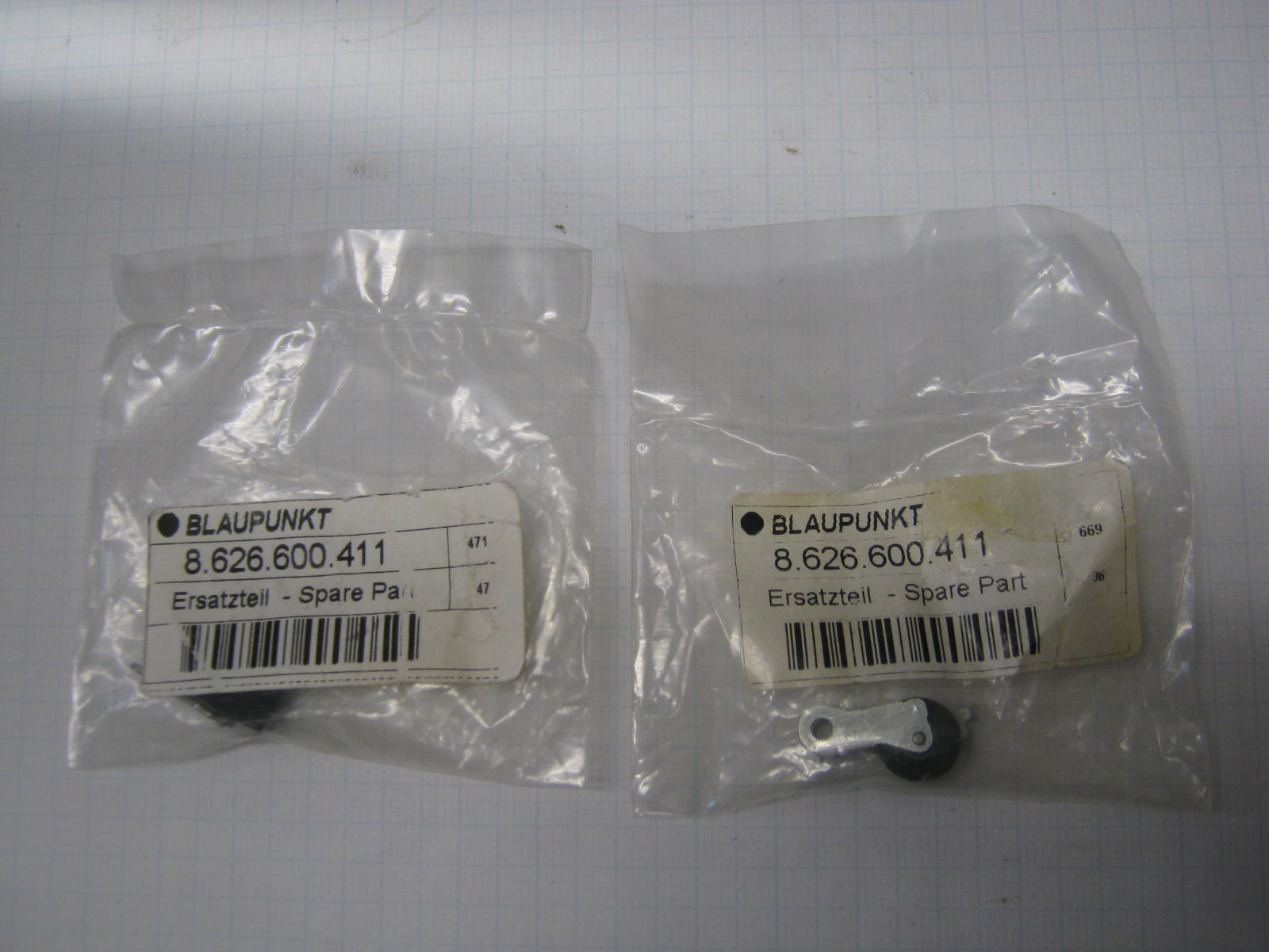

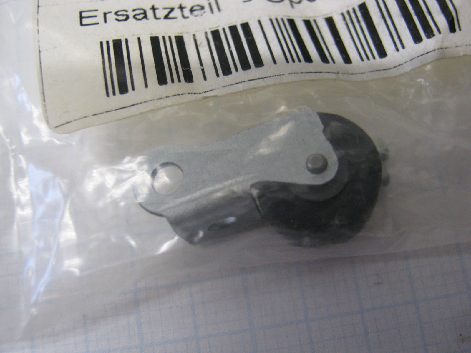

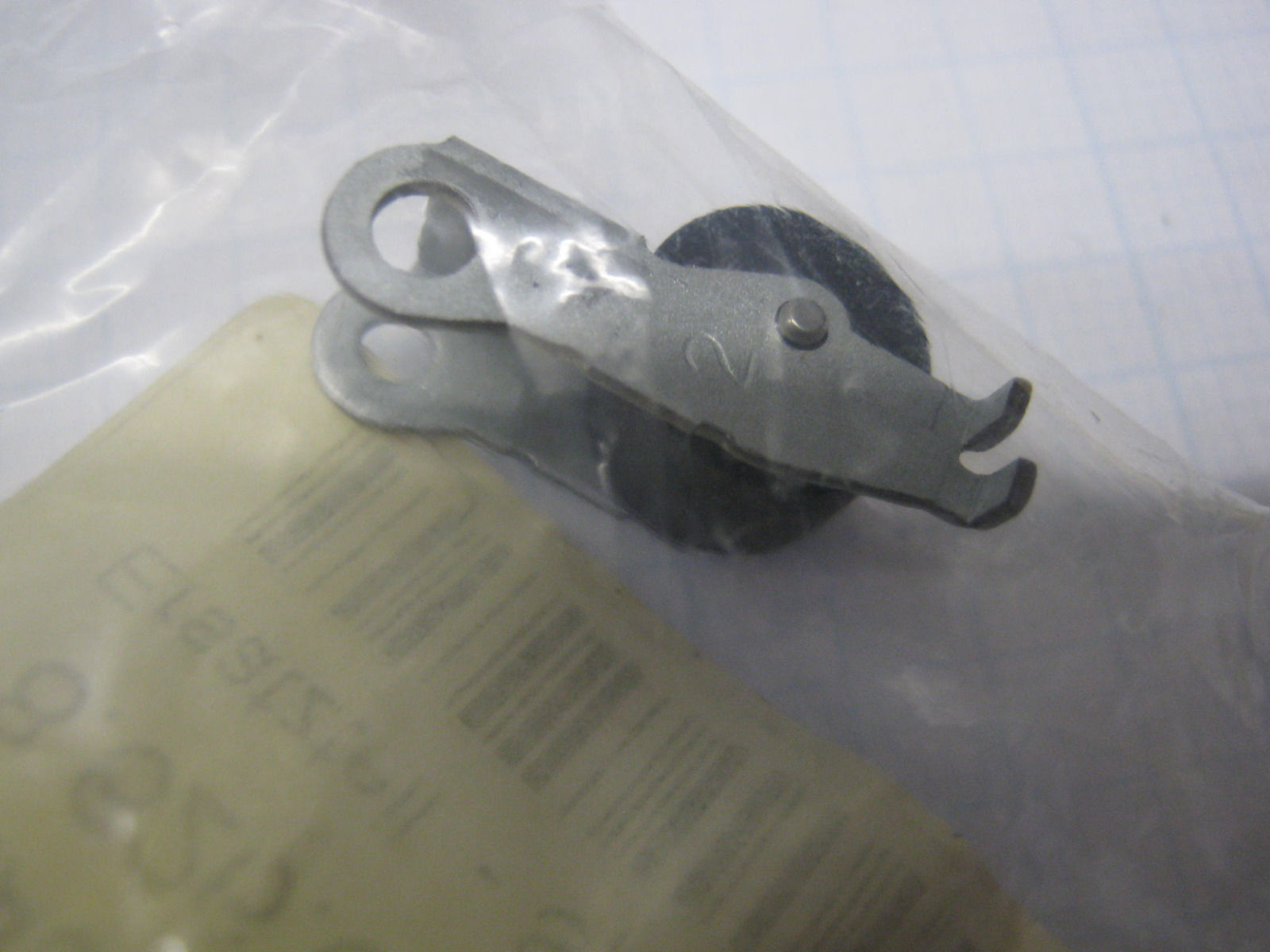

P.S.: most important in the moment I want to know Blaupunkt's order code of the "Mini 11"
for Blaupunkt's cassette drive mechanism "Mini 11", used e. g. in Woodstock SQR-04, Memphis-SQR-04 Kingston R24 and Nashville R24 I want to replace the pinch roller blocks and the question is, whether this parts are the same than from "Mini-10".
The images are from a pinch roller block used in a "Mini-10" drive mechanism, right side.
pics from the completly mechanism Mini-11
Retro-Radio pimped - another useless Project ... - Technische Fragen - vdh - Forum
Thank you for advices.
