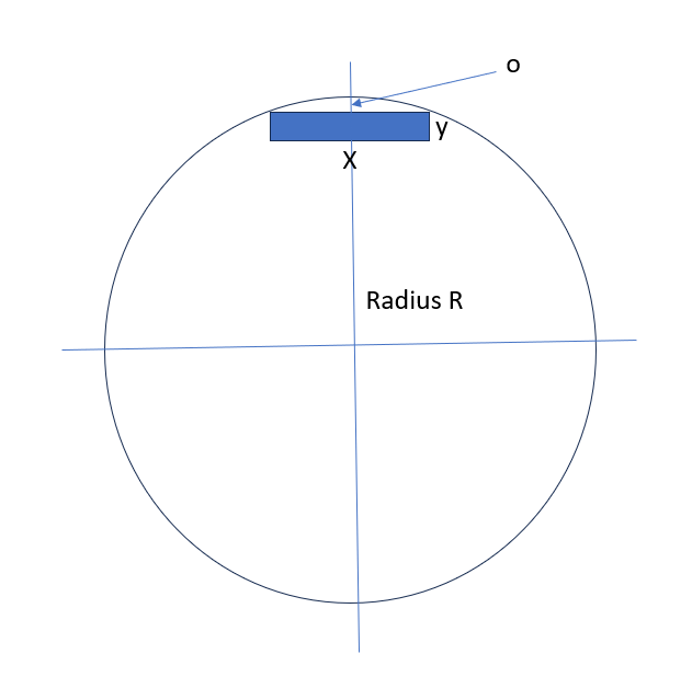

Hi guys, a question that has nothing to do with audio per se, but needs some math/trig chops.
See attached drawing. I need to find the radius of the circle, given X, Y and offset O.
How do I do that? I guess only X and O are required?

Wow! That was fast guys. I get it, and the numbers I get seem to be OK.

Yup, R = x^2/(8o) + o/2.
Proving involves some similar right-angle triangles, its not too obscure.
