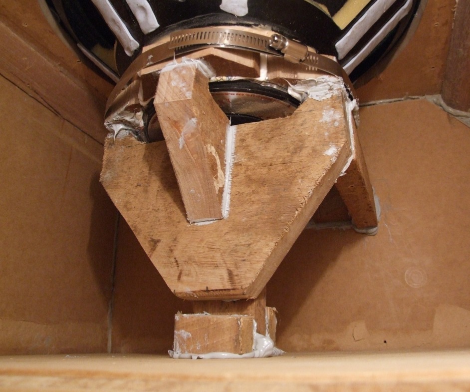

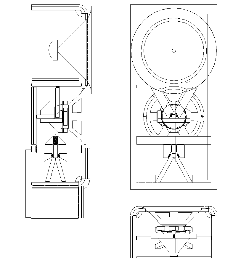

Here's one I used a long time ago.. though it could be much simpler than this.
The polyurethane sealant used as adhesive is quite sturdy although it remains flexible, and it's very sticky to begin with although difficult to deal with.
The magnet is close to the effective grounding point of the driver. Mounting this way can bypass the basket resonance.
So then that back part is it's "ground" since it's not load bearing. Neat approach. Definitely gives me some ideas.The magnet is close to the effective grounding point of the driver. Mounting this way can bypass the basket resonance.

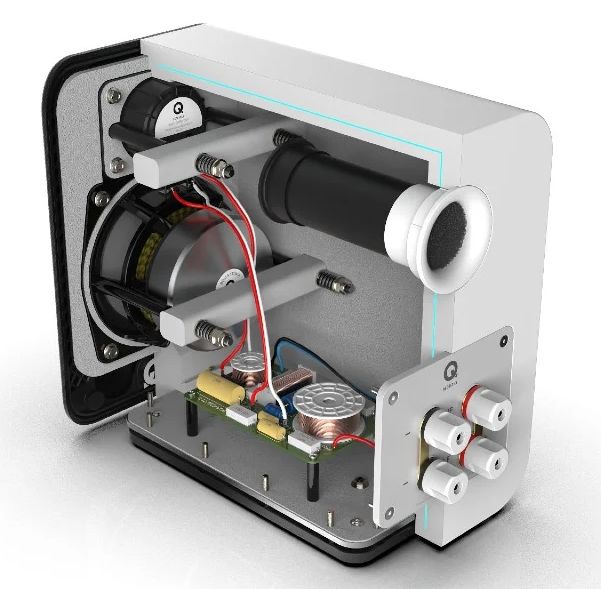

Q Acoustics Concept 30. There's a white paper on it and some of the blurb.
The drive units are fixed to a double radius, highly stiff, 3mm thick, damped aluminium baffle plate which has been designed both in material and form. Studs, extending from the back of the drive unit chassis pass through the stiff P2PTM cross-braces and provide the fixings for this baffle assembly. The studs are pretensioned to give the correct cabinet acoustic seal whilst minimising the structural coupling of the baffle assembly in the main cabinet assembly.
In addition to the smooth low acoustic diffraction profile of the baffle, the geometric curvatures provide high stiffness for relatively low material mass, thus pushing the fundamental baffle resonance well away from the main excitation of the woofer. The tweeter is dynamically isolated from the baffle.
Tweeter is built on a die-cast chassis which is fully hermetically sealed and mechanically isolated (floating) from the front baffle.

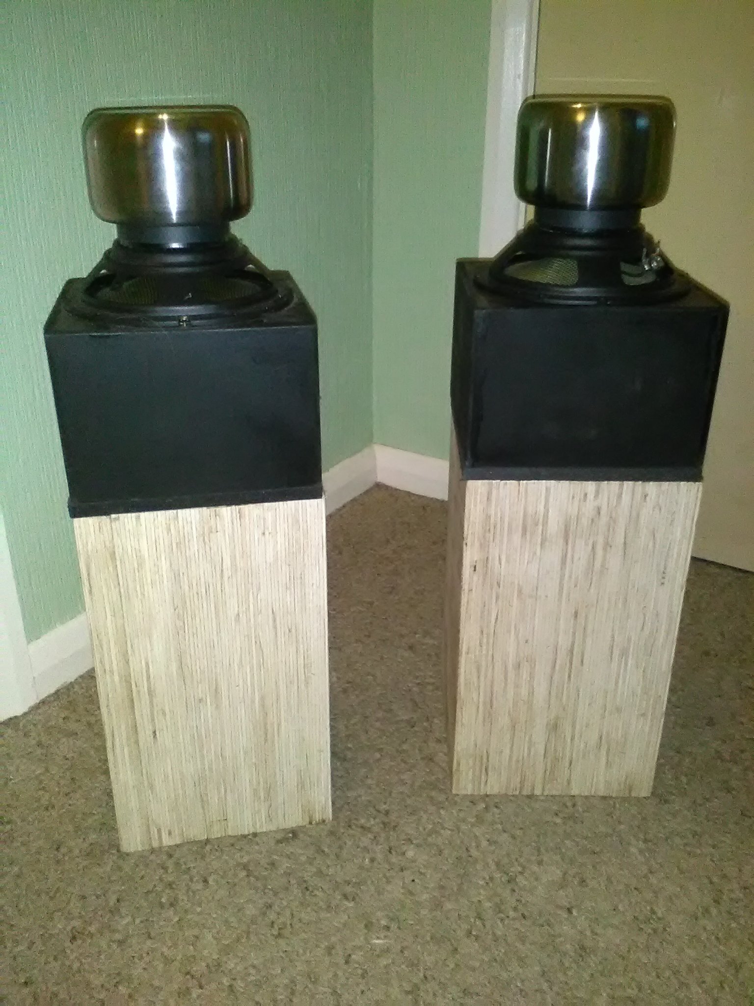

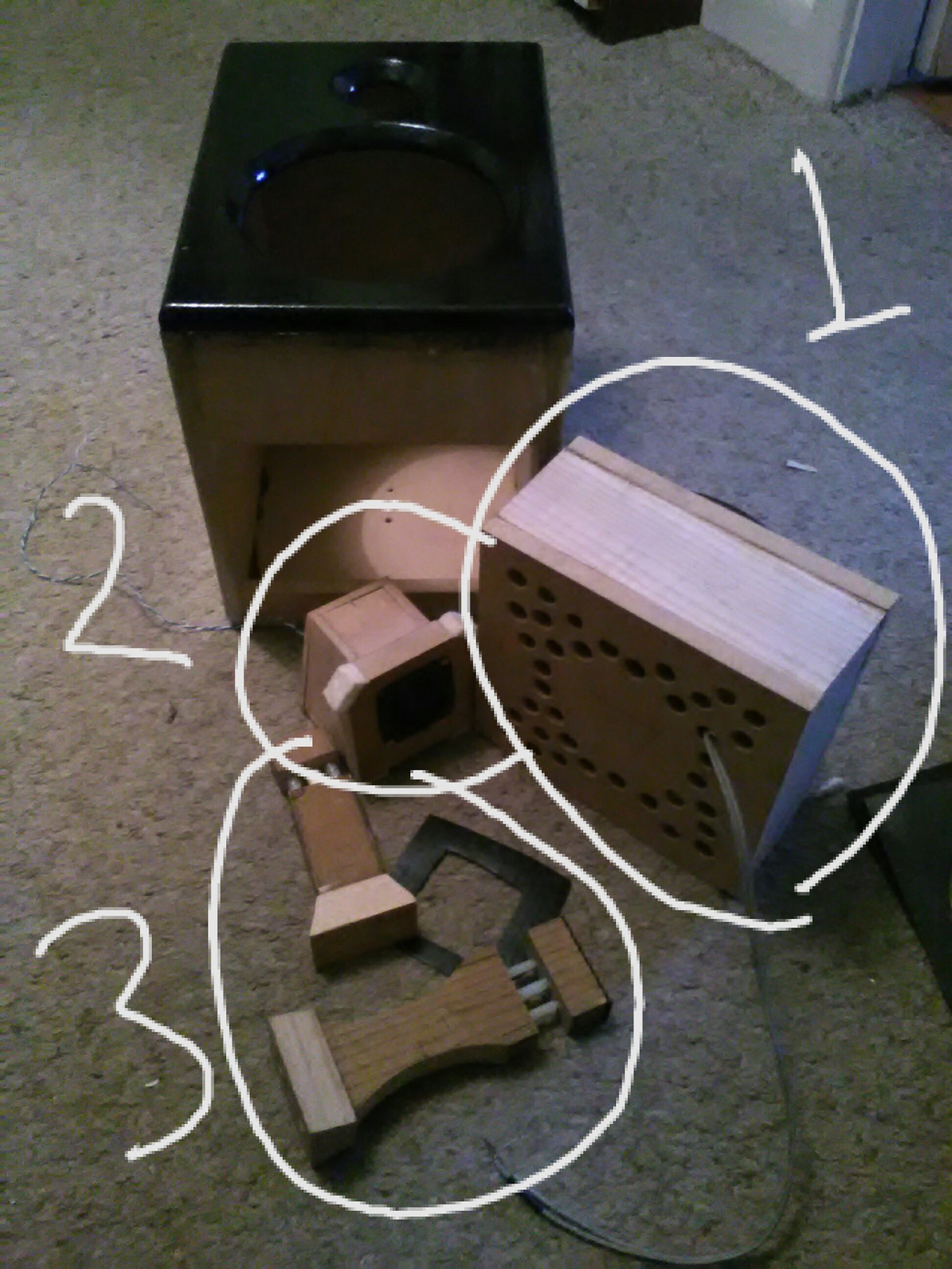

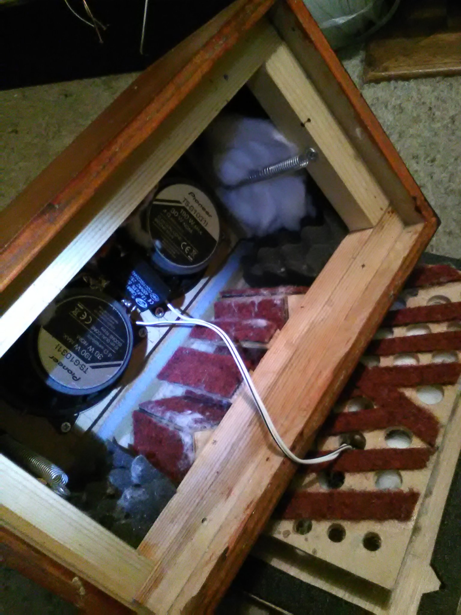

Here are some ideas on how to isolate vibration; the first is a "box in a box" design, the Bass driver an cone tweeter are in there own enclosures, numbered 1 and 2, (the bass vented to the main enclosure, they fit in through a trapdoor in the bottom, are held in place by spring plunger things (marked 3) against foam gaskets on the inside of the front baffle. The second is similar to the construction of the BBC LS35a, in that the drivers are held on the front baffle, which is isolated and damped from the main enclosure by a soft gasket - instead of screws used in the BBC design I used tension springs to hold the front baffle on, and screws to hold the rear panel on. The third used drivers mounted back to back in a dumbbell thing, which slides in the main enclosure from the rear, is suspended by foam/carpet tile, and is held in by a rear cover. the last, I just bolted 4.5 kg lumps of cast iron to the speaker magnets.
