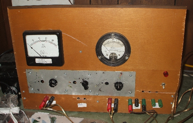

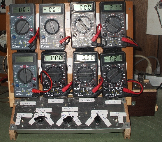

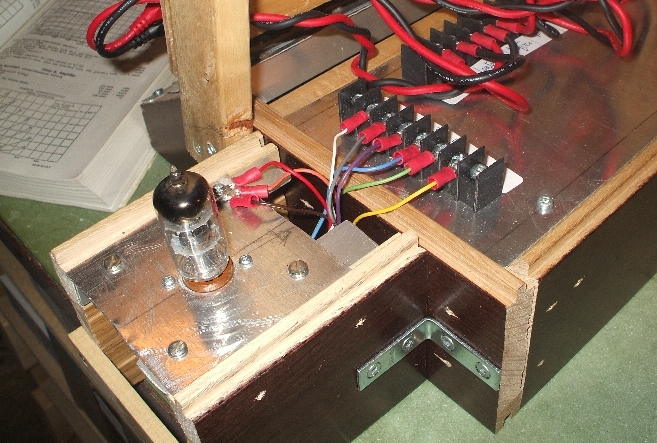

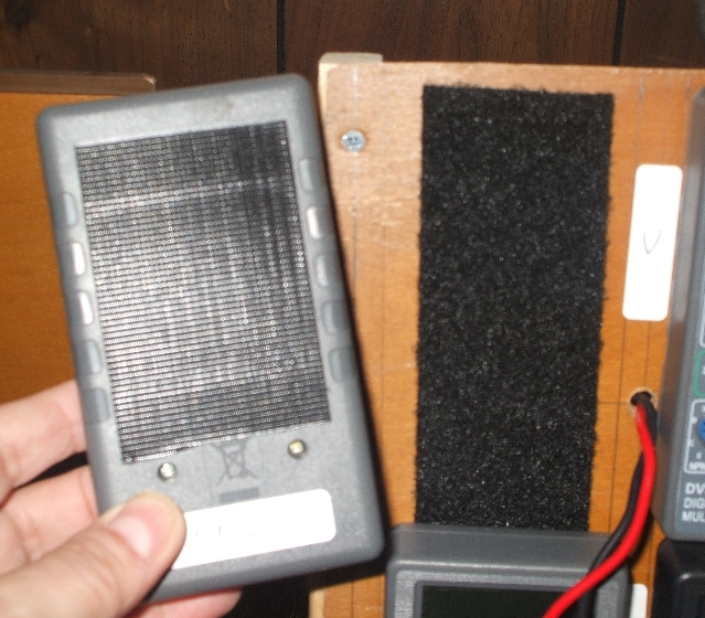

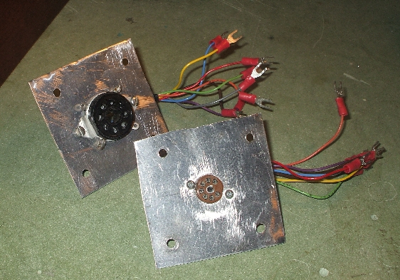

This is the set up I use. Having independant regulated plate and screen voltages makes things simpler, but more expensive. I made the power supply shown using parts I had already, and put it in a wooden box to keep cost down. If I had to buy parts I would never have done it.
But once you have independant plate and screen supplies, and a grid supply, then you can take the approach mentioned by kevinkr, ie just measure a boatload of dc points, and use the data acquired for any number of things, calculating Gm, drawing plate curves, build SPICE models, whatever.
The tester shown is 8 inexpensive meters stuck to a panel with velcro and wired up to terminal blocks and switches. I have tube sockets of various sizes on plates that I hook up to it, socket wiring colour coded as to pin number, and test set terminal block labeled as to voltage function, so I can test any tube.
Of course it can also be used to power, and meter, other projects.
OK, so the picture upload doesnt work the way it used to 😕, I will figure out what to do , and post pictures later.
I found the "Manage Attachments" button, so here are the pictures.
