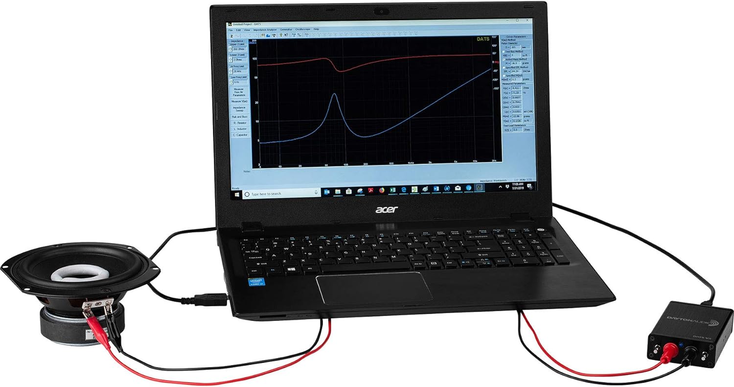

I'm an absolute beginner and want build enclosure for my subwoofer for which i don't know the Ts parameters can any one suggest me how to measure those parameters as near good as possible.

Welcome to the forum!
Have a look at this: https://www.daytonaudio.com/product/1650/dats-v3-computer-based-audio-component-test-system
It costs around £200 in the UK.

If you understand german, search on the net for a little booklet (Francis Verlag 196) written by Professor Panzer: Die Konstruktion von Basslautsprechergehäusen. It is about the construction of bassloudspeaker enclosures with the help of the filtertheorie. Contains a lot of knowledge and, amongst other things, also how to obtain the values of Qes, Qms, Vas. You need a frequency generator and counter, oscilloscope, DMM, some resistors and a unmagnetic known weigth. Needs determination and is qite a lot of work, but you sure will learn something.

Doing it with REW and a soundcard or audio interface.
https://www.roomeqwizard.com/help/help_en-GB/html/impedancemeasurement.html
Also with LIMP more details on some aspects that also apply to REW
https://artalabs.hr/AppNotes/LIMP_Tutorial_Version_2_4_English.pdf

For a 1off that would put most people off.It costs around £200 in the UK.
Precisely!
The outlay to an "absolute beginner" in terms of purchasing equipment of ANY kind just to measure ONE driver may not make good financial sense.
I was going to add that, but left my post as is to give the OP food for thought.
However, he seems to be taking a long time to chew it over!

Thanks man but my driver didn't cost that much. Have to find other ways.Welcome to the forum!
