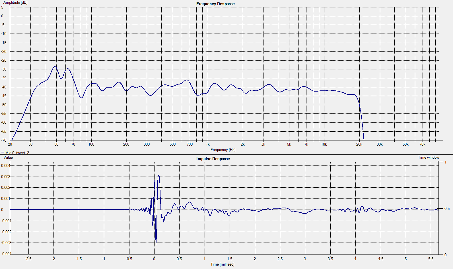

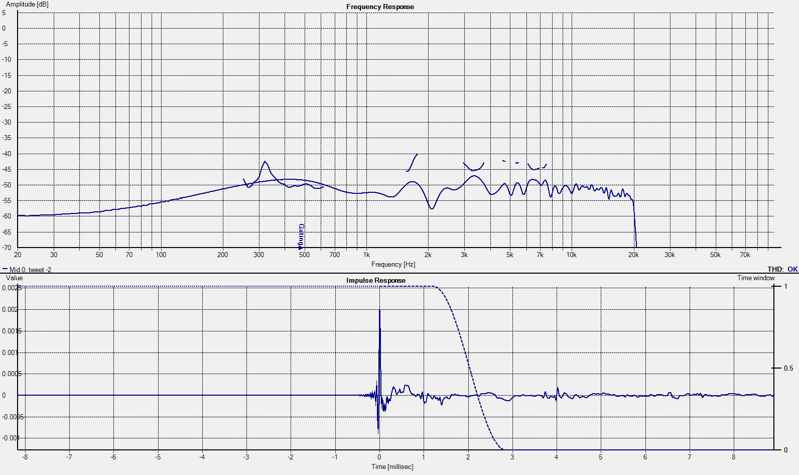

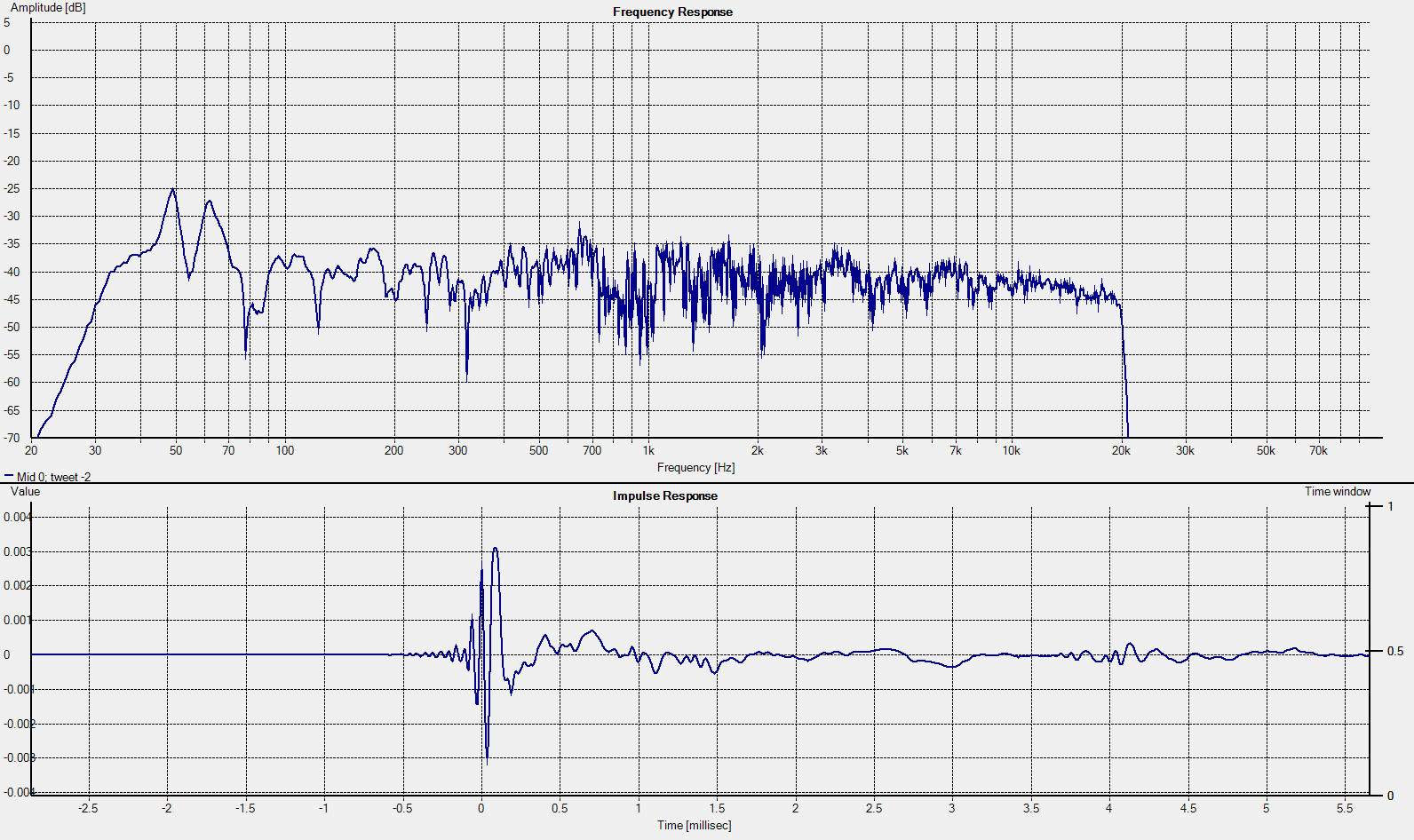

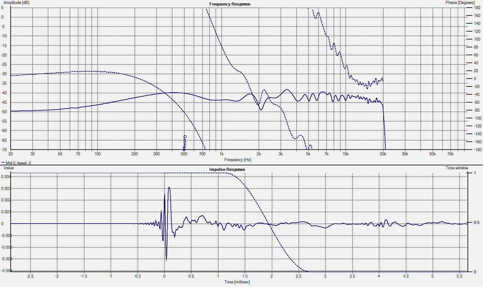

I tried to do some measurements! Here is the pic of what I did...
(diferrent plots are for different L-pads adjustments.)
Did I do everything right?
How is the response?
Also, can anyone kindly give me recommendations about mic's placement with regards to the speaker?

I would say yes, you did it right. ;up: The measurements look good. Do you have a calibration file for your mic? (I think you said you did).
You can also ungate the measurements you took and use some smoothing, like 1/6 octave, to get a general idea of what you'll hear. Raw response or 1/12 octave will show you nasty peaks that you might need to take care of.

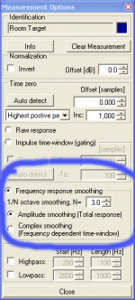

How can I ungate the measurement and the smoothing? Can you give me a hint?
Thanks. I will try that tomorrow. 🙂Look under the Option button at each measurement. Lot's you can do there.
Inside the blue line I made is the smoothing option. Try some of those.
