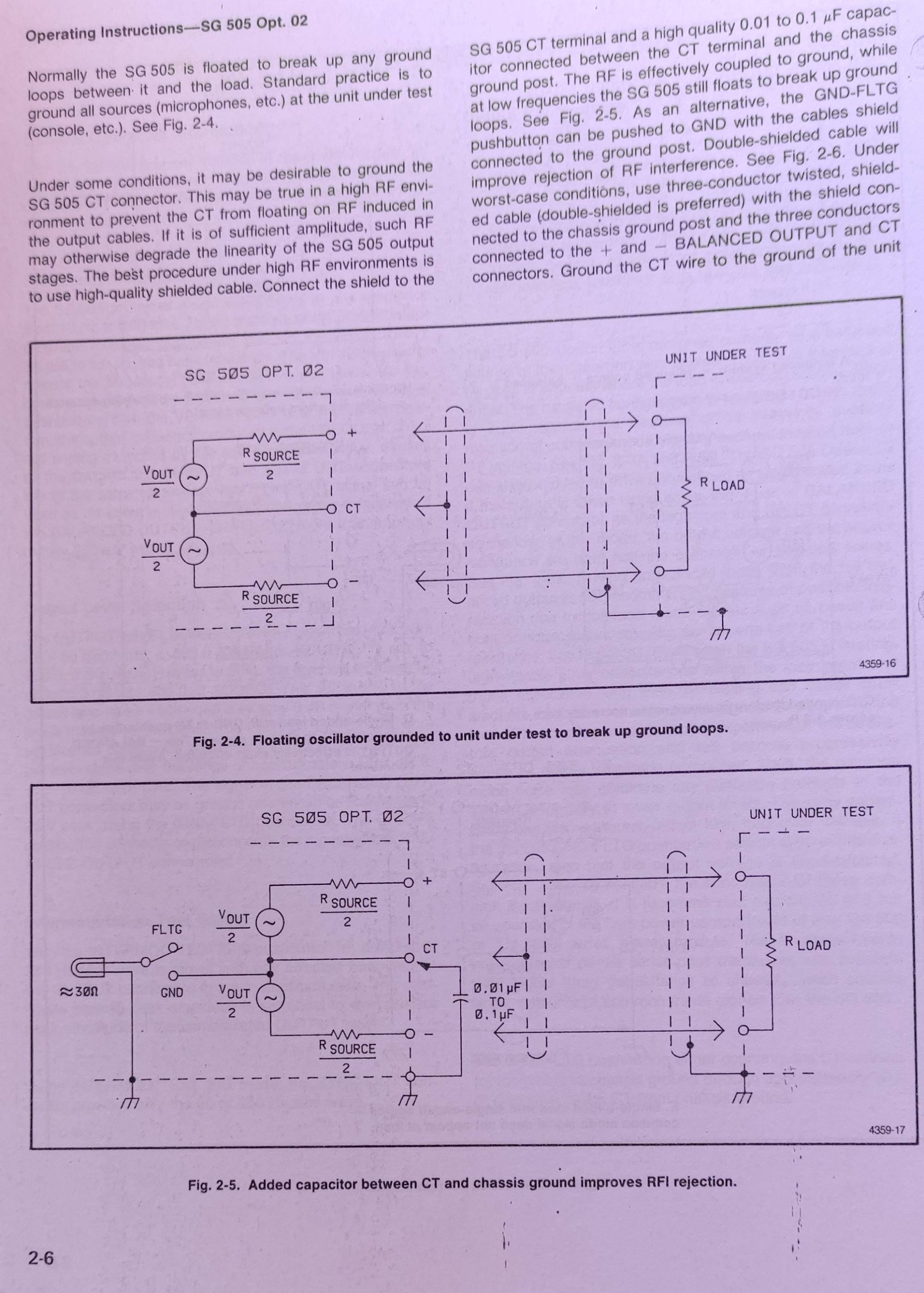

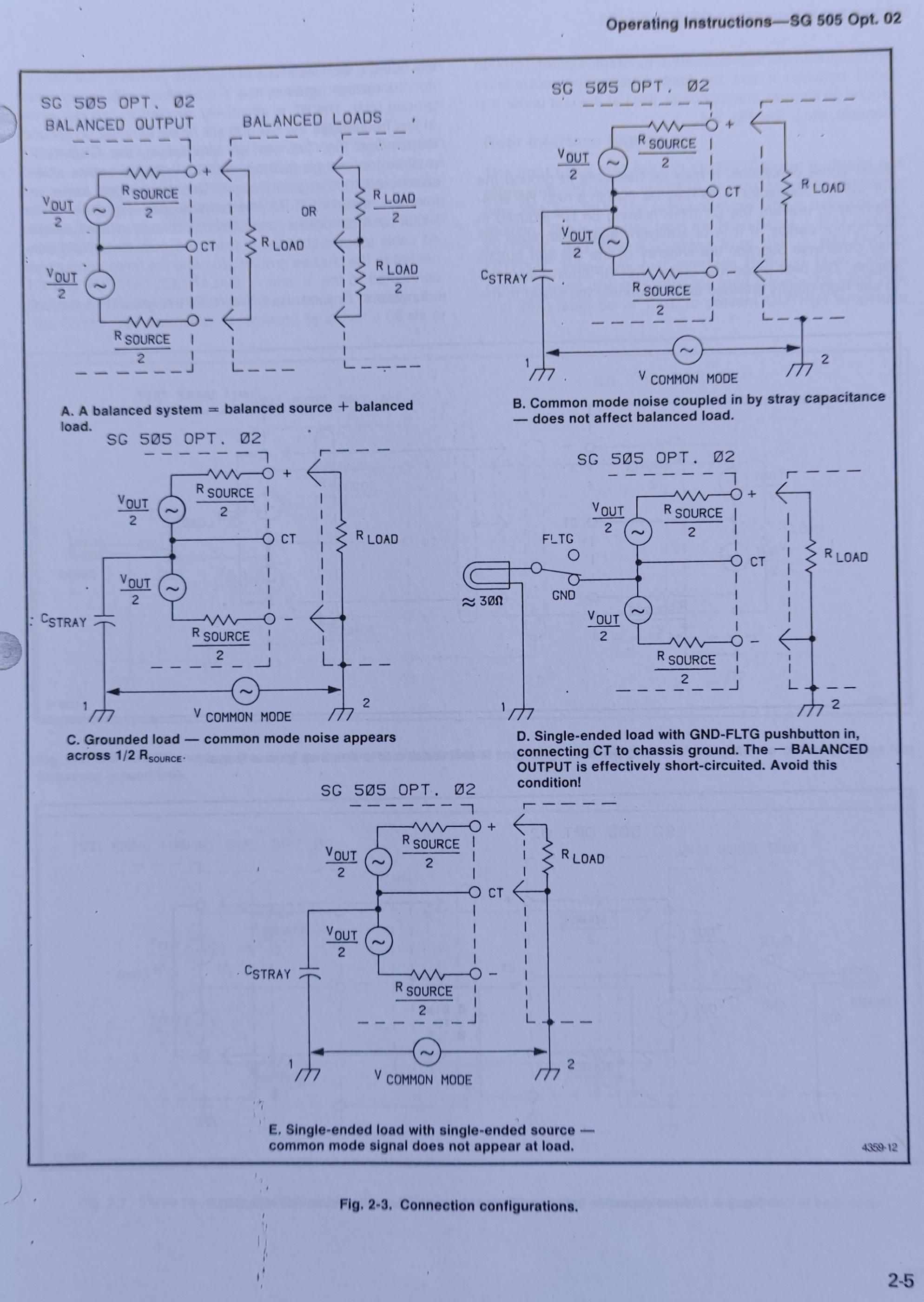

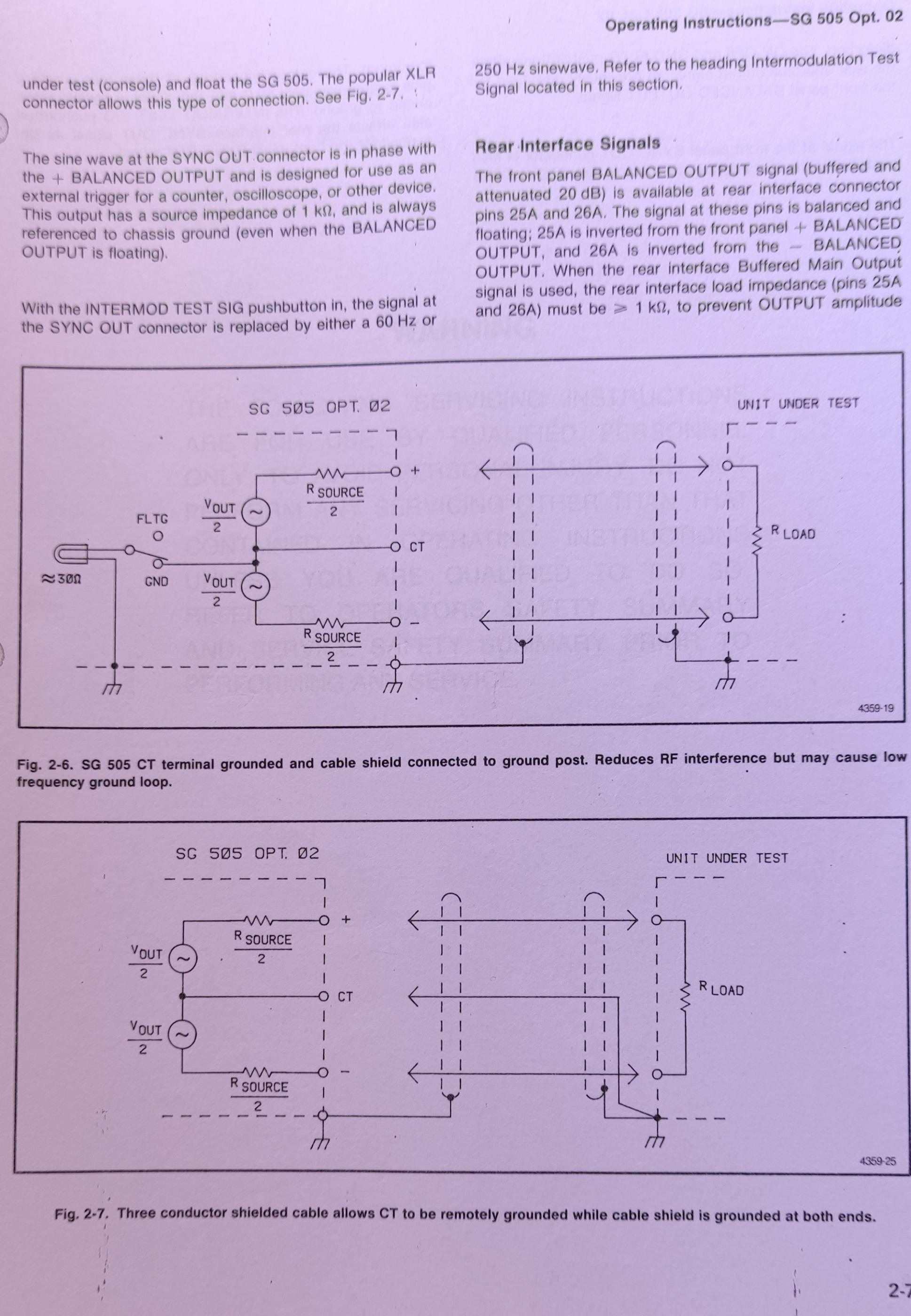

Thanks for the link, Demian. From a quick look at the manual, it seems it only shows connections for the styandart 505 with a single bayonet out. I couldn't find a manual that describes the balanced option. So you are saying, I should use "-" port on both 505 and 4084 as a reference point, leaving 505 floating. What is CT port then? Do you have a manual for the balanced output version?
Sorry-no manual. I found this closeup SG505 - TekWiki on Tek wiki. You have option 2. Yes. tie the - to the DUT's ground for both the source and the analyzer. The CT is used when you need a balanced connection with a center tap.
