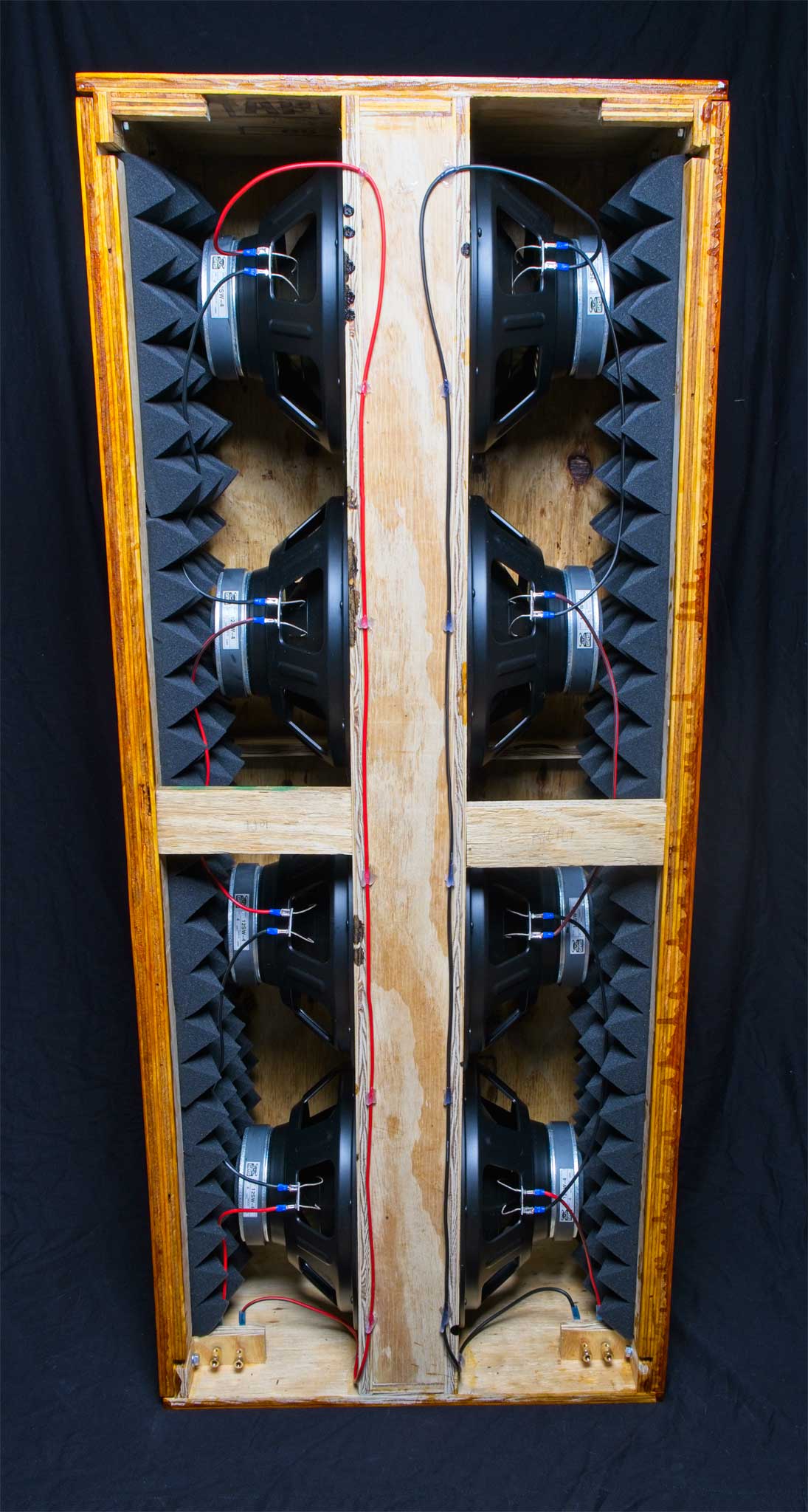

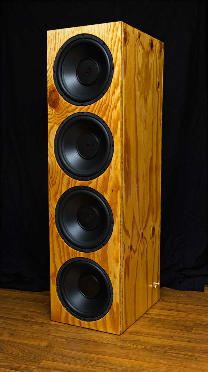

4 x 12" sealed sub:
For the same frequency & SPL, this has more per-driver-excursion and no air velocity component related to a slot or vent.
8 x 12" open baffle with slot loading (opposite side) sub:
For the same frequency and SPL, these drivers have less excursion per driver. There's a slot cavity for each pair of drivers with an air velocity component (albeit a small component but its different none the less). I feel this one more at the same SPL at the same distance at the same frequency than above. Yet it has less per driver excursion and some air velocity from slots. So there's something else other than just pure SPL that I'm feeling.
Same position in the room. Same distance. Same frequency and SPL matched. They feel different. I'm just trying to see if I can measure why. Maybe that's not possible. I'm not trying to reinvent the wheel. Just trying to understand what other than SPL matters for tactile response.
