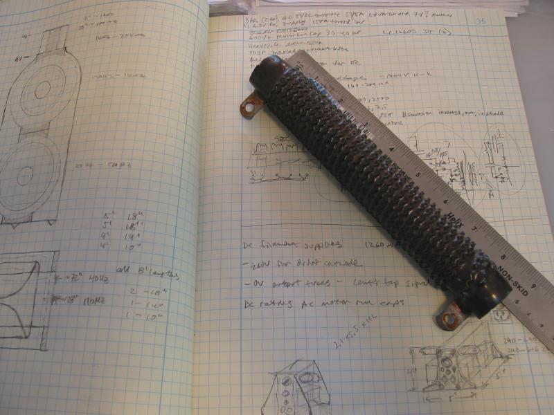

"I have a huge 6.8 ohm and a huge 10 ohm resistor. Would either of those be acceptable?"
Depends on what you mean by huge. Here is a picture of a 300 watt
resistor. This is a compact one. I use this type for dummy loads
because they're rugged and cheap. They also have an optional
sliding contact you can use to get smaller resistance values. I
use a 10 ohm with the contact that allows me to set to 8.0 ohms.
This reduces the power rating of the resistor correspondingly.
Also, as these heat up the resistance increases; I don't know
how much because I run them cool.

Yes, they're 300W and I just ordered an 8 ohm 300W resistor too. So I should be all set.
