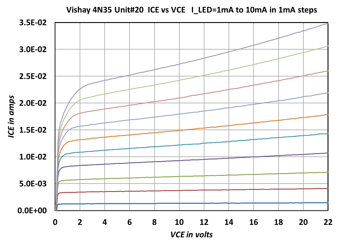

My results are in Figure 2 below. The raw data (excel spreadsheet) is included in a .zip archive, if you want to examine it more closely. {when you zoom in you'll see a certain amount noise in the measured data, which is not so visible in the zoomed-out figure here}.
For me the big surprise is that the phototransistor shows a degree of quasi-saturation at high current and low voltage. If I want to run it at low VCE, I had better stay below ~ 12mA to 15mA of ICE, to keep away from quasi-saturation.
Early voltage is about 100 volts which is much higher than I dared to expect.
The spacing between the curves is relatively constant, which means the "Beta" of this NPN {optoisolator datasheets call it the "Current Transfer Ratio"} is also relatively constant, at about 2.5 or so.

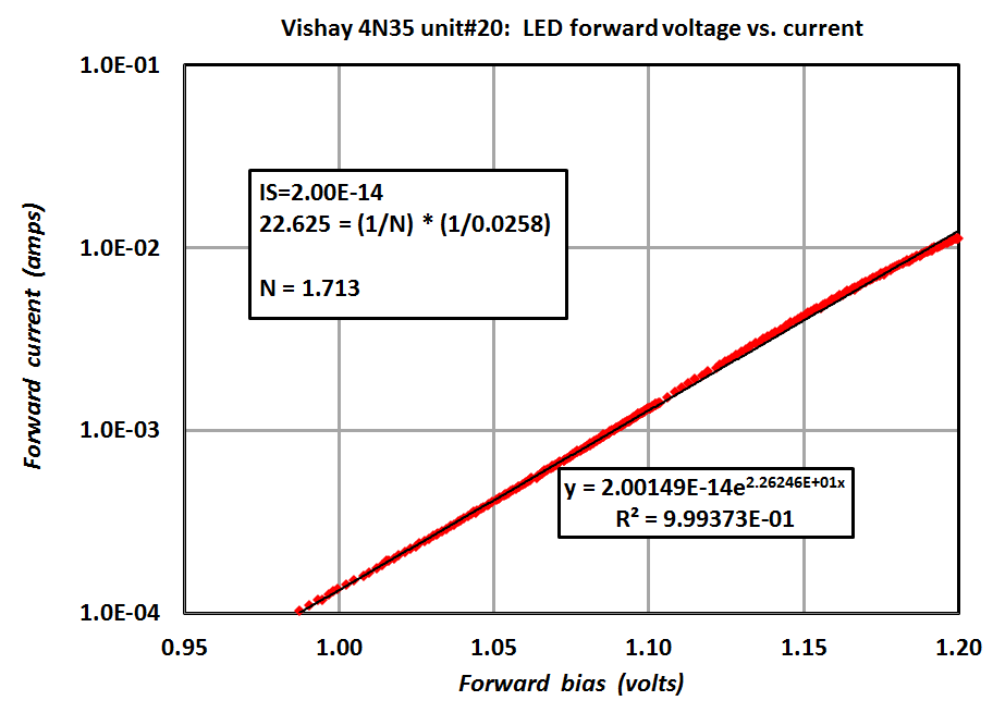

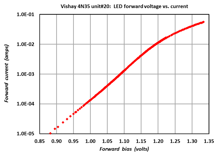

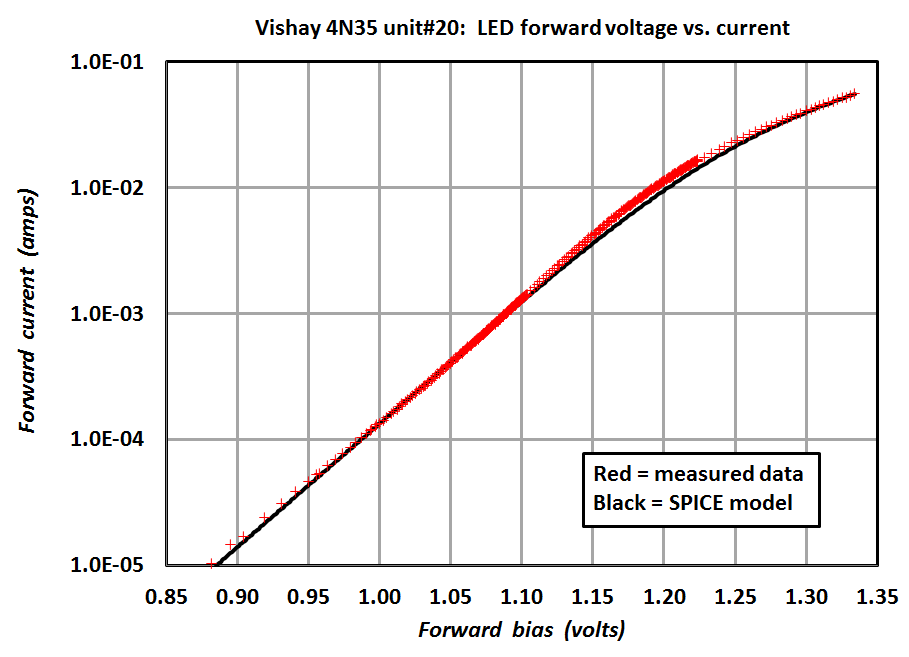

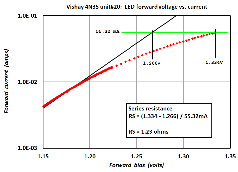

Measuring the (exponentially!) nonlinear I-V behavior of the 4N35's input side, namely, the LED.
As shown in Figure 1, there is a kink at Vin=1.03 volts; the slope changes visibly. SPICE's equations do not provide for this, so any fitted model will be a compromise. Figures 2-4 show the compromises that I decided to make.

Next I took a look at the variability of 4N35 behavior, from unit to unit. The Vishay devices seemed more tightly grouped than the LiteON devices, so I decided to further investigate the LiteON parts.
I plotted Iout versus VCE for several LiteON 4N35s, with a constant LED input current of 5.0mA in every case: see attached image. The current transfer ratio (CTR = Iout/Iin) varied from 1.50X to 2.26X. The geometric mean of the extremes is 1.84X and the extremes are displaced ±23% from the mean. Conservative design-for-yield would require correct functionality far beyond the limits of this modest dataset; perhaps ±40% or ±50% from the mean. Wow.

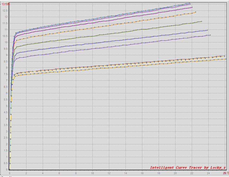

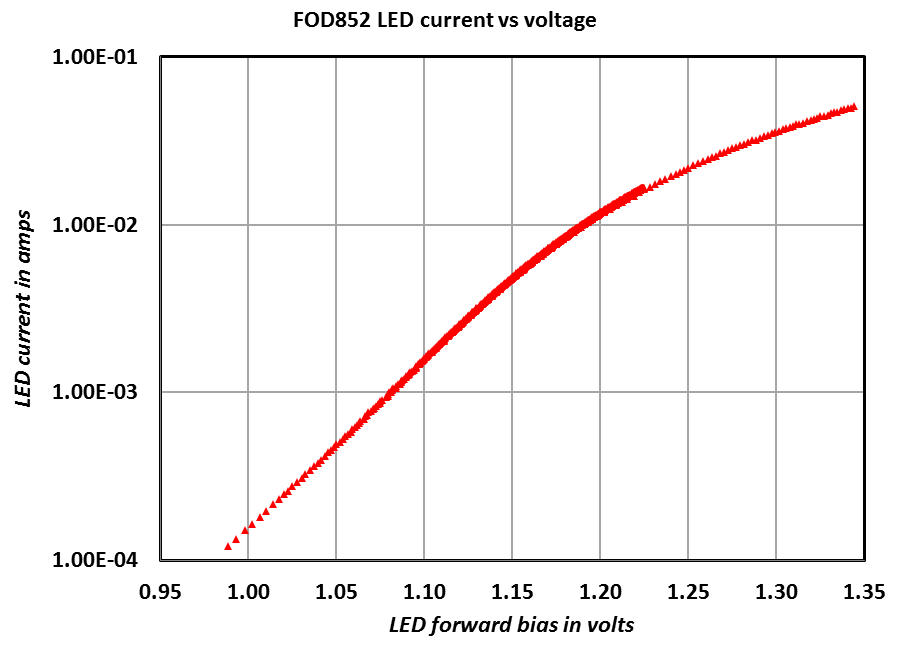

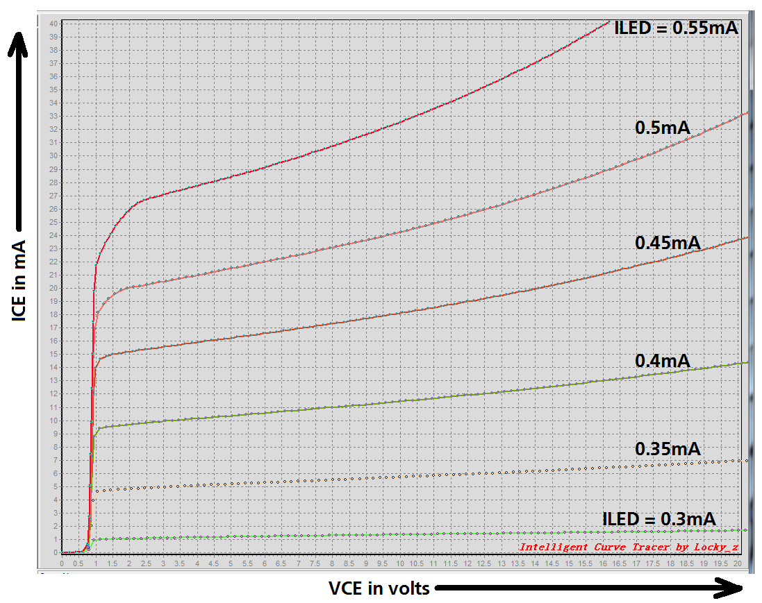

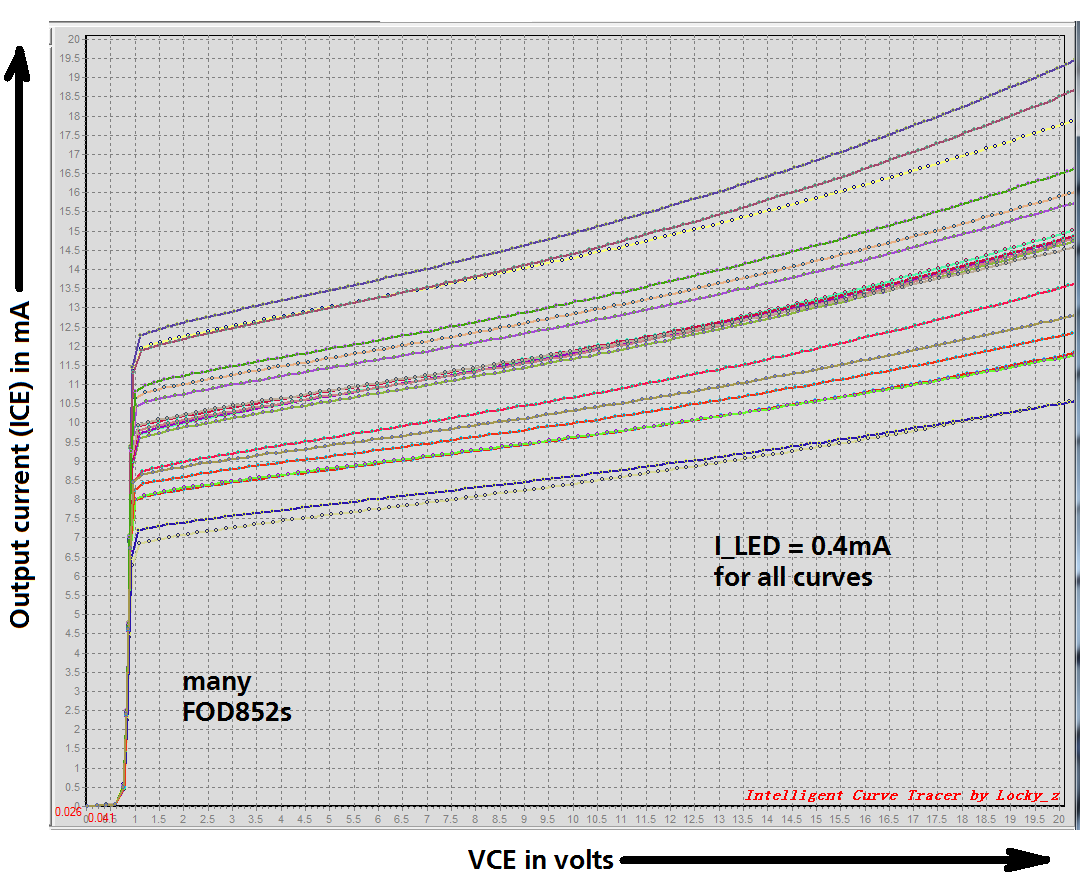

I realized I had a tube of Darlington optoisolators, Fairchild FOD852s, so I put those on the tester too.
As shown in image 1, these LEDs seem to "turn on" at slightly lower voltage: 1.1V or so, rather than the 1.2V of the 4N35s.
Image 2 treats the optoisolator as a weird NPN transistor: "base current" (actually: LED current) is stepped from 0.3mA to 0.55mA, while collector voltage is swept. Collector current is plotted on the Y axis. Again we see a whiff of quasi-saturation, at low VCE and high ICE.
I fixed the LED current at 0.4mA and tested a bunch of different FOD852 parts, overlaying the I-V curves on a single plot, to get an idea of their variability. The result was Image 3. Current Transfer Ratio (= ICE / ILED) varied from about 20X to 38X.

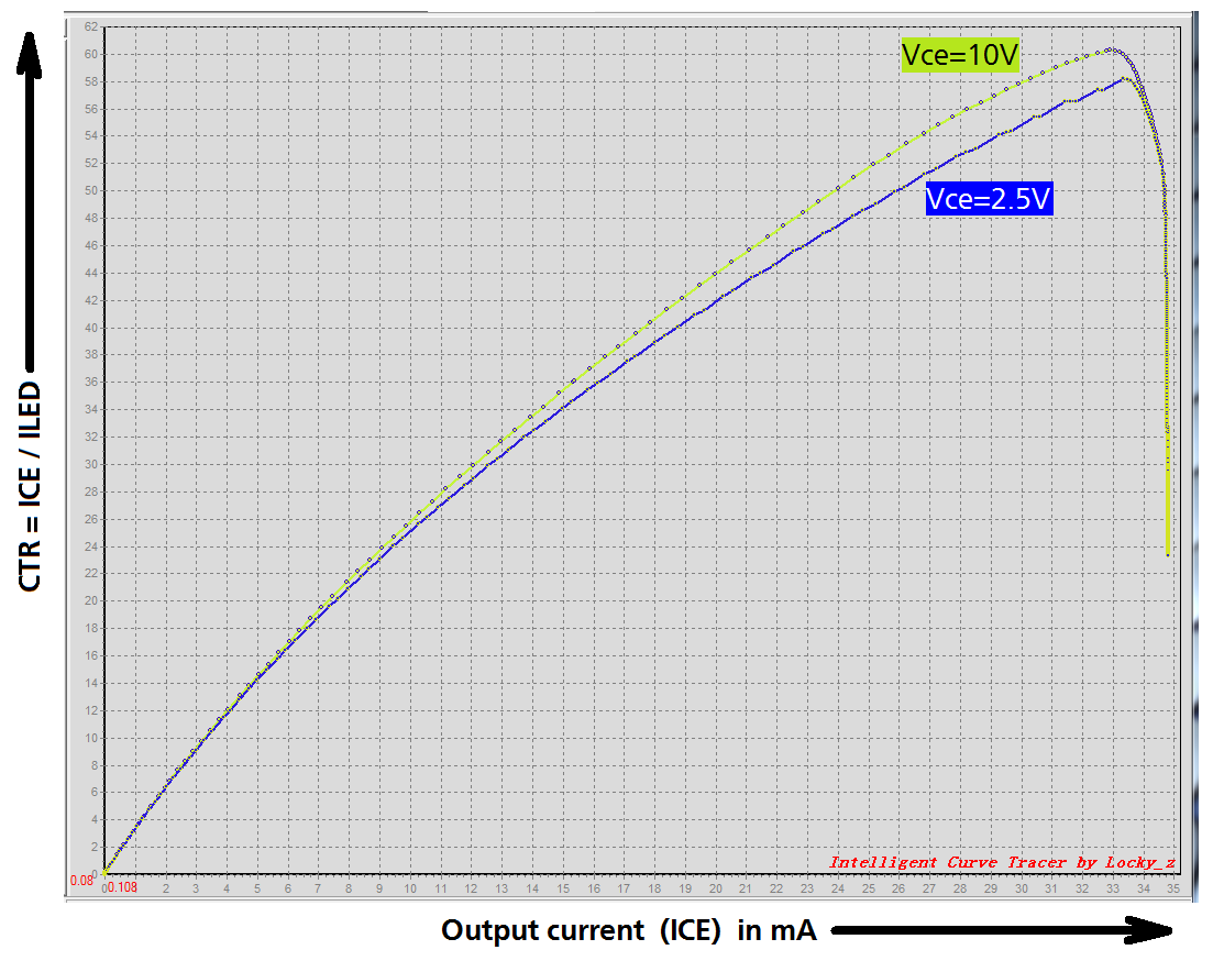

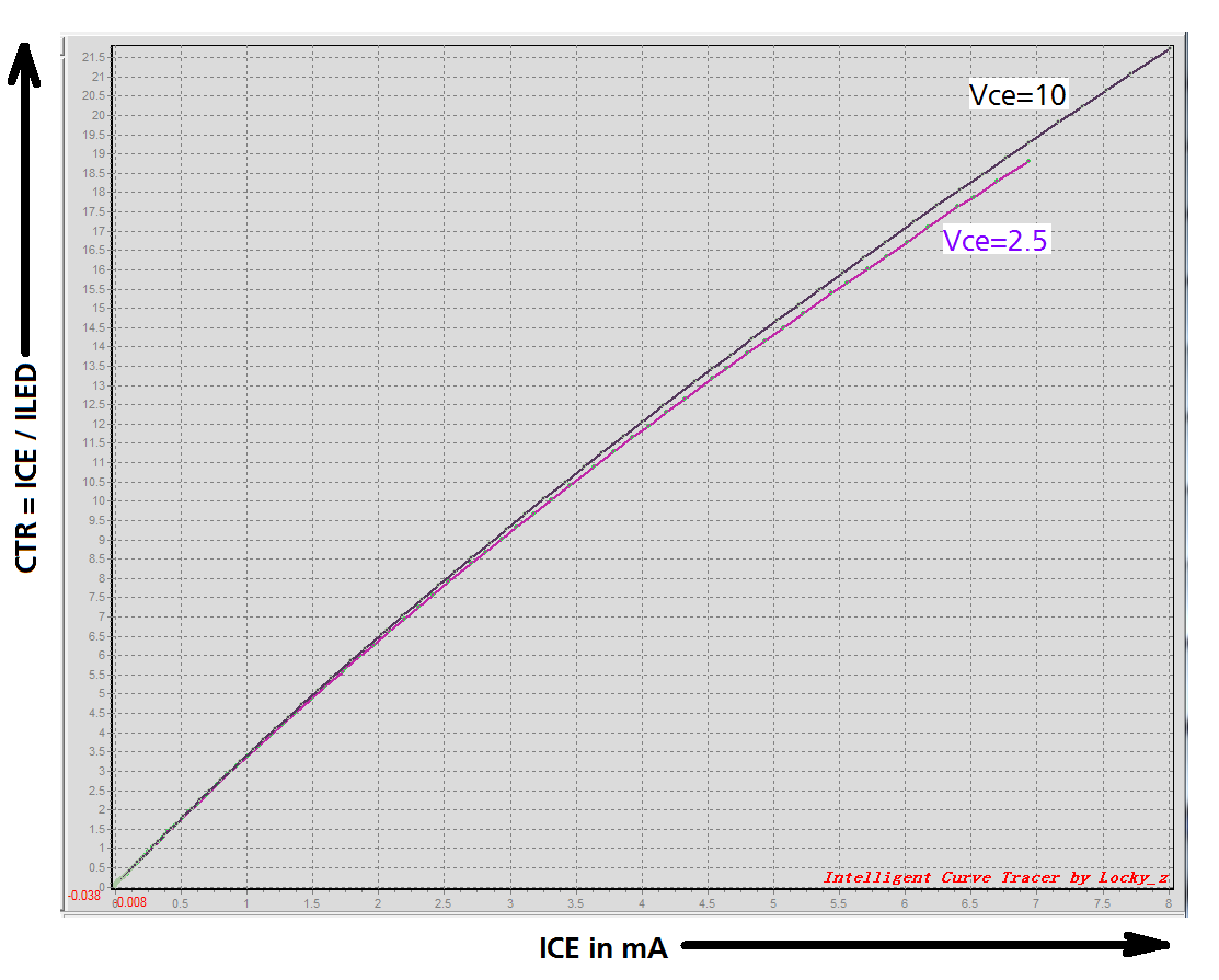

The curve tracer has a cool feature that lets you plot Beta versus collector current; I enabled that feature and instead got a plot of Current Transfer Ratio versus output current, in Image 4. The damn thing just gets better and better as you crank up the current. But my intended application (as a bias spreader in an audio amplifier) will run the optoisolator at relatively low currents. So I adjusted the settings to keep the entire plot within (0 < ICE < 8mA) and the result is Image 5. Notice that at very low collector currents, the CTR falls precipitously. Yikes.

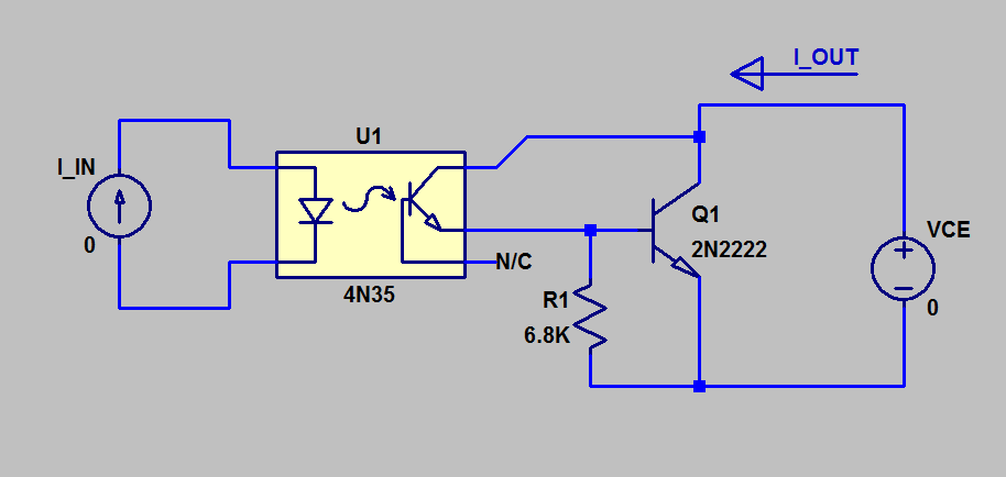

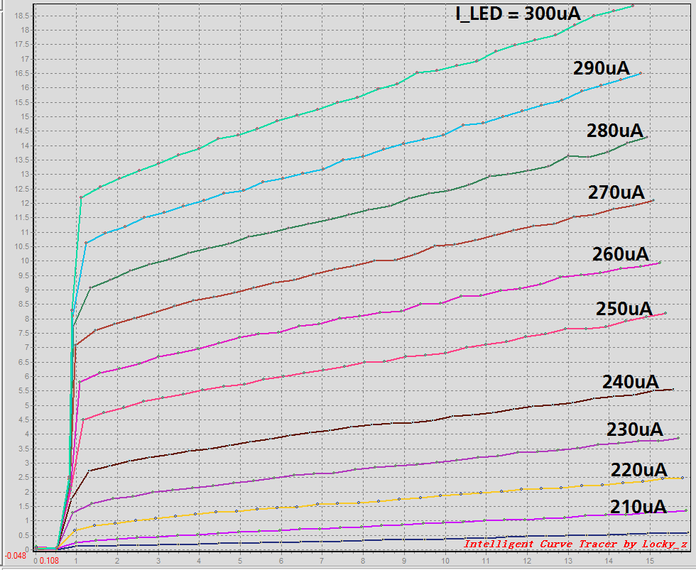

Those integrated-Darlington optoisolators seemed awfully anemic at low currents where I intend to operate in an audio amplifier bias application. I wanted a lot of gain in the neighborhood of (2.5mA < Iout < 10mA) so I experimented with an external discrete transistor (PN2222) as a current booster: see image 1 below.
This increased the Current Transfer Ratio quite a bit, in the low current zone where I plan to operate. As shown in image 2, 250 uA input produces 5 mA output at VCE=2.5 volts, and slight increases in input current give large increases in output current. So the DC bias feedback loop will have plenty of gain, just as I desire. And of course there's another factor of 3X gain available if I switch to a superbeta transistor instead of the junkbox 2222.
