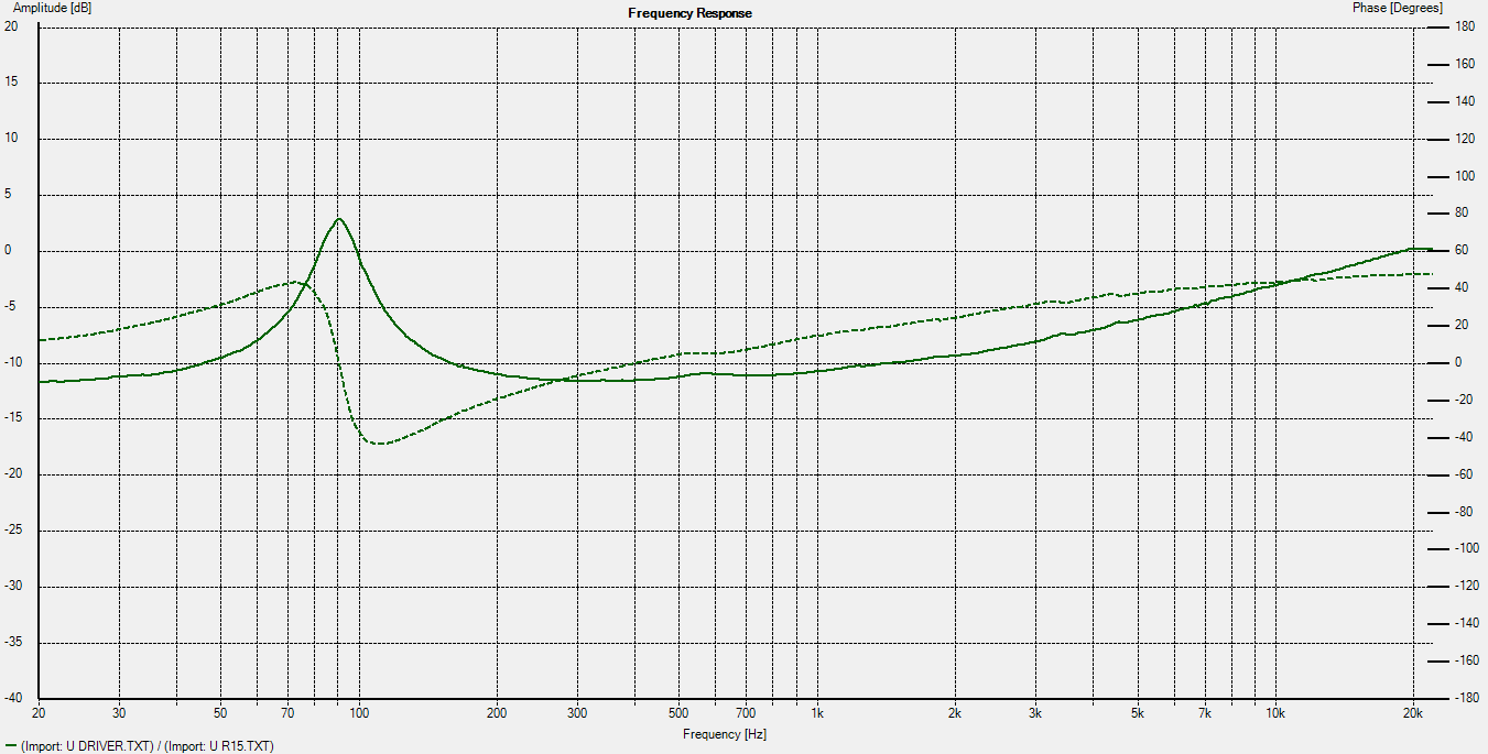

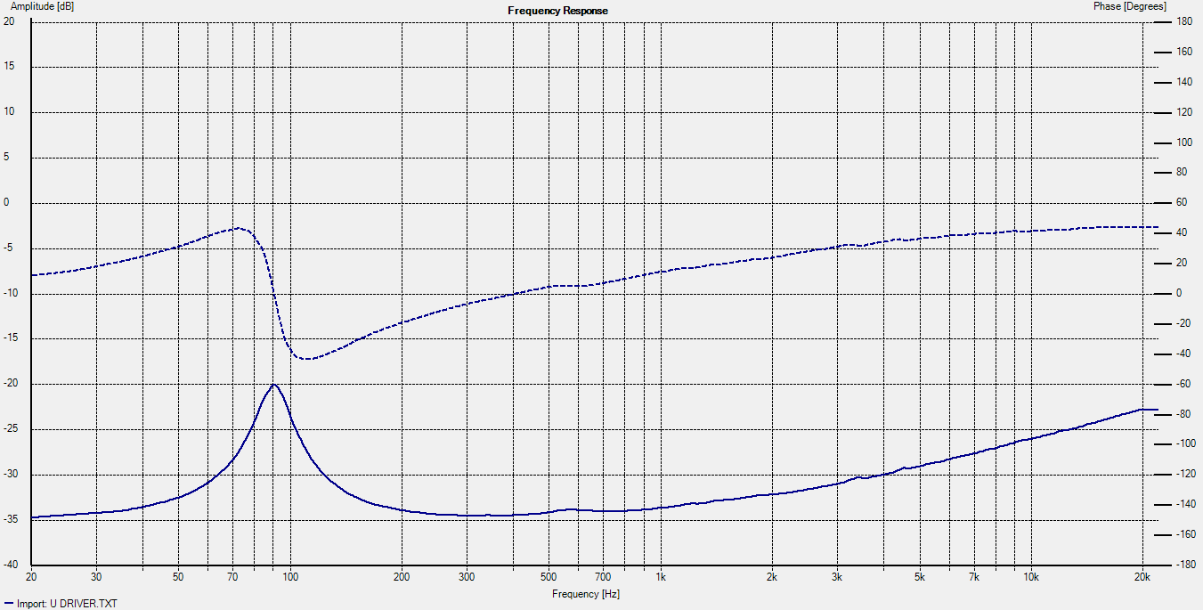

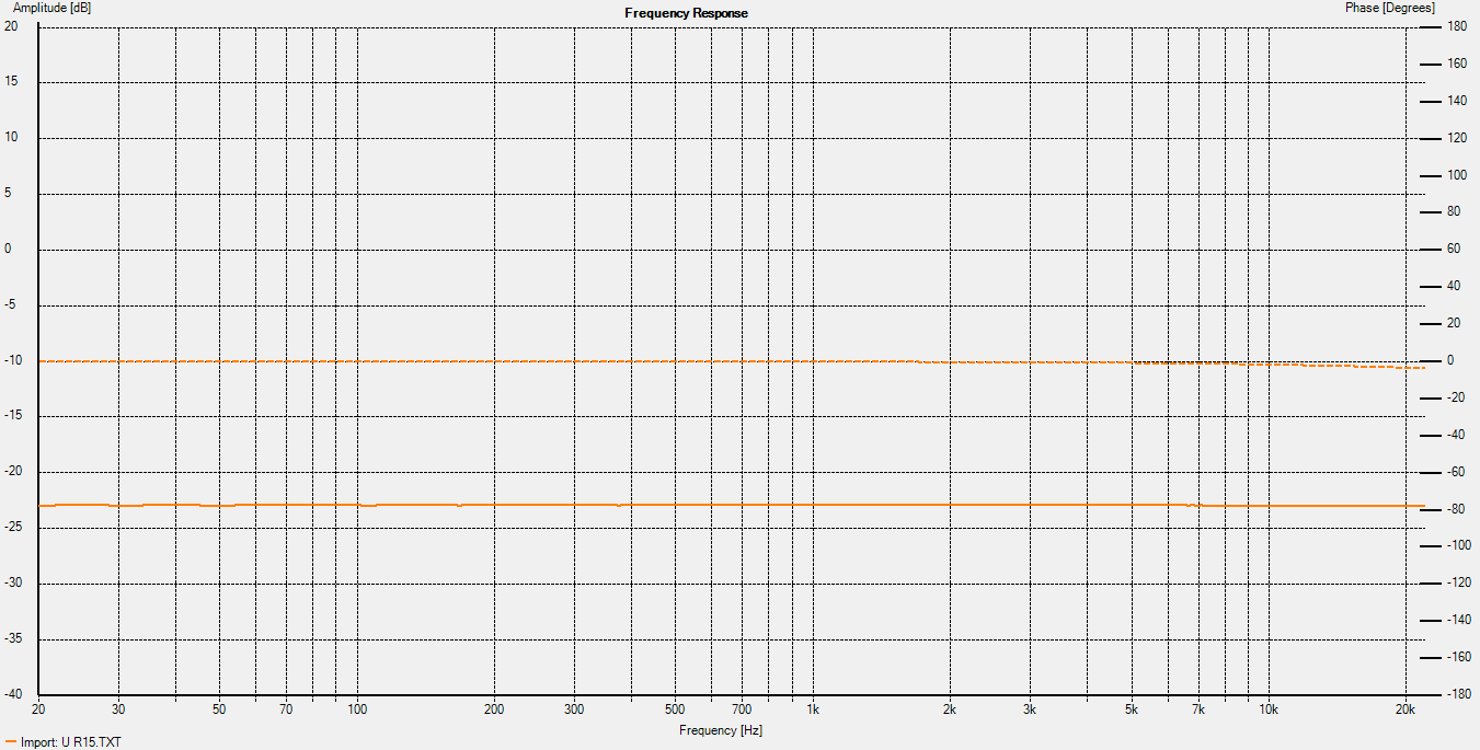

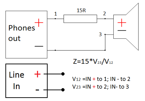

I was playing around and arrived at a solution how you could achieve that. Basically you connect a circuit like it is drawn and measure voltage drops across resistor and driver. These 2 plots will have to be manipulated by introducing a division of these two responses, driver voltage drop being in the nominator part of the fraction. HolmImpulse calls it C=A/B. Once you are done with that, remains to multyply the result by 15, and that means you would have to increase the resulting response by +23.52 dB. This comes from:
spl=20*log(15)=23.52dB
Now this resulting response is your impedance in dB, and in order to appear in ohm is needed this:
Z(ohm)=10^(Z/20); Z being you end result of measured impedance in dB.

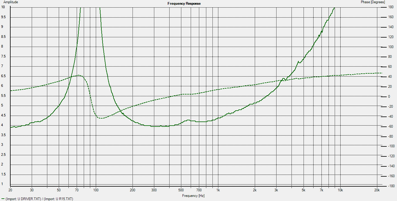

Funny though, HolmImpulse can switch the amplitude scale from dB to linear scale and that is actually your Z in ohms. Still, the exported file will be in dB, so it needs a little work on the file to appear in ohms.

0 dB in the plots equals 1Vrms.

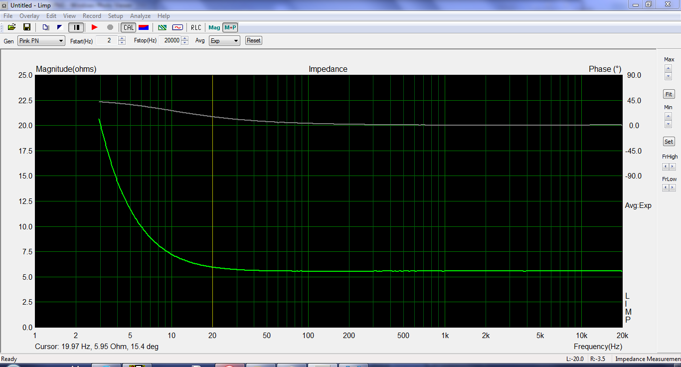

In any case, shortly after my OP, I ended up using ARTA/LIMP and the recommended jig for my impedance-measuring needs.
I also used LIMP out of my UCA222, with fairly good results. I remember noticing a bit of interference from the UCA's capacitance, but that was low enough in frequency so as not too affect the drivers I measured. It might be another story if measuring very low-Fs drivers.
