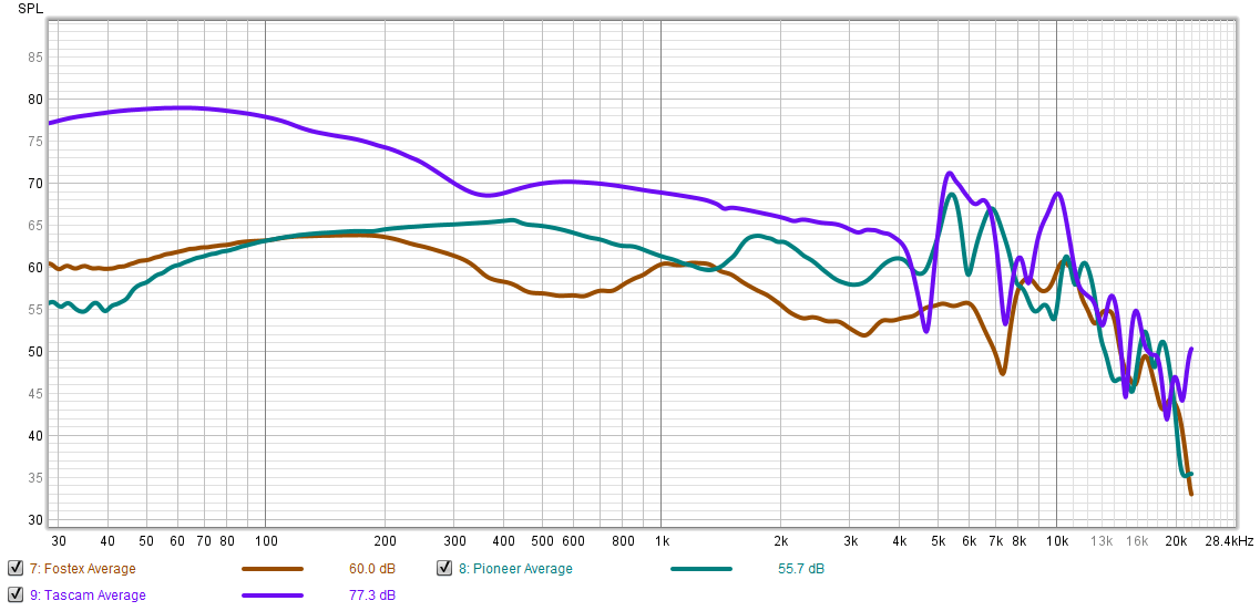

So i received a free set of headphones with a parcel today. On the back I noticed its frequency response spec on the back (20-10kHz) So I thought i'd try to see if i could test and confirm those specs, which i could. Though I was a little bit surprised with what I found.
Maxell MHP-EP02 (in ear) (10kHz spec, 13 to 10kHz measured)
Sennheiser HD429 (over ear) (22kHz spec, 9kHz measured)
Sennheiser CX 3.00 (in ear) (21kHz spec, 16kHz measured)
Thoughts?
- First, it turned out that I had the wrong settings on my computer which limited the output to 23kHz, so that was rectified.
- It turns out that even if its frequency response was only up to 10kHz, I could still measure output up to 40kHz.
- Understanding that the 10kHz earphone spec is where output volume begins to drops, not where it fades to zero. (Measured as 13.3kHz first try and dropped to 10kHz on subsequent tests)
- After testing the over ear sennheisers a few more times, it seems i'm getting drop outs. I wonder if doing these tests is damaging my DAC, headphones and/or mic....?
- So it may still be possible that I haven't lost my precious young high frequency hearing just yet? And perhaps maybe it's just the limit of my old headphones or is the limit of my old DAC?
The physical setup is pretty simple. I just attached a microphone against the headphone driver (in such a way that it's direct and secure, sometimes using sticky tape when needed). I tried to make sure that the cables were separated to avoid any potential cross-talk.I've no idea how to properly test headphone FR. Also no idea how you ran the tests above - physical setup - so commenting is difficult.
I then used a high quality sine wave sweep (1Hz to 96kHz) downloaded from here: https://www.audiocheck.net/testtones_highdefinitionaudio.php
I then used Audacity to record the headphone output from the microphone. From there you can view the spectrum information.
Oh I also forgot to mention that my DAC/ADC is a Creative Labs SB1240 and the setup microphone came with my Onkyo AV receiver and is branded Audyssey.

FWIW headphones can be measured without too much trouble. Knowing what that measurement is supposed to look like is not easy.

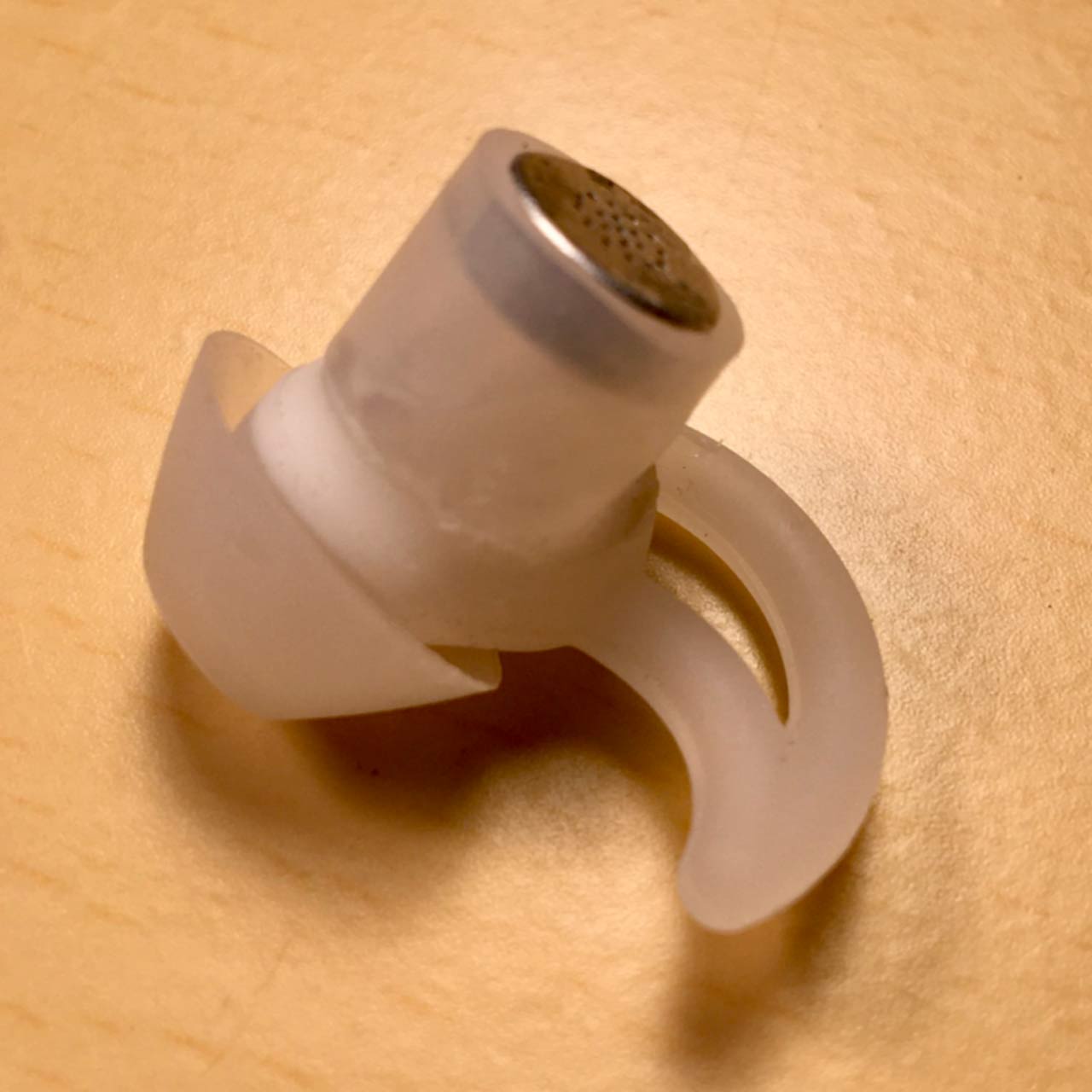

Here is a graph of 3 very different headphones measured with Panasonic capsules in my ears. Yes, the Tascam are that bass heavy. Note that they all roll off above 10 kHz. I know that's not the DAC, amp, preamp, or ADC causing the roll-off, as they all measure flat. It could be the mics, but shouldn't be. Perhaps it's just the ear canal.
At one time I built a headphone measurement rig with a calibrated mic. It was the same width as my head and the headphones could be placed on it.
It looked like this.
I'll see if I can find the measurements made on that. IIRC, all phones had a >10k roll off, but I would need to double check that.
How did you put the capsules in your ears? How did you route the wires? Were they super-thin gauge or something? Flex-print?Panasonic capsules in my ears
Obviously I'm curious how you got that to work.

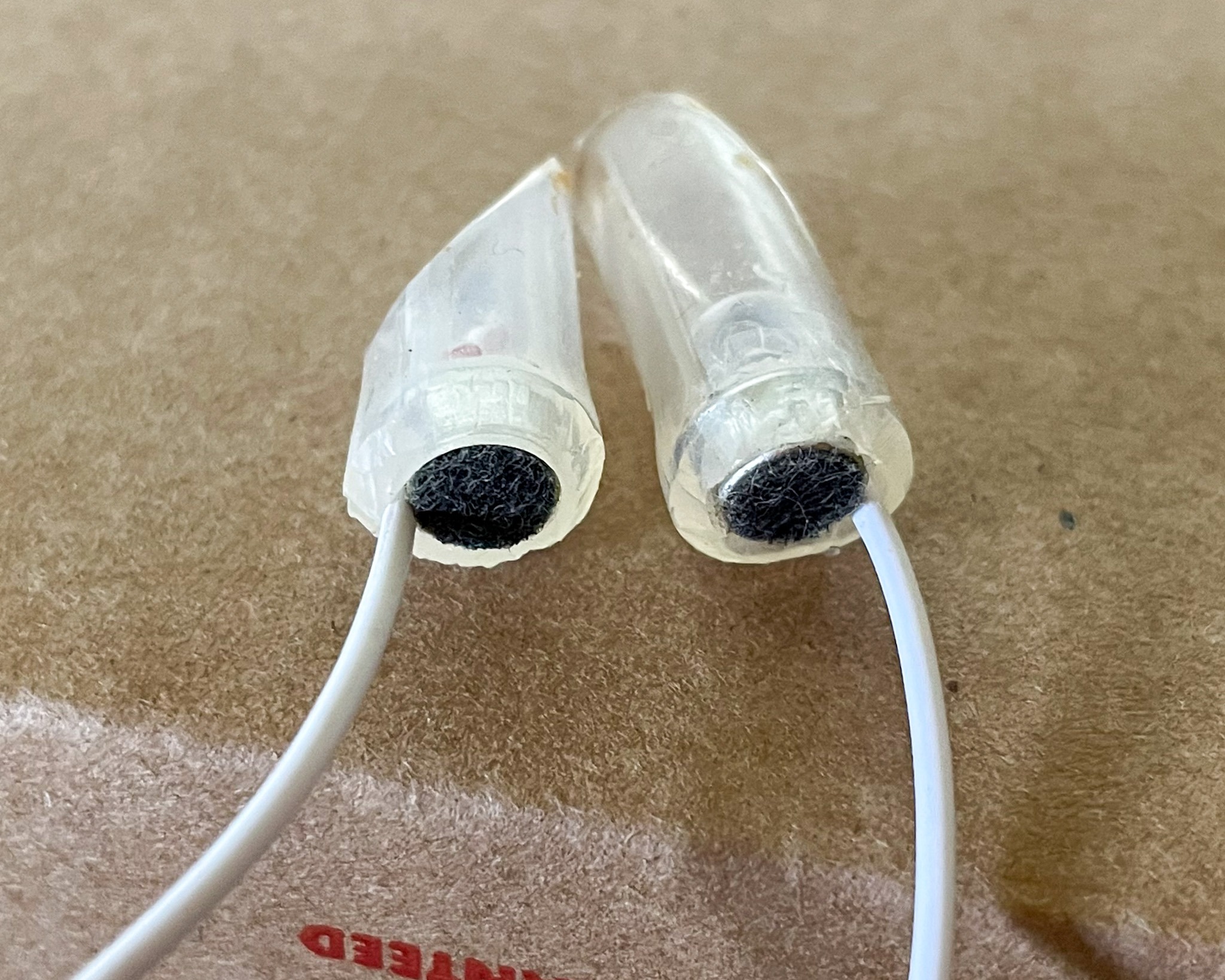

Here they are. A rather crude first try, but they have been working just fine. This is the old Panasonic WM-61 capsule, which are no longer made, but there are other good 6mm capsules for little money. If your ears canals are small, 4mm can be had. These are just inserted into PVC tubing. I have also tried the silicone tubing, which is softer and more comfortable if you can get it.
The second photo is a model I made about 8 pair for nature recording, but ultimately went another direction.

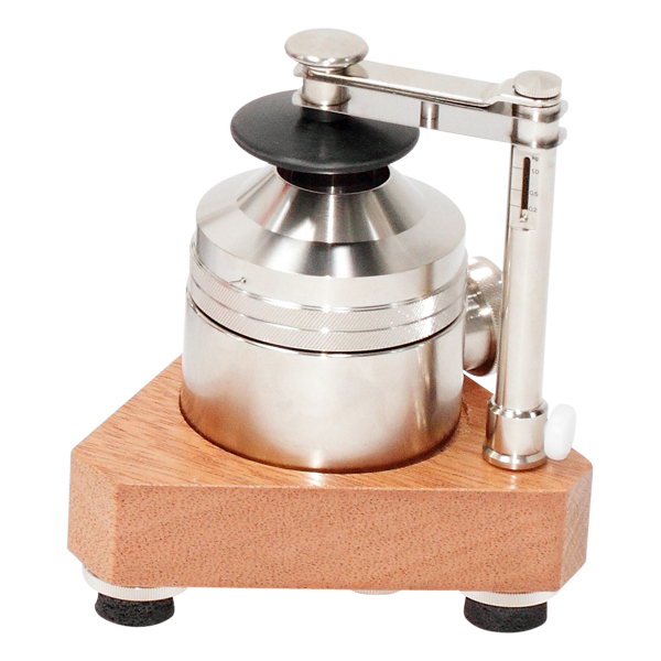

Nice tries, some better than others 🙂 , but THE proper way to do it is with a dedicated "Artificial ear", here´s the golden standard, the Brüel & Kjaer one:
https://www.bksv.com/en/transducers/simulators/ear-mouth-simulators/4152
TYPE 4152 Artificial Ear with 6cc coupler
Admittedly not quite "ear" looking (although Terminator would disagree 😉 ) but it definitely behaves like one.

Awesome, thanks! I have been gluing capsules to a pair of foam ear plugs. They pull / fall out easily, particularly if the wire weighs anything. I can get them to last a full song, if I sit perfectly still. I'll give your idea a try.These are just inserted into PVC tubing
