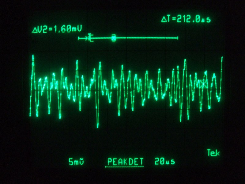

I bought an Audigy 2 Value (SB0400) for measuring ClassD amplifiers, and there is a strange thing: on output I see a high freq noise with quite high amplitude (80 mV). It's spread between 60 and 300 kHz. Is it normal? Would anybody check his/her similar soundcard?

Yesterday I measured on an other card, EMU1212, and it has the same issue, so it's not unique.
I measured it with oscilloscope. FFT is not neccessary, however useful. You can't check the sound card with itself, since there is a low pass filter on input with ~40 kHz corner freq.

No, it was an other PC. It cannot come from the PSU, because it's not periodic at all, and it's present only on the output of sound card. And too strong to be a PSU (or motherboard) noise. And the motherboard noise would be audible, but this isn't.
I heard, some audio cards are using so called 'jack sensing' feature, to determine, what was plugged in - microphone or headphones, etc... Maybe this does produces such a problem? Is this HF signal presented at the card output all the time during PC startup? Is this noise present during playback of some track at low volume level?

No. This problem is due to the nature of sigma-delta converters. All sigma-delta converters has more or less out of band noise, while in band noise is suppressed by a so-called noise shaping. Out of band noise is suppressed by analog filter, but since in this case the pass-band is wide, it can't be filtered out as good as in a low sampling rate DAC. Also the oversampling ratio is lower, what makes the situation worse.
Maybe, but NOT at this level! He is talking about 80mV form a total of 2000mV. That is some 28dB! What DAC has this level of noise?

Unfortunately I can't adjust the sampling rate (nor the filter roll-off, what makes me more sad), but I played a 4...90 kHz sweep before measurement, and it passed, so sampling rate must have been 192 kHz. But the noise is the same (more or less) when I use winamp, with 44,1 kHz MP3. Would be good to be able to adjust DAC manually!

Of course I measured only the soundcard yet.
If I connect this noisy signal to a Class D amp, the noise is sampled by the amplifier and can be transponed to audible band, this is why I mentioned Class D amp.

Done. I didn't take a photo, but the noise is between 60 and 300 kHz.
I would assume that either you have an input directly feeding the output internally,
No external input is enabled for playback. Only wave out is enabled.
or it's just the computer ground plane is not clean.
It would have make an audible noise, but this is not. And 3 of 3 independent PC with the same, incredibly strong GND problem is very unprobable.
Don't guessing, the source of the noise is obvious already, only the quantity (the way to make it less) is questionable.
How does looks 10kHz sinewave from your sound card in oscilloscope? Is it not aliased? If you play 192kHz/24bit file, it does not mean, that soundcard will output it using exactly same format. Usually there is some resampling in digital path, which affects the output strongly... 🙁
